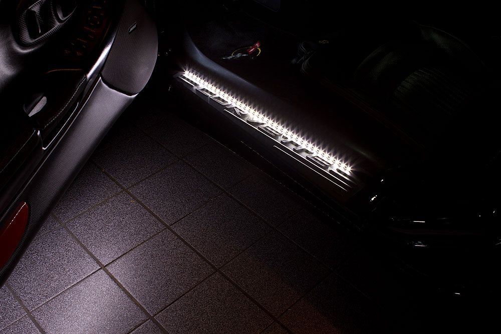

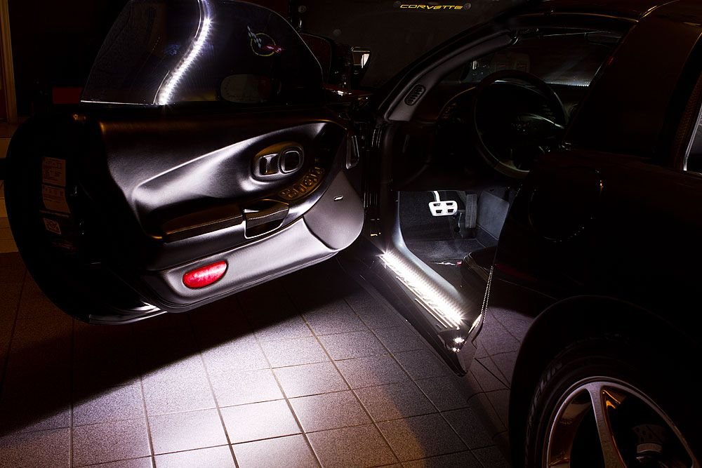

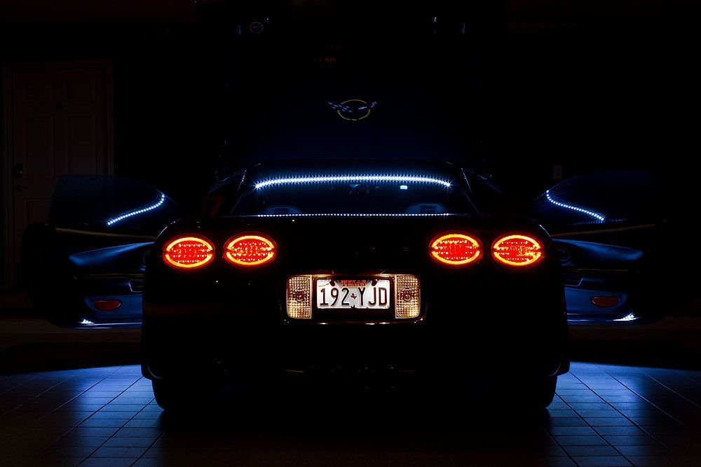

I did not do the "logo" puddle lights, but I did install LED strips under the doors, along the sills and in the footwells and wired the puddle lights through the door accordions as you suggested. Connected everything to the Courtesy lights on either side. They make a big difference since I drive mostly at night...
You may break a nylon mounting pin or two, but I never have (if so easy to replace). I "have" had one of the nylon female receptors strip out of the door fiberglass and have also had one of the door panel areas where the nylon plugs wedge into break off. Also had reflector tabs, door handle bezel tabs and door handle access tabs break off. These things apparently were designed to go on once, but I have had both of mine off about 4 times each - finally learning some tricks, but still delicate.
