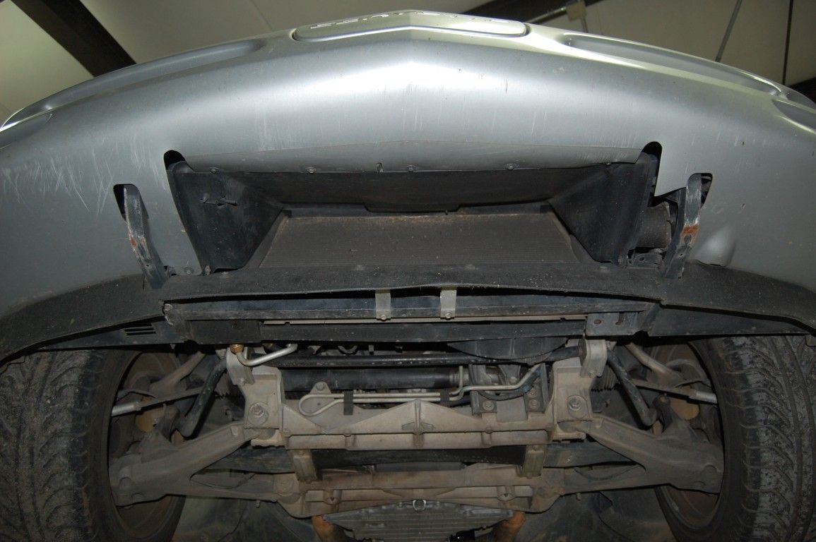

OK, here's the hole for those who don't know the hole. The piece I need goes across the front edge where the mounting holes are.

You are missing the whole piece. Funny your car doesn't overheat. Unless the fans run all the time. I don't know the part description or part number, but I doubt if GM carries them anymore. You might have to check the Corvette salvage sites.

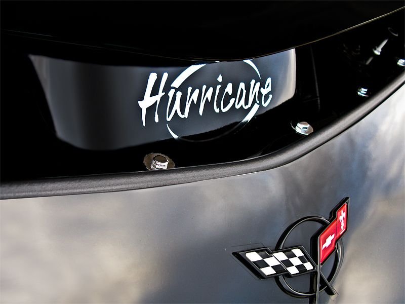

Originally Posted by claysmoker
Thanks! That photo doesn't look like the right piece though. The shape isn't correct. Maybe that's the top side.
That looks like the right part to me (top view). You could always install a Hurricane Intake like I did -it comes with a new custom shroud...
http://www.westcoastcorvette.com/p-3...04-c5-z06.aspx
