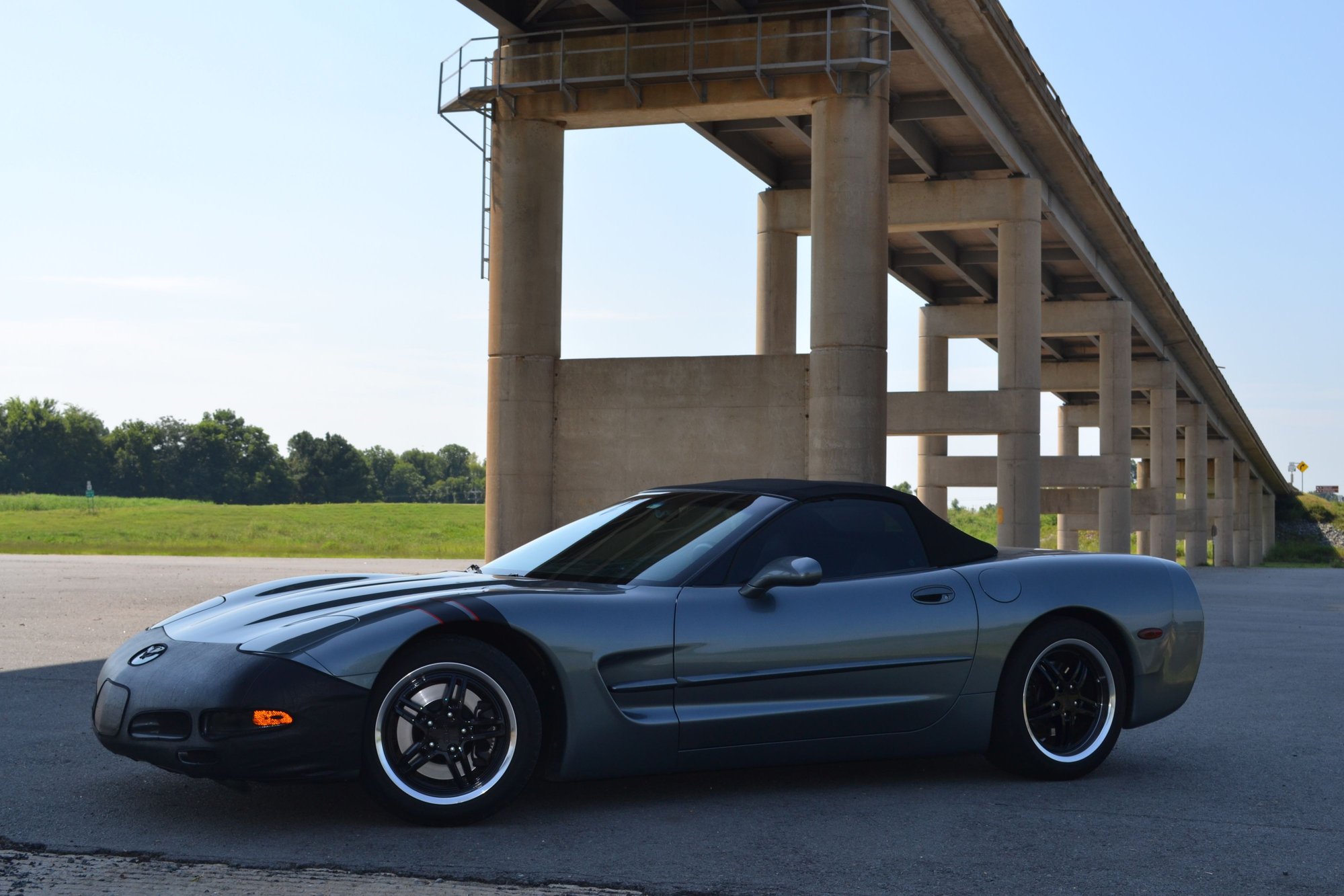

Spiral gray shines up REAL nice!

We love our 04 Rick!
