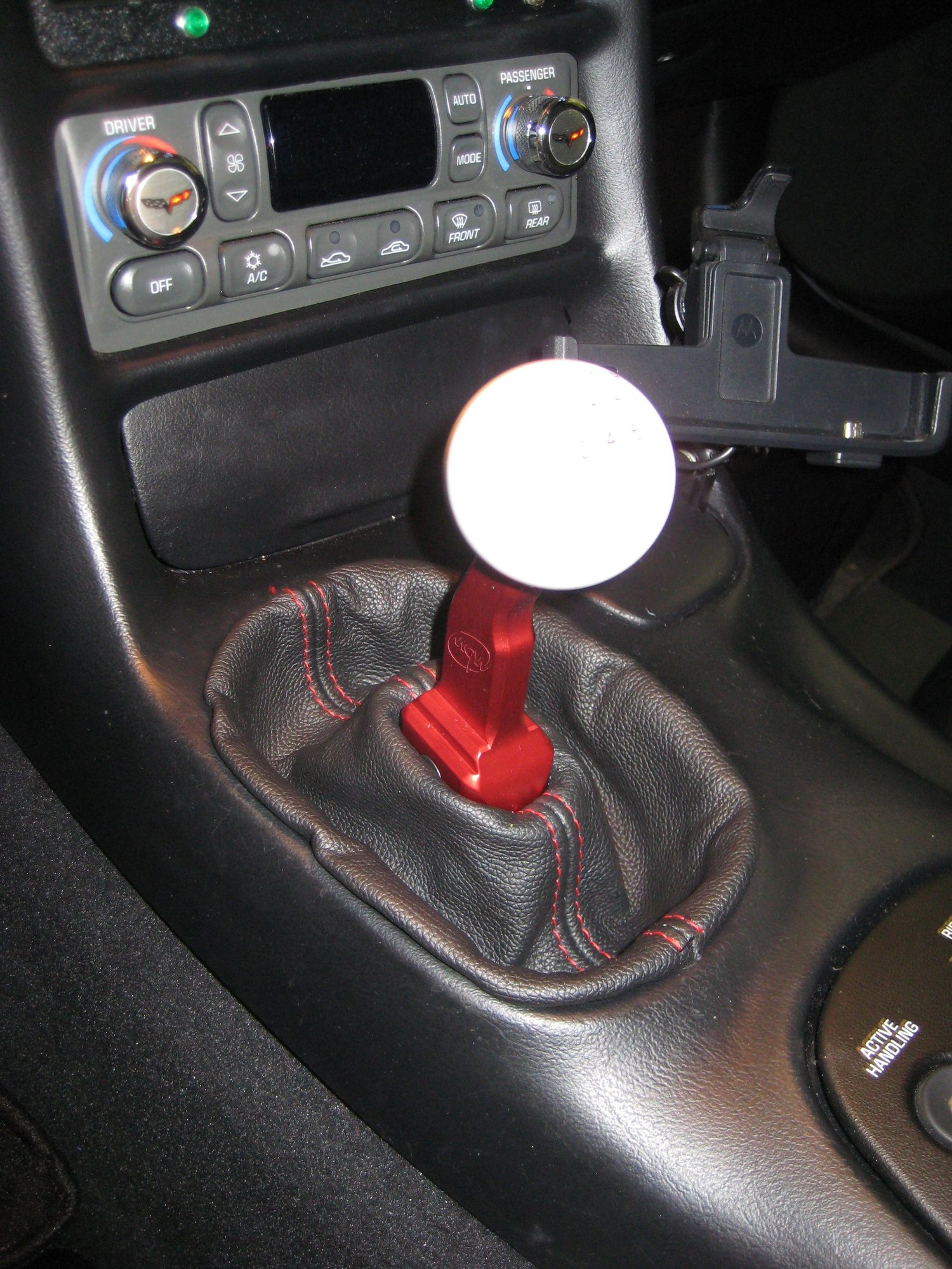

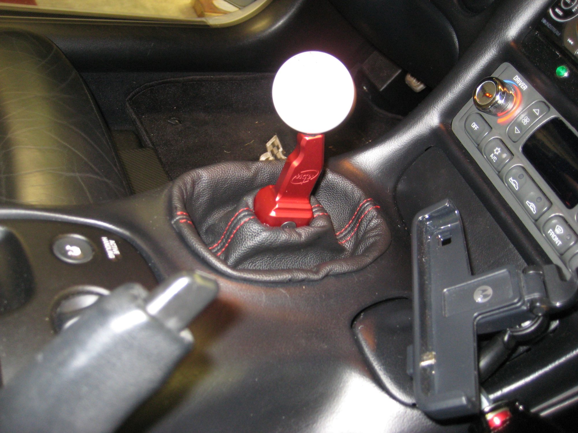

Yes akapounder, I ordered the same one but silver. Am I missing something?
Old Sep 2, 2015 | 07:25 PM
Pounder's Avatar
Pounder
1/4 mile/AutoX
Joined: Jun 2014
Posts: 11,443
Likes: 2,190
From: Buffalo Texas
Don't think so ???? why ????
Old Sep 2, 2015 | 07:37 PM
c5z06.O's Avatar
c5z06.O
Joined: Apr 2014
Posts: 345
Likes: 23
From: los angeles California
Default Just thought i missed something
I did order the flat one. Saw the one you had installed and went for it.
Thanks for the pics.
Old Sep 2, 2015 | 08:02 PM
Pounder's Avatar
Pounder
1/4 mile/AutoX
Joined: Jun 2014
Posts: 11,443
Likes: 2,190
From: Buffalo Texas
like to see pic's of yours when done !!!!!!!

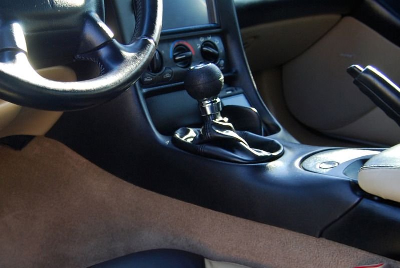

I installed a C6 Z06 2008 shifter and quite pleased with the improvement over the stock shifter. Shorter throw, smoother and not notchey. It is not stiff and shifter shaft is a little shorter which I like. Here are the part #s for the whole kit, control, ****, boot and bolt. I purchased from Bob at Rimrock Chevrolet in MT.
11571034 SL-N-Bolt (04006-CK)
25823572 SL-N-Control (04004-C)
25900711 SL-N-Boot (04015-C)
25945072 SL-N-**** (04006-C)

Yes I love mine. I had a B&M sport shifter before and just did not like the increased shifting effort for everyday street driving.
When I switched to the C6 shifter (box, ****, assembly) I never looked back. It has a slightly shorter throw and is more comfortably angled. The shifter box definitely feels smoother and more precise. The **** has perfect feel to it and looks like it belongs in a C5 interior.
