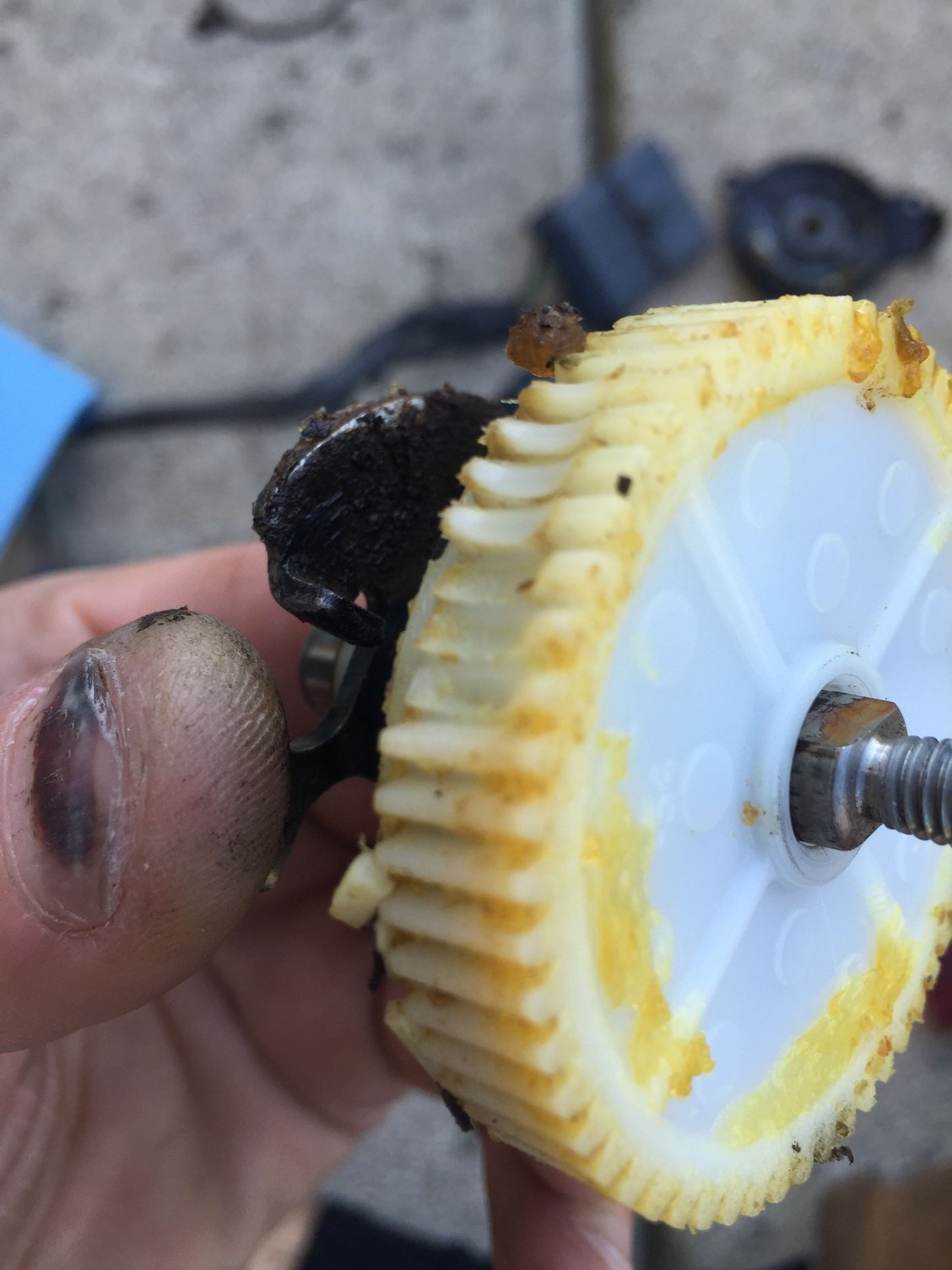

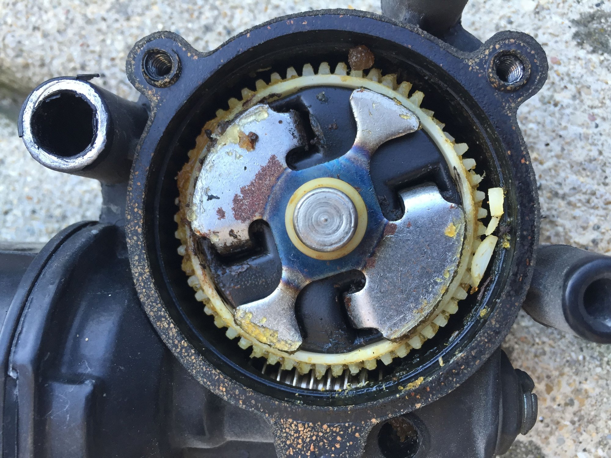

Notice the broken teeth around the inside assembly.
Up close of plastic gear.
Fanciness vs stupid Chevy engineering

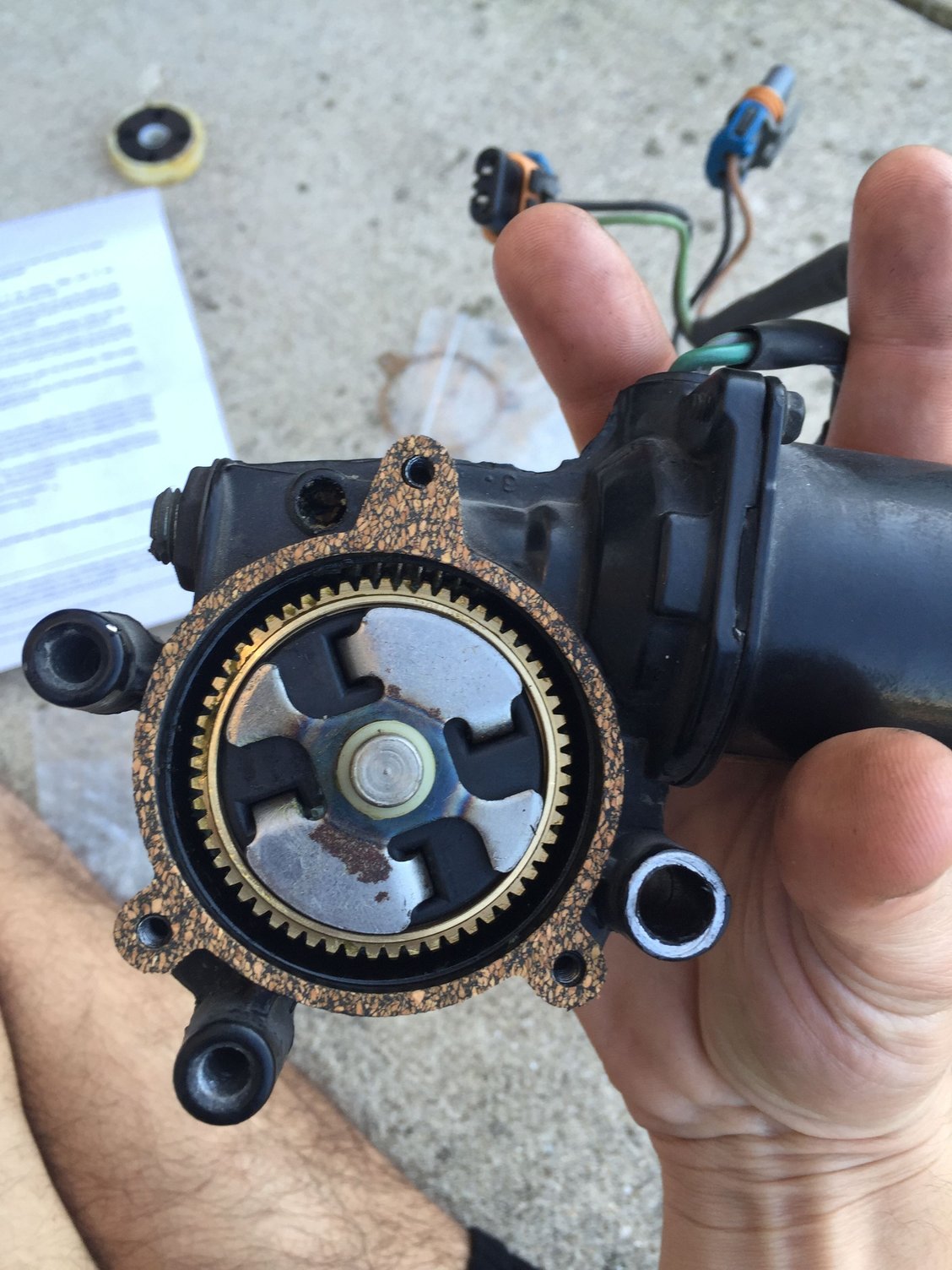

reassembled with new lube and seal.

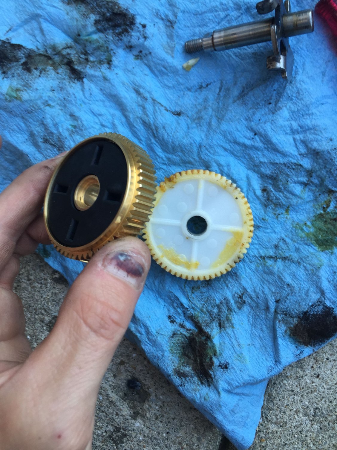

I just swapped my passenger side today. My plastic gear has numerous consecutive teeth cracked off. Check out Rodney Dickman's website for new brass gear replacements. They make a world of difference and only take an hour or so to replace.

The gear will spin inside causing the grinding until it re-catches and stops. It will still go up and down as long as there's enough teeth for the auger piece to catch. As I stated above Rodney Dickman explains everything you'll need to know to purchase the right gear as well as the bump stops. Goodluck!
