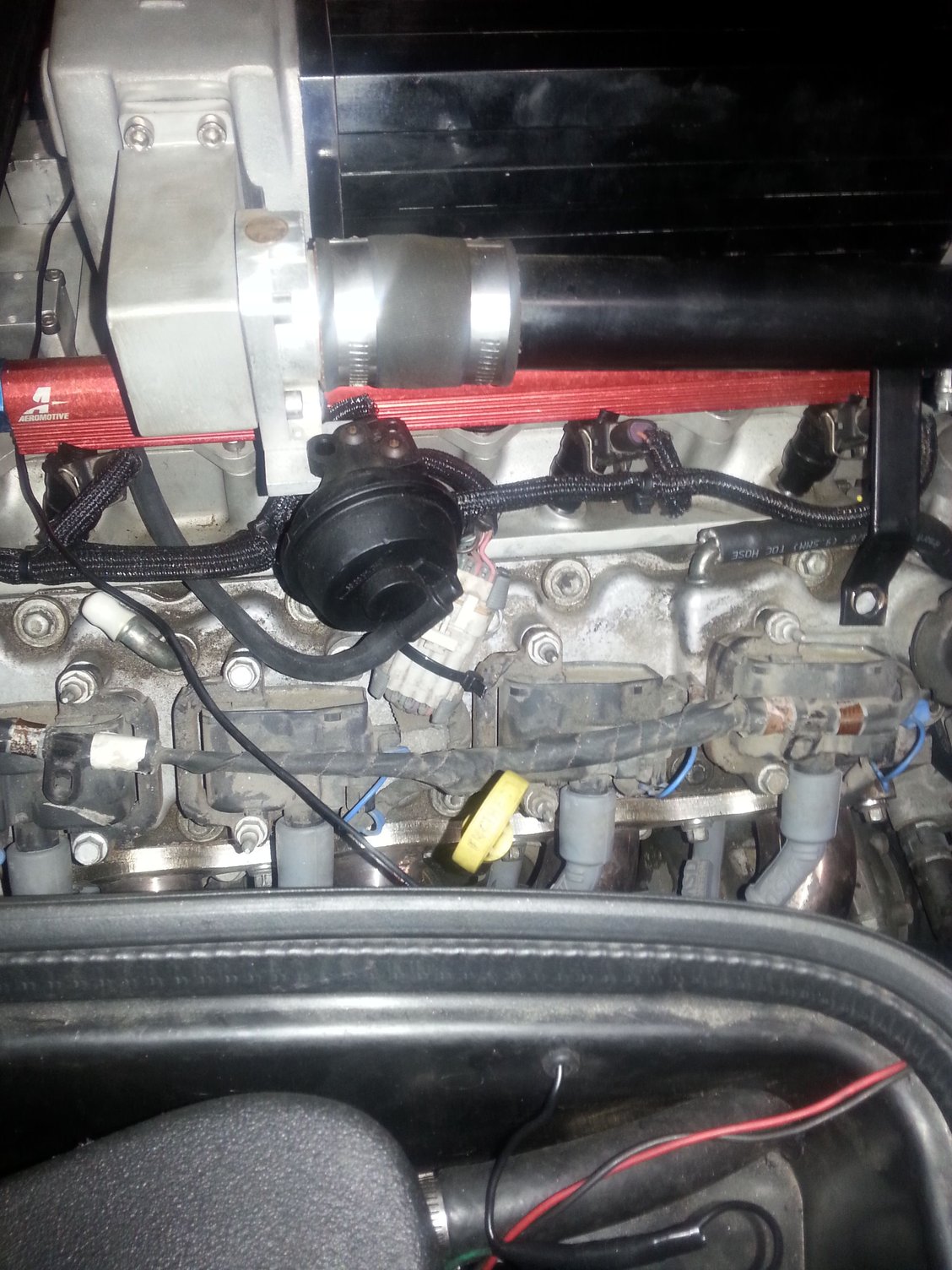

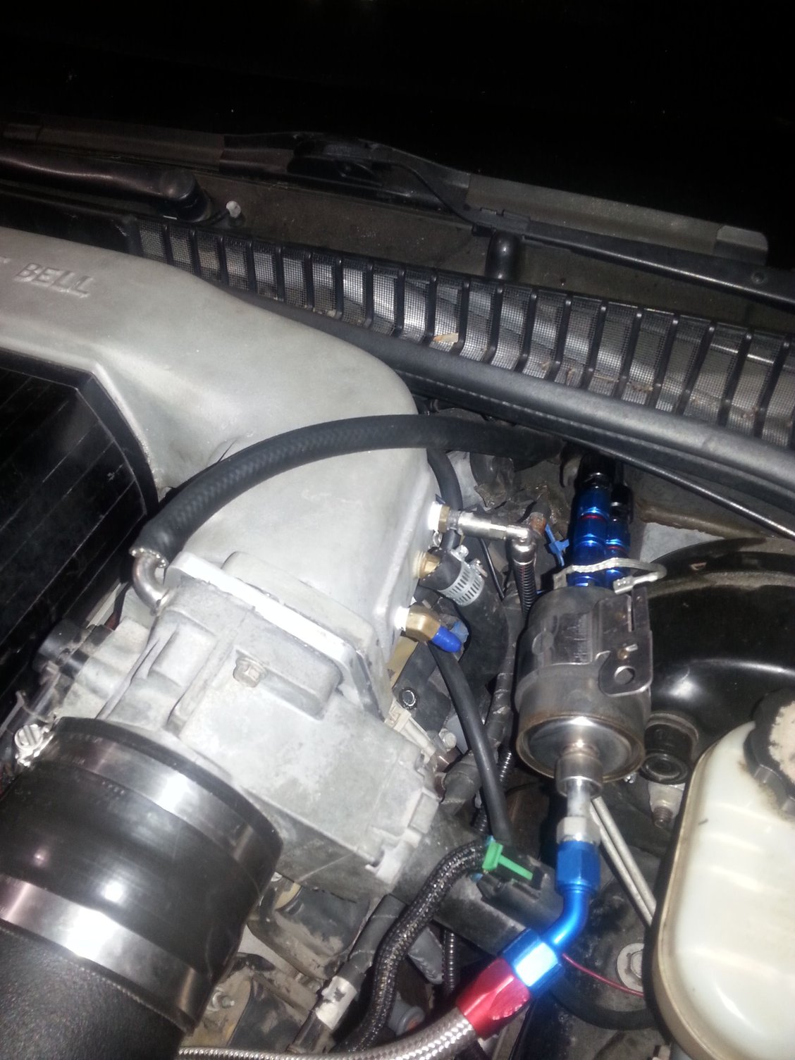

So I'm not positive my setup is done correctly or if I could use some more parts (breathers). I just installed a Kenne Bell Kit, I know it's not the most raved about FI, regardless I put it on a 1998 ls1 so the instructions aren't very helpful. Currently I have my mike norris CC mounted in front of the radiator on the frame, a hose runs from the front passenger valve cover breather to the CC and out the CC to my cold air intake tubing (npt fitting was here already from previous owner). The rear passenger valve cover breather is capped off. The drivers side breather on the rear of the valve cover has a tube that runs to the throttle body in its new location. I will post pictures below, thanks!
