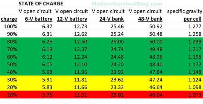

If your battery only measures 12v (with a multimeter directly at the battery posts) it should be completely discharged.
A fully charged battery should be 12.6v or more.
If the battery is
12.5 = 85% charged
12.4 = 65%
12.3 = 50%
12.2 = 35%
12.1 = drained

12V would be about 44% charged, not completely discharged.
