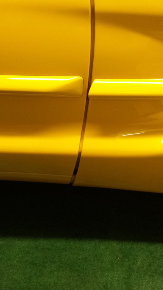

I get it, should've left the 80% out of the comment. Anyway, here is a pic of the pass side

Driver side
Im mostly talking about the gap at the bottom, not so much the gap going all the way up the door. I'm really hoping the car hasn't been in a front end accident. Nothing reported on carfax though

You just posted picture of your passengers side.. you car sustained some damage, Note the top of the front fender sits lower than the top of the door. also , here is the tell tall indicator.. look how low the " front spear " of the side molding on the front fender sits much lower than the line of the door side molding..

One more pic of the pass side.
Any suggestions on why it's like this? Or am I being too **** about body alignment?
I've noticed these things. So you think the car has had some sort of front end impact? Also, do you think this is something a body shop can fix?

I hope you can see that the front fender sits about .200 ( 200 thousands ) lower than it should.
this picture shows the top of the fender, the side molding alignment and also the lower part of the front fender.
You may also see some differences in the skin surfaces, and the variances of depth seen through the gap and door the door jam depths. the lower rocker sits differently than the door jam... the rocker sits shallow behind the door skin... the rest of the door jam sits deeper by various depths. This gives an illusion of inconsistent depth.

I forgot to mention the pass side rocker panel has a pretty bad scrap underneath towards the brake duct. It was there when I bought the car. It looks like someone cut a curb too sharp in a parking lot and put a really nice scuff on it. Maybe thats the reason for the fitment issue?

IM trying to help you here, not put your car down... its not that bad, but its not factory compliant.. Most people would never notice this unless you pointed it out.. If you can get use to it, most would never notice it, if it bothers you, a realignment of the fender ( bringing it up ) Its not the door...the door can not go any lower.
