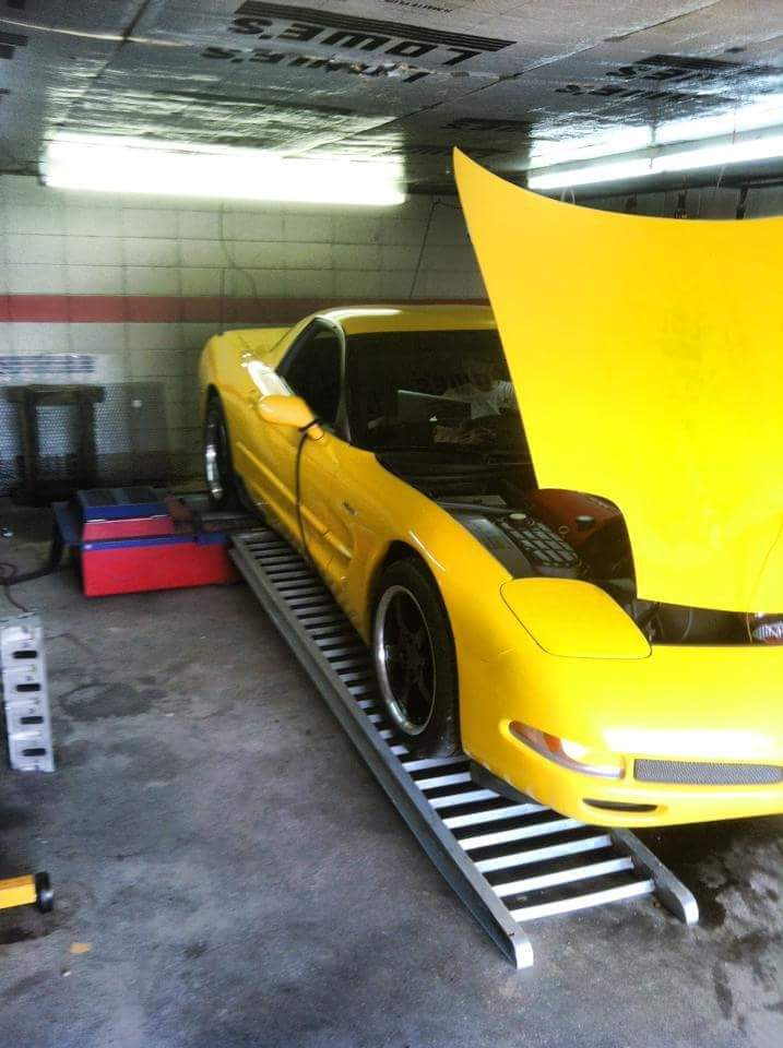

First off my car runs great and pulls hard so Im not really concerned with these numbers, just wondering if anyone has had a similar experience. My car is an 03z with shorty headers catted x and stock ti axle back. Also have a Vararam cai. My baseline run made 299hp and final pull was 321hp I believe. I know our cars make about 360rwhp bone stock so I was curious if anyone has had a similar experience. The tune was done by a reputable tuner who is notorious for having a very stingy dyno that produces very low numbers. I dont know what kind of dyno it is but I know it isnt a dynojet. Here is a pic of the dyno. Anyone with a similar experience?

I'm pretty sure it's the dyno but I don't have any experience with other dynos. The tuner told me before we started that his dyno produced low numbers, I'm not sure why but maybe someone that knows alot about different dyno's can chime in on that.

looks like a mustang dyno..

I'm pretty sure it's not. He specializes is LS motors. I'm pretty sure I remember him saying it's a Dyno Dynamics dyno.
Could be, they read similar to mustangs. Don't to bent out of shape on the numbers dyno is just a tool

Also you wont net much HP with shorty headers, but low baseline definitely dyno.

Yeah ai know the numbers are definately low but I just wonder how much exactly of that is the dyno itself. There is a fairly local shop that has a dyno jet I believe. I will probably try to go there a make a few pulls just to see and make sure there aren't any issues with my car.
