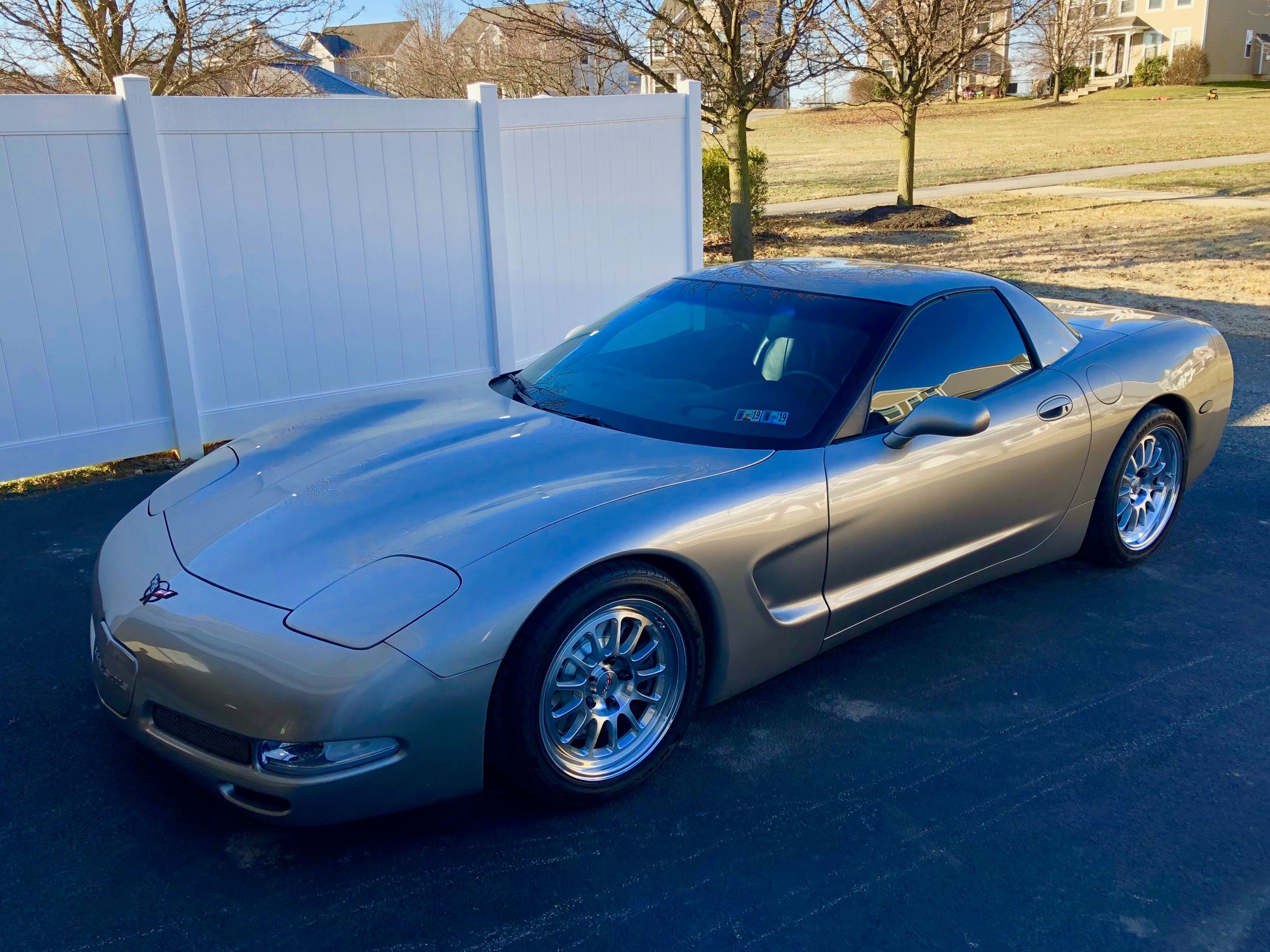

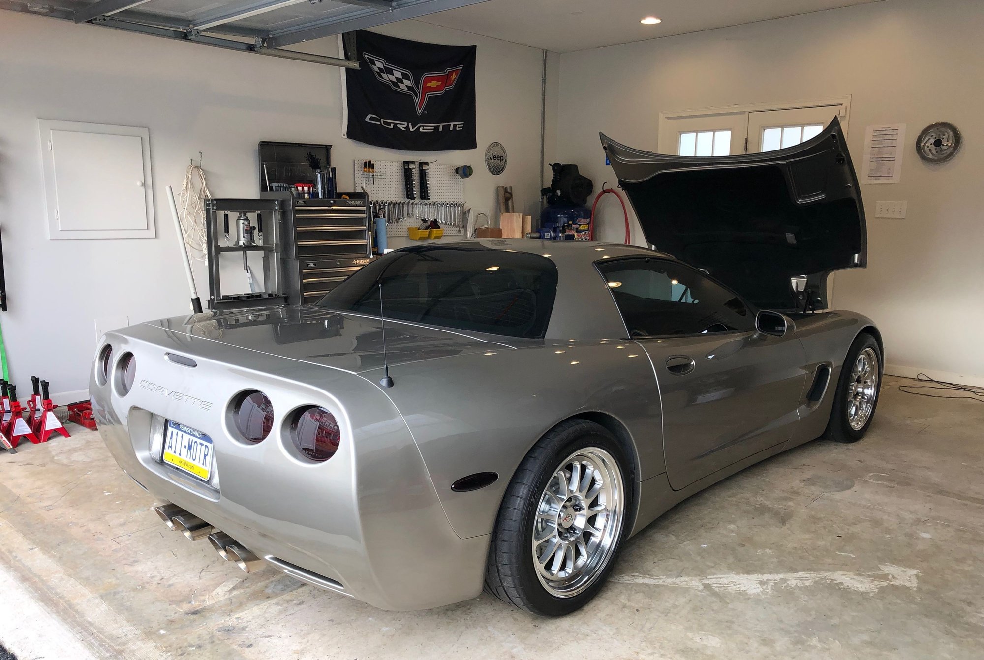

No front bolts. You might hear a slight creaking noise when turning at low speed but no structural issues. Get an alignment tho asap

I went with extended bolts in the rear and cut pads in the front. Probably not as low as you want, but certainly low enough for me. I have approximately 1-1/4" of wheel gap, 3/4" rake front to rear. I didn't want to compromise handling quality with going crazy low on shocks/springs and wasn't ready to drop the coin on coilovers. I did install Bilstein Sport shocks which made a huge positive difference in ride quality/handling. Especially with being about 2.5" lower then stock.
I also recommend investing in elite engineering rocker guards and front fang wheels/guards. A little added insurance if you're gonna be so low. That's what I did. Thankfully, I haven't exercised either guard yet.
JETZ/Frank, your car is SOO low. I love it....but my butt would pucker every time I drove over a crack in the road, let alone normal road obstacles. Cheers to you for your bravery
