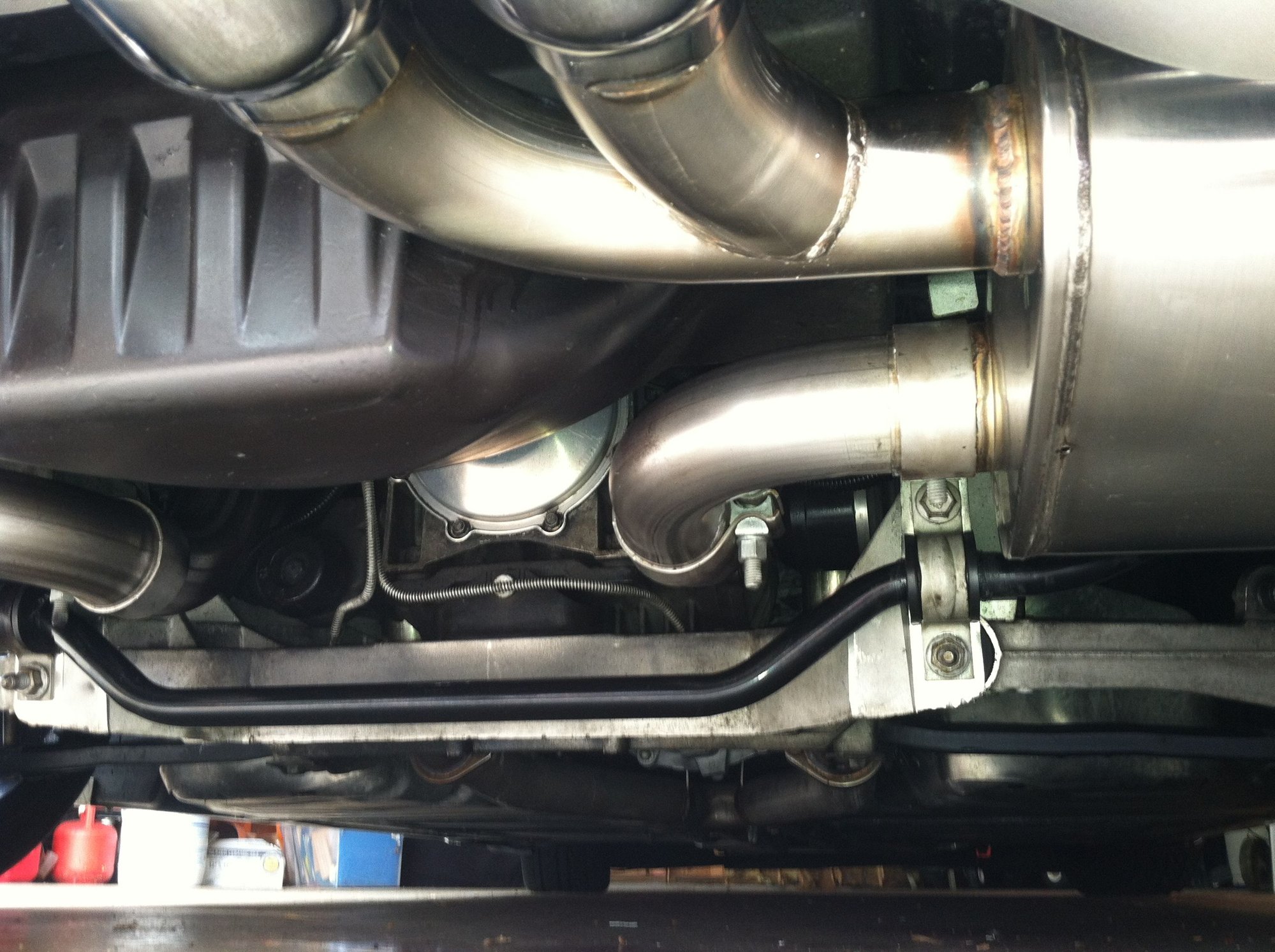

yep I do have the xtremes and I will never change them... on a stock car they will not be loud at all in my opinion, you will actually be able to hear the car for once but they really don't open up until you go wide open... they will produce a motorboat sound at idle with the rest of the exhaust stock but this is due to the h-pipe... if you upgrade to headers later with an x-pipe it will get rid of that sound... after headers is when they really start to get loud, especially if you have no cats but they still shouldn't drone and the cabin noise is kept down really good with their systems... most of the noise is on the outside of the car... if you go further and add a cam or even a blower it's just going to get better and better in my opinion
I have the same in mine with a Magna flo X -pipe. They will sound like a motor boat at idle without an X pipe.

if you plan on doing longtubes in the future I would not spend the money on an x-pipe right now because nearly all longtube setups for these cars have an x-pipe incorporated into their system so essentially you will be wasting money... they will be louder than the stock exhaust for sure but they are not teeth rattling loud like the name suggests unless you do some engine mods like longtubes, that will really wake them up especially if you don't run cats... bimmervet, the pic you posted aren't xtremes... the xtremes are really just a straight pipe out the rear and it does not flow directly through the muffler, there is a small pipe off to the side that connects the exhaust pipe to the muffler and this mainly cancels out drone... this was one of the selling points to me, the less restriction you have then the more air you are able to get out which means you can make more power
