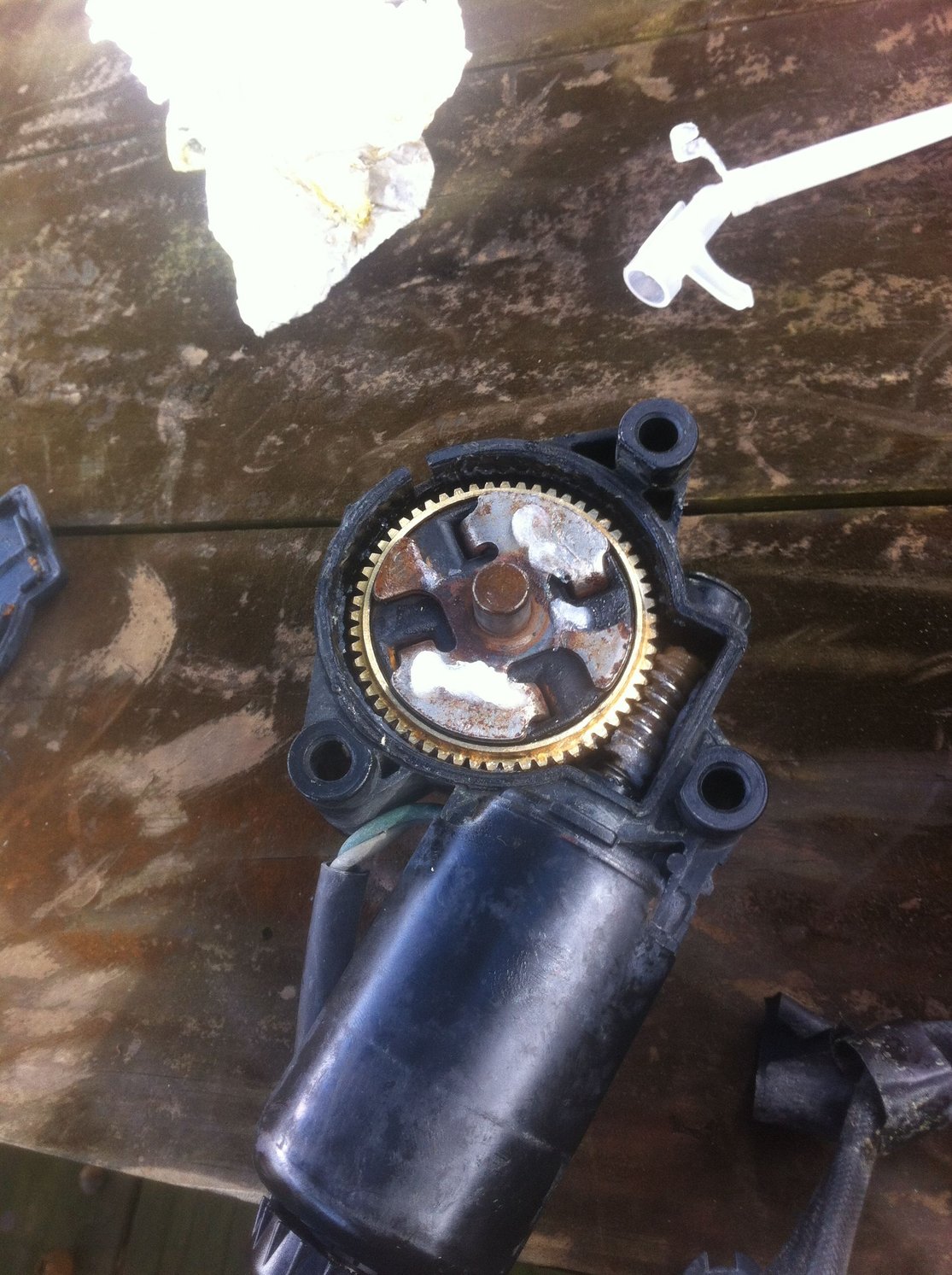

Replaced plastic gears in headlight motors with brass today. Easy job! Followed this youtube video.
Used this part off Ebay.
http://www.ebay.com/itm/Corvette-C5-...hV8Cw5&vxp=mtr
Headlights flippy good now!

good job on the fix one thing i have heard from a lot of people with the brass gears if the headlight gets bound up for what ever reason then it will cause the plastic gear it rotates against to damage or strip one of the biggest reason i went with plastic gears again
You got me thinking here... The plastic gear that breaks and gets replaced by a brass one, engages a metal worm... At least in mine is not plastic:

Yep, worm is metal.
