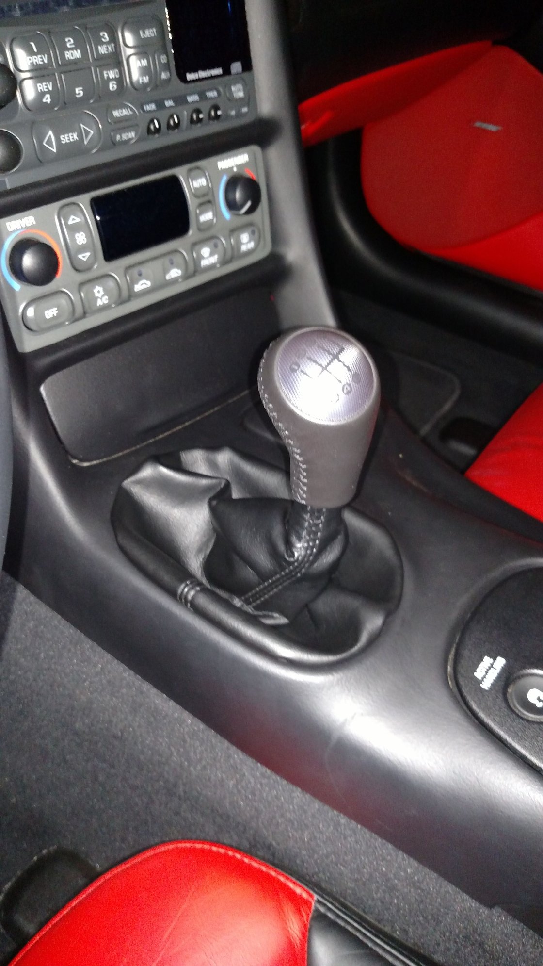

Originally Posted by Nyt_Muves
I would love a c6 **** but I have the shaft for the C5 ****.
I have a C6 **** that's threaded for C5 applications. 9/16" I believe. Twists on.
Matches the interior perfectly, even though it looks much lighter in the picture. Typical cell phone camera.
