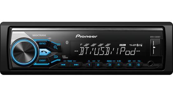

Radio: I was going to wire in an aux port, but then I looked at single din units on crutchfield. All of my music is on my phone, I don't need a cd player. Turns out the entire kit for my car was only $131, so I pulled the trigger on it. Should be here Monday.

Waiting to re-install center console until after the radio comes on Monday.

Radio is loosely installed to test the wiring. Need to secure the wires, connect antenna and mic, then re-install interior.
