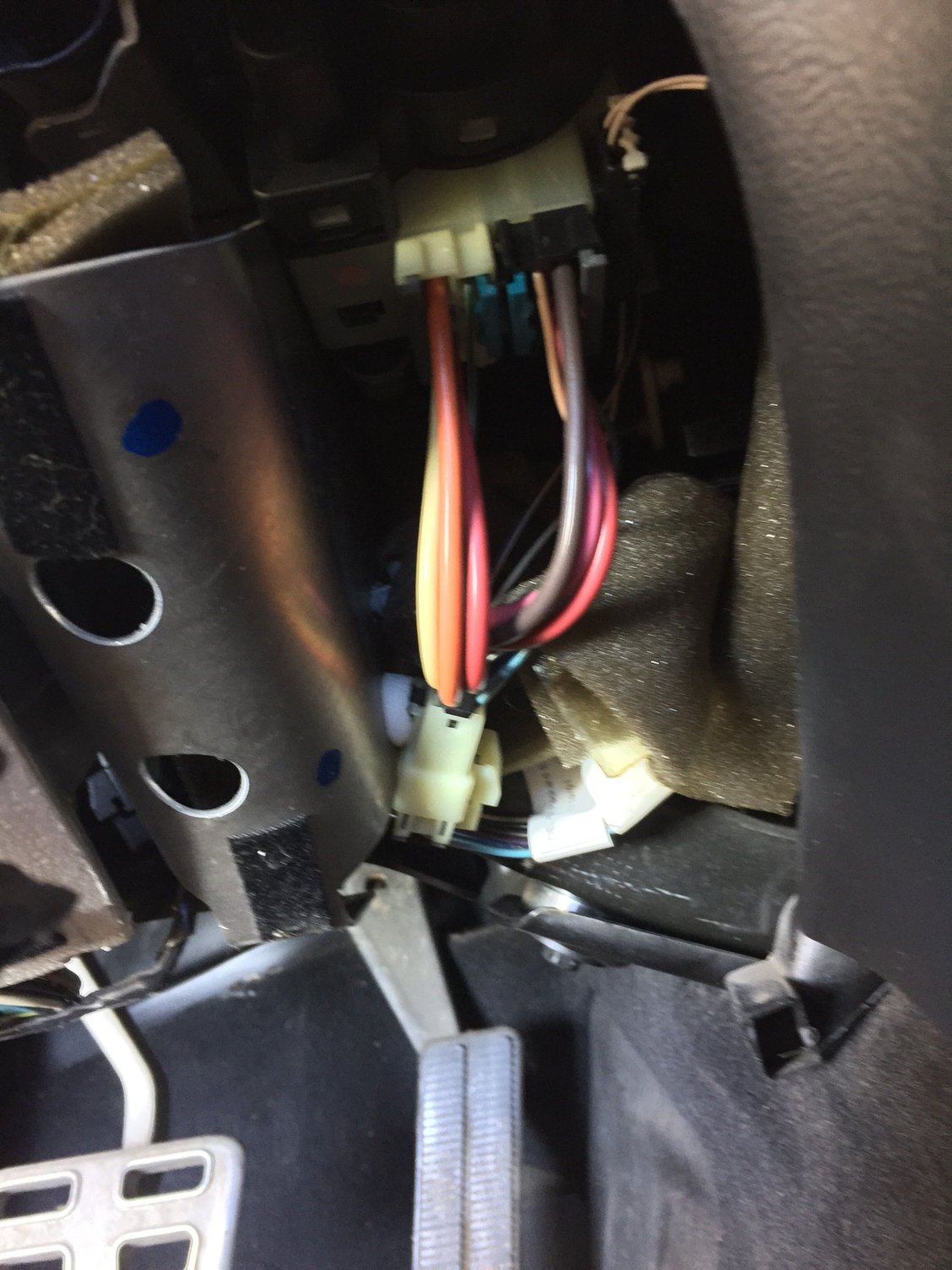

Had some stuff come up yesterday so I'm starting back on the Hyperflash harness, I have the knee pad off from under the steering wheel. Just need to know which connector to unplug, the instructions aren't helping me much lol <br >
If I remember correctly, you remove the connector from the larger clear housing up top. Plug that into the base of the hyperflash harness, then complete the "splice" by plugging the other end of the hh into the top housing.
Edit: shows how much I know. You unplug the bottom connector. http://https://www.corvetteforum.com...y-kamil-d.html
Thankfully, you only need to do this once.
The edit is correct!!! Just finished mine!
Yes it was the bottom connector and that fixed it! Now to see if I can get this knee pad back in
