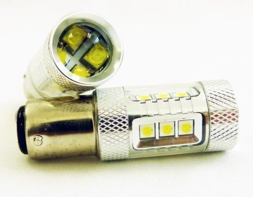

For backup bulbs try these. Big difference and the price is right!
Genssi 2x 80W CREE White 1157
