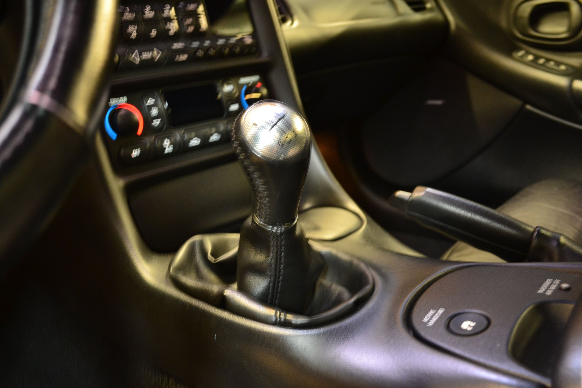

Just a suggestion to prevent this in the future - I drilled and tapped a hole in the front base of an aftermarket **** that is very similar to the C6 **** pictured above and used a dog-point set screw to lock it into place. You can use a set screw with a nylon dog if you're concerned about bunging the shaft threads up.
