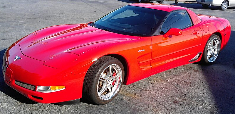

PLEASE, TELL ME IT IS NOT SO!
Your Corvette before the rain!
Your Corvette after the rain
ANY QUESTIONS???

would love to see more photos of this. would like to see the engine bay and the transaxle etc.
