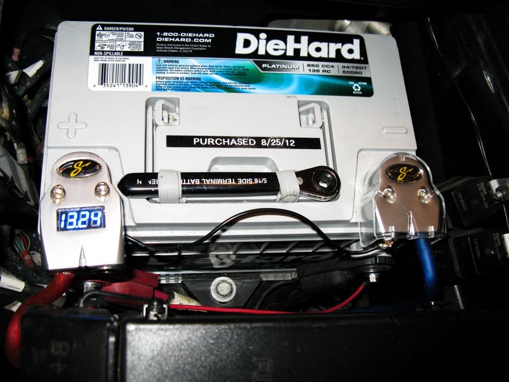

The battery you bought should be fine.
I am using a Sears DieHard Platinum in mine - its been in there for almost six years with no problems. I do keep it on a Battery Tender Plus since I do not drive the car very much.
Diehard Platinum with 135 RC also.Watch the Optima since production moved to Mexico a few years ago and quality slipped.You would think if a company moved to a low wage country ,they would pass some savings to the customers.
I also use a Sears DieHard Platinum..the original died after just under three years and they replaced it for $1.50. I'm a fan, again of Sears.
