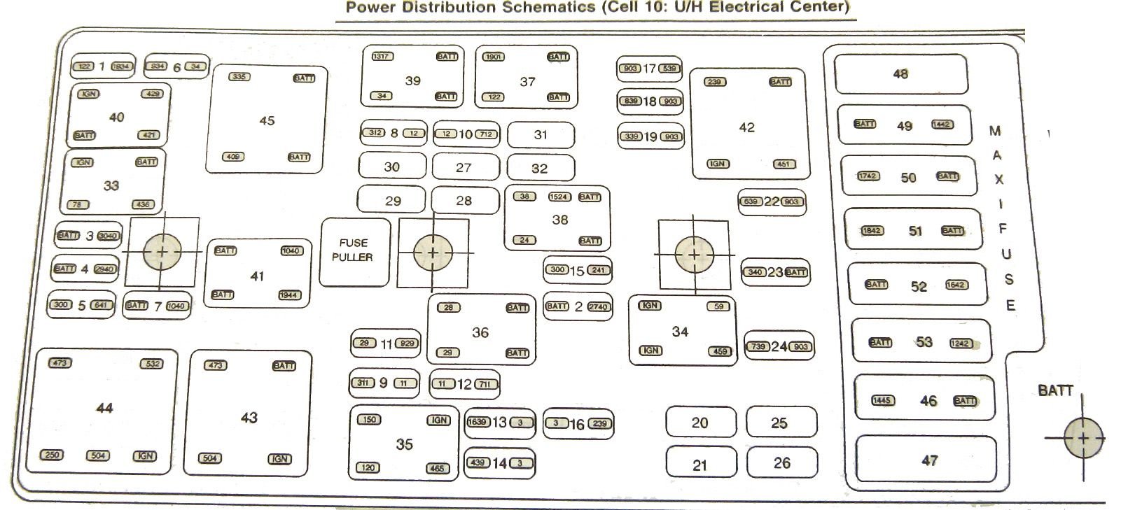

Looking for fuse 22 to use as a switched 12v source for a wideband install. Everyone says it's not used. I've found 2 diagrams both have a fuse in the spot it says should be it. Which one is it and can I remove it?

Why are you looking for 22?

what year is your corvette. mine is a 99 and the #22 fuse supplies 12v to the bcm. I have a 2004 manual and the #22 fuse is not used. hope this helps. Steve

Wideband install. Was going to use 22 for the switched 12v.
Mine is a 99 as well. Thank you.

So 33 is the micro relay for the air pump. Since we removed the air pump can I just use this slot for a 12v switched power supply?

I just did the double din mod and switched power came from #22 in the passenger footwell.
