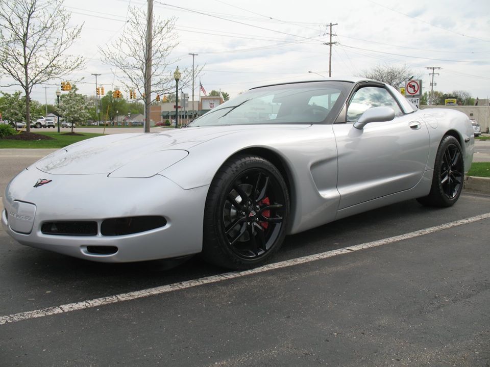

If you like that style wheel, you might want to look into a set of reproduction C7 Z51 wheels that have the proper C5 offset and are in the 17/18 diameter if you don't want to have to buy new tires.

I have the Black reproduction's (ordered chrome, long story) Welcome to the C 5 forum and congrats on your buy !!!!
