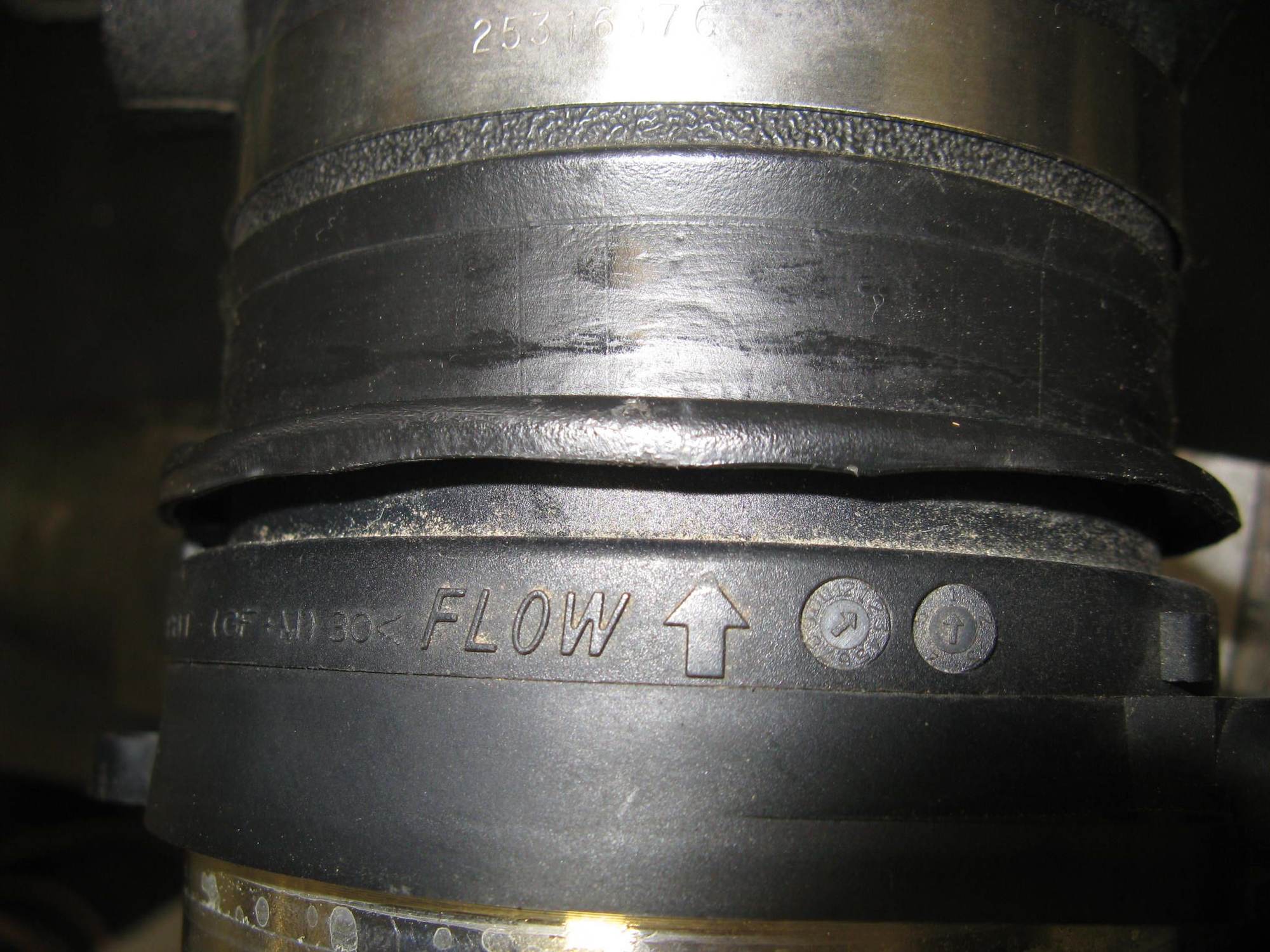

Does this have to be removed and how does the two white clips come off to remove the hose?

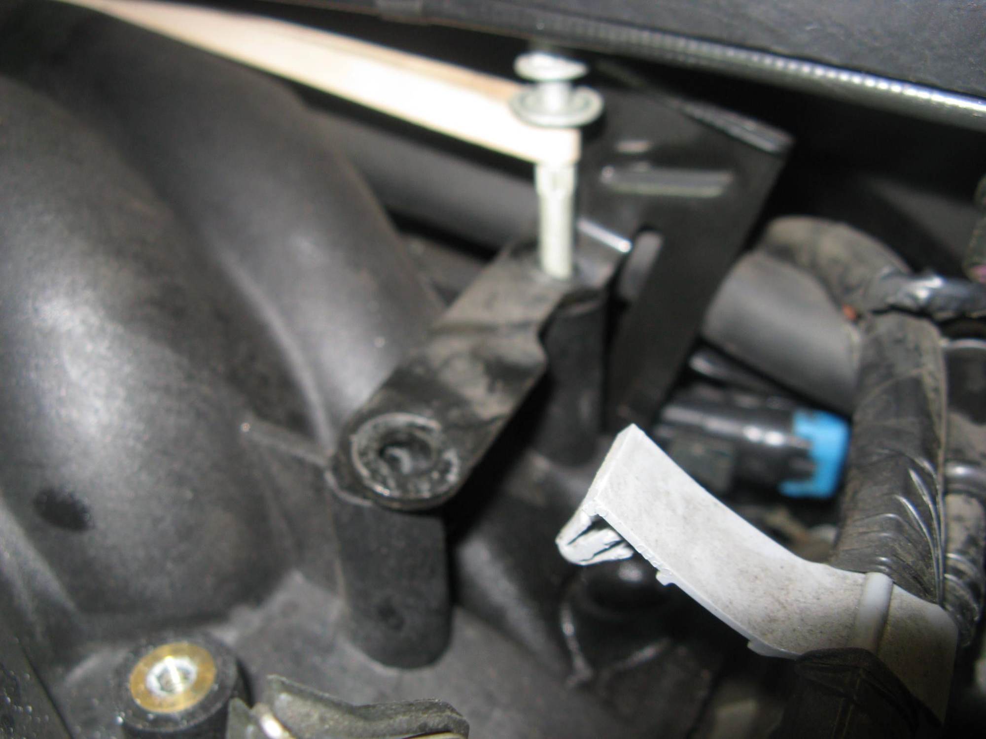

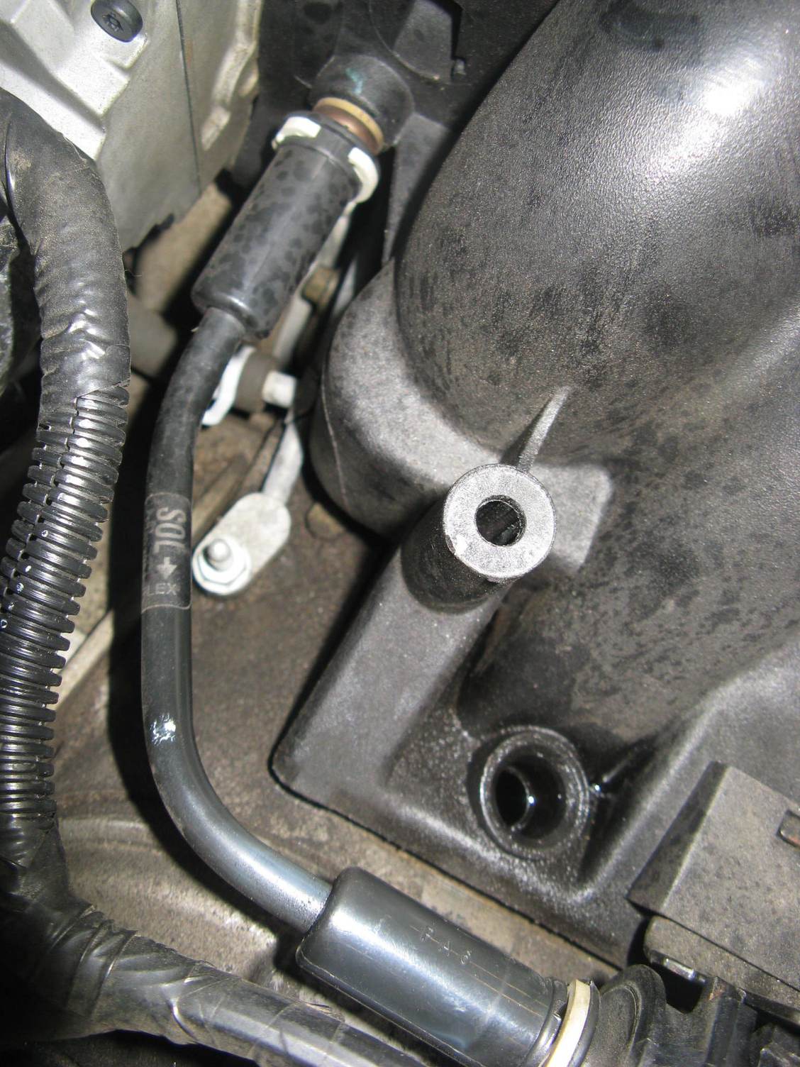

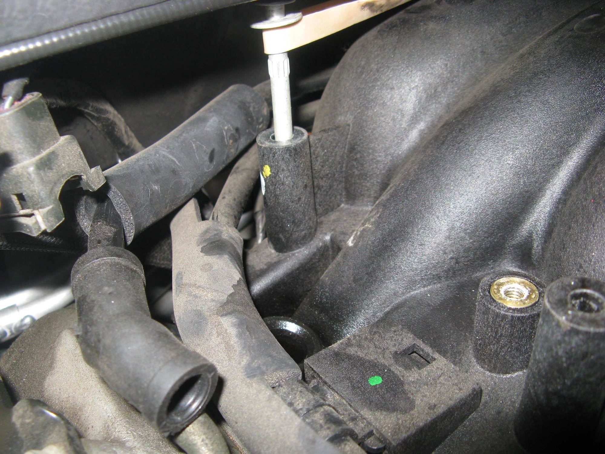

I have the manifold loose and can move it forward a little bit but it seems like something in back of the manifold is holding me.
I am trying to separate the air duct from the MAF but this is as far as I can get it. I do not want to force it, do I heat it with a hair drier?

1. you push the white part (clips) in to release the connector
2. the vacuum lines for the brake booster and HVAC are connected to the back of the intake and might be hung up on the air pump lines( add a length of hose to the HVAC hose to make it easier to re-install
take the brake booster line off at the booster(leave it on the intake (if you can)
3. I would have taken the air intake hoses completely off

in case you would like to re-locate the oil sensor, here are some doc's to help.

Thanks for the replies.
I took the vacuum line off the booster already and I have removed the air intake from the car, the picture was taken on my bench.

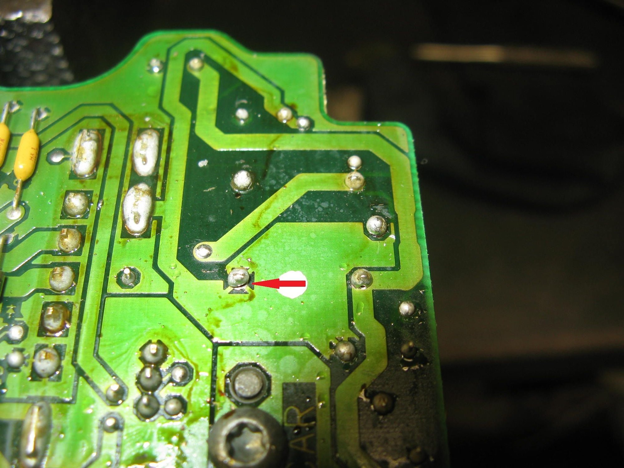

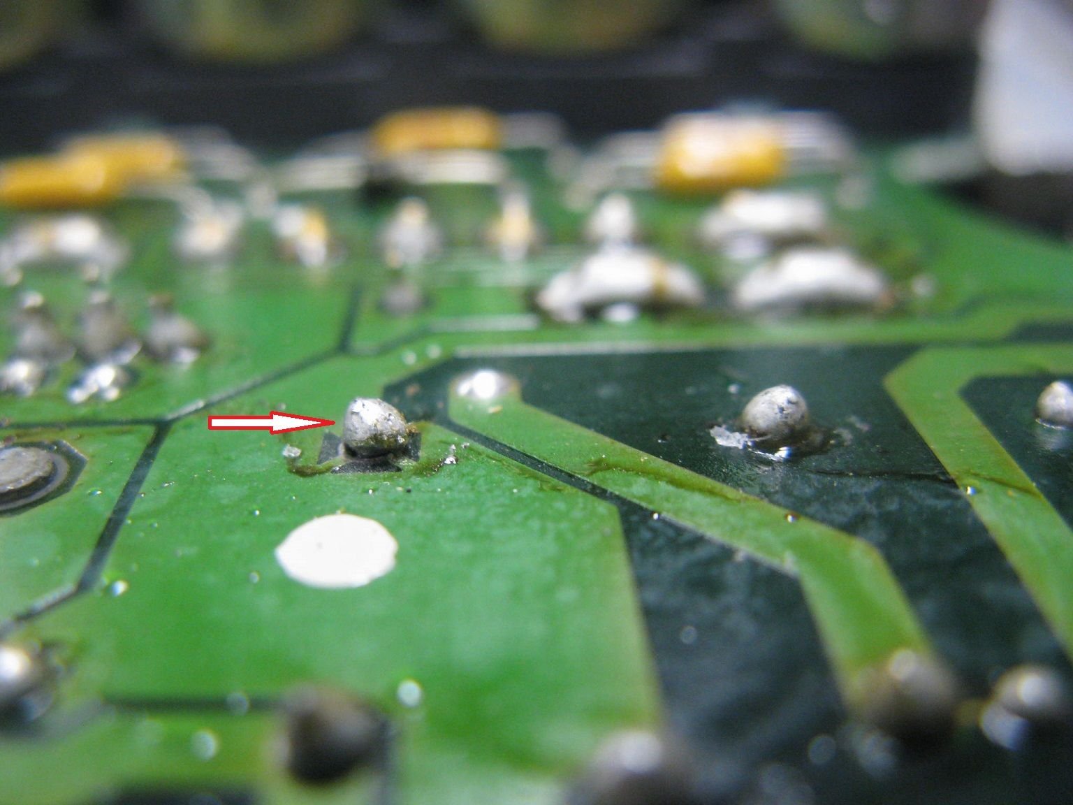

I have the manifold off and I also removed the EBCM and I was able to get the cover off.
Some company already repaired it, and did a terrible job re-soldering, they look like little solder *****! I found a solder connection that I can move so I will be de-soldering and then re-soldering during the week.

He was referring to the AIR system check valve for the passenger side at the rear of the passenger head. The driver side is exposed and easy to access. I would replace it since you have the manifold off.
That is some crappy soldering.
