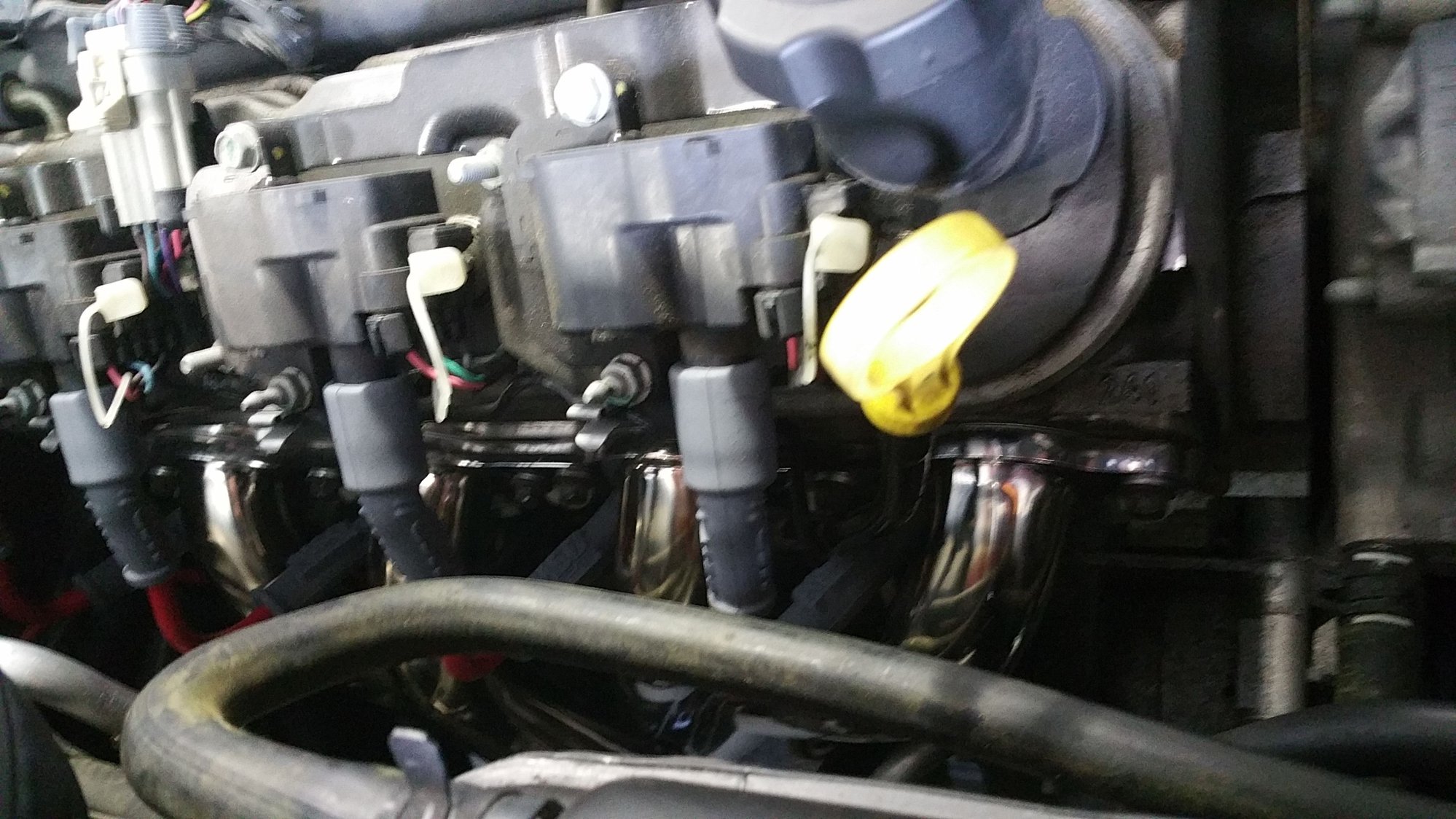

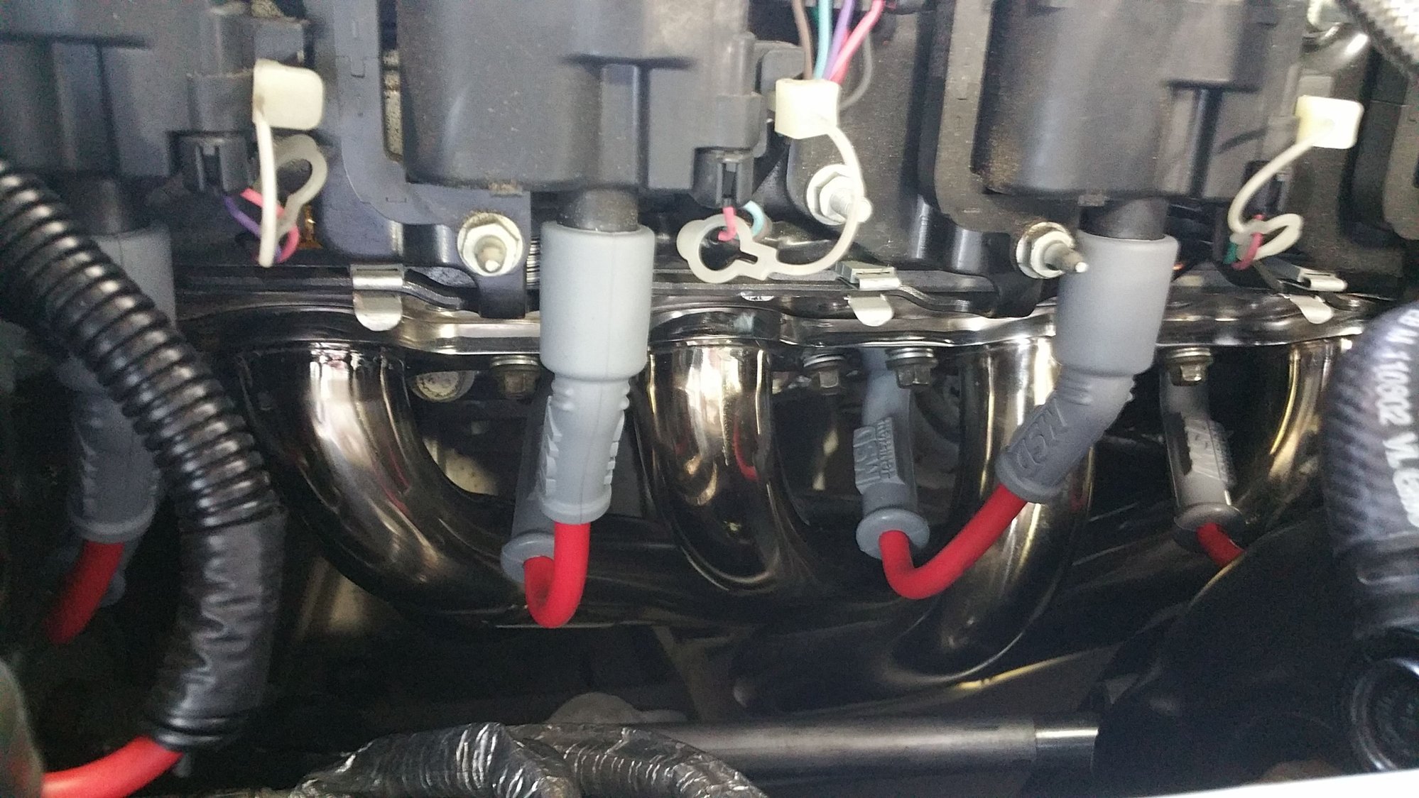

Some quick shots yesterday of the headers in place. More pics to follow today when I get a chance to run over to the shop. If everything goes smooth, I will have her back tonight (shocks not withstanding).
Passenger Side
Driver Side
