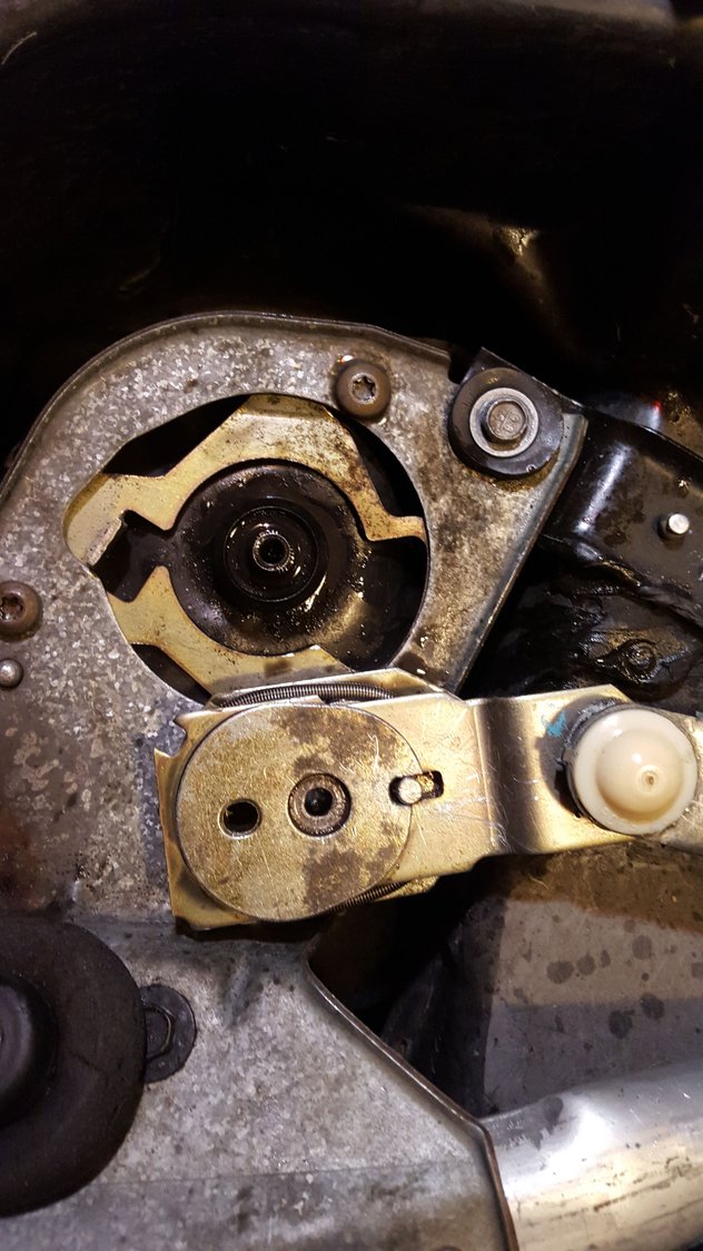

If they are consistently stopping straight up and wipers work on all speeds correct I'd bet its the gold 3 layer cam that connects motor to transmission arm.
That button should slide out of the slot when off, if it is still in the slot when off that's the run position. Can try cleaning all the springs, etc...and lubing.
Mine still gets stuck in run occasionally, al little wd40 and nudge on button gets it to park on next cycle.
Plenty of used transmission arms with the cam but assume they have same issue, mine looks great, not bent, etc... just a poor design, new ones are like $400...

Been messing with it all morning and still no progress. Every now and then the wipers will park properly. The last time it did this, I just left it there so I can at least drive without wipers sticking up. I'm not really sure what to do about it. Is there a package that comes with everything, new motor, new circuit board, new transmission arm?

above is correct park position
above is correct run position.
Take a look at pics when they are parked up is the button in the slot or out? THe first pic with button out of slot is the correct park position. the second with button in slot is the run position.
If it is coming out of the slot when parking up you need to adjust tightening down the screw in center of cam to wiper motor search for innerwipe procedure, also on you tube of gm wipers.
The circuit board is park of the wiper motor - if you got all speeds, delay and off working correctly its not the motor.
The gold cam thingy is the keep to parking down, make sure the button slides out of the spot when off not stuck in the run position. That is all one piece with the transmission arms plenty for sale used but might still stick, new is about $400.
Mine still occasionally sticks in the run position but is adjusted correctly, a little wd40 and sliding the button up and down in the slot to unstick will fix for me on the next wiper cycle.

if you take off the wipers and take off the plastic tray easier to get in there, can take them out completely, reinstall, run some water down them make sure they drain.
Make sure the 3rd under the battery is seated properly so that nothing gets on the computer.
I snipped the tips for better flow less likely to clog.
