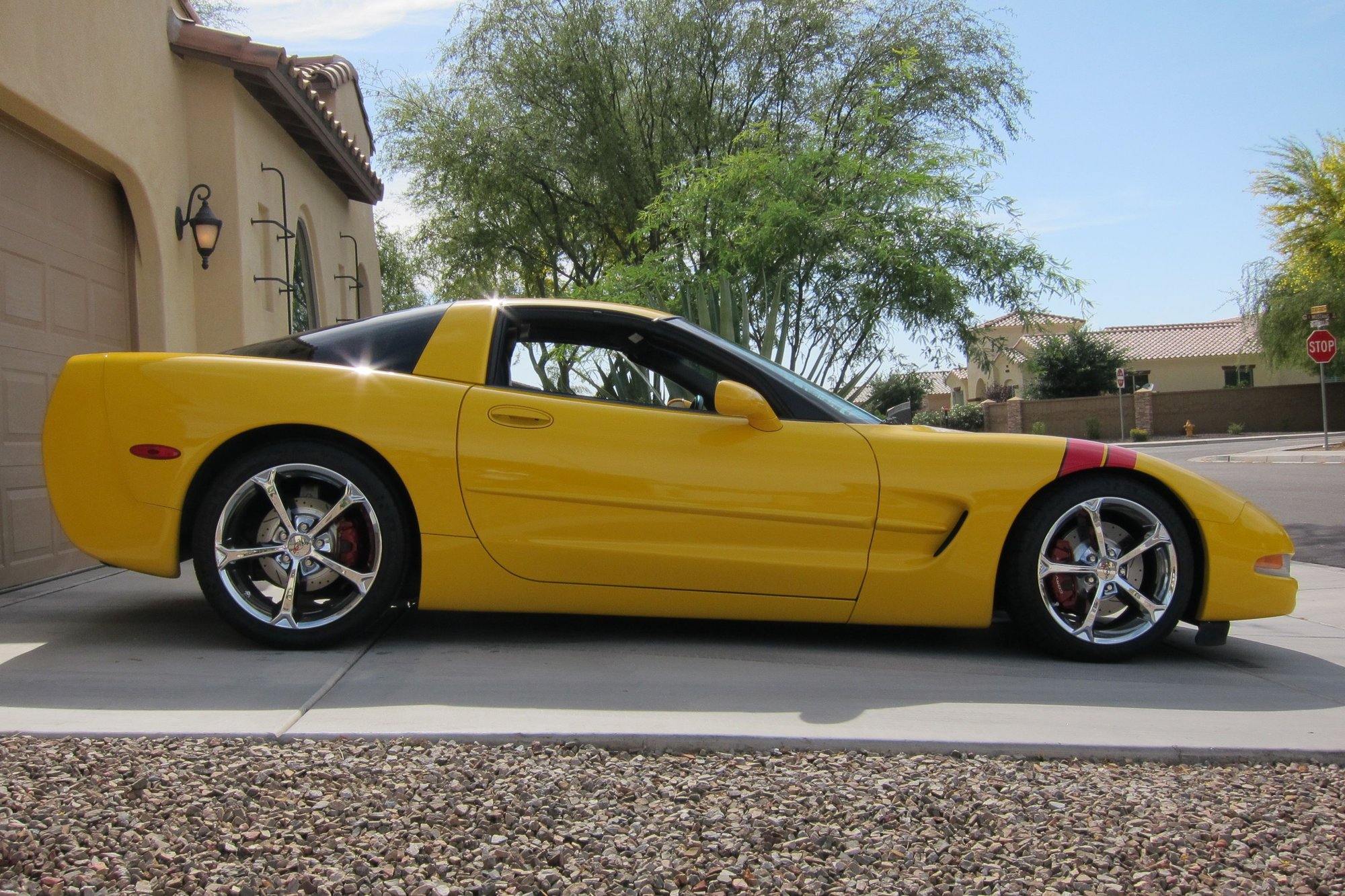

I would think it would be really hard to paint (either brush or spray) without removing calipers from the rotors and pads. How would you get to the backside? How would you be able not to get paint on the pads? How could you clean the calipers fully? I think it's best to just undo the caliper bolts and hang them ( I used a wire hanger). You can clean them fully (which is EXTREMELY important) and be able to paint the entire caliper.
Here is my 02's calipers and they were done like 13 years ago.

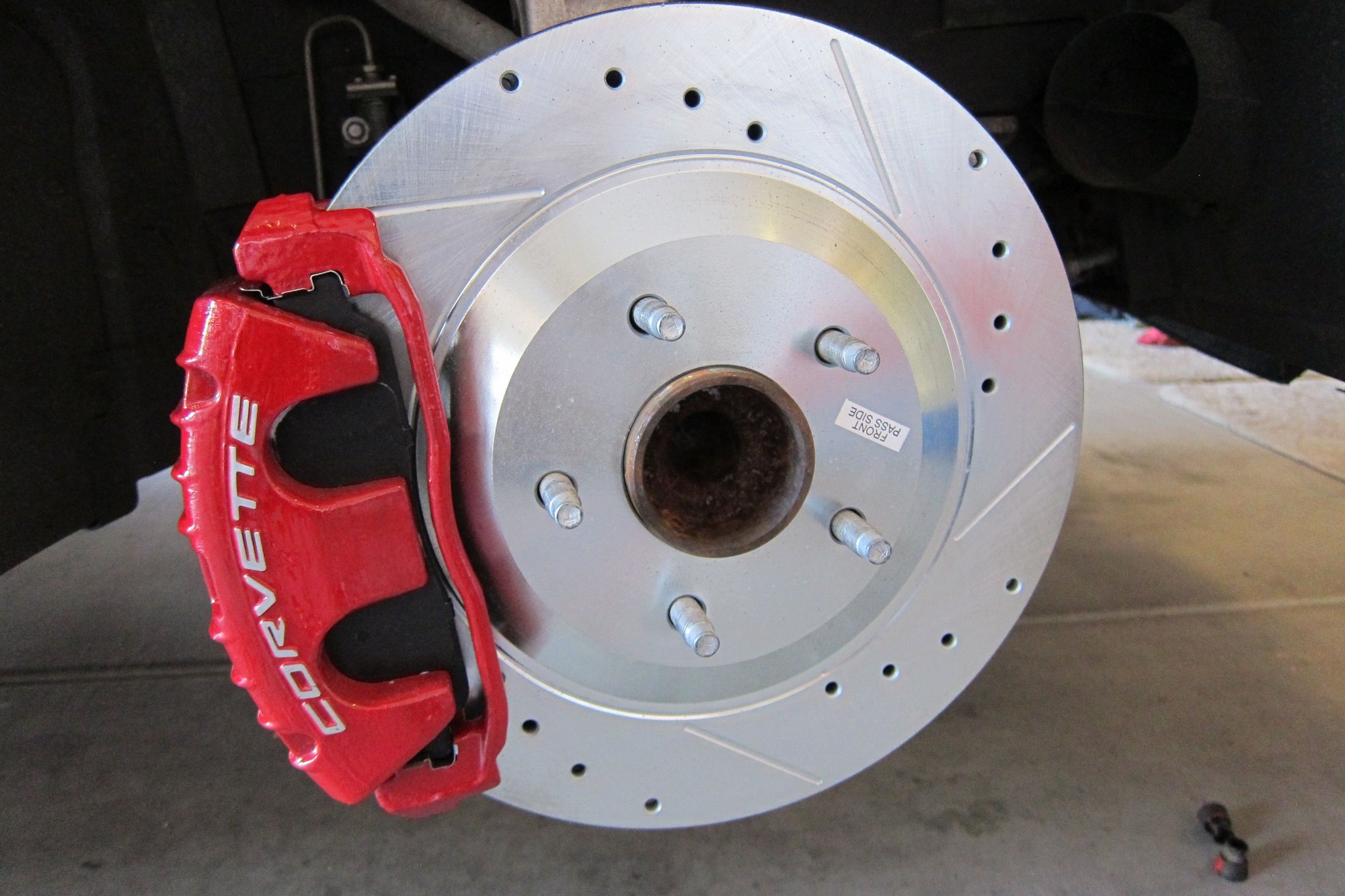

I went the brush on painted route. Complete disassembly, I was replacing pads and rotors also. Bolted the caliper on by itself and painted, let dry over night and re-assembly. That was 2 years ago, took off my wheels to clean the barrels and calipers. They look as good as when I first did them, no fading or chipping.
