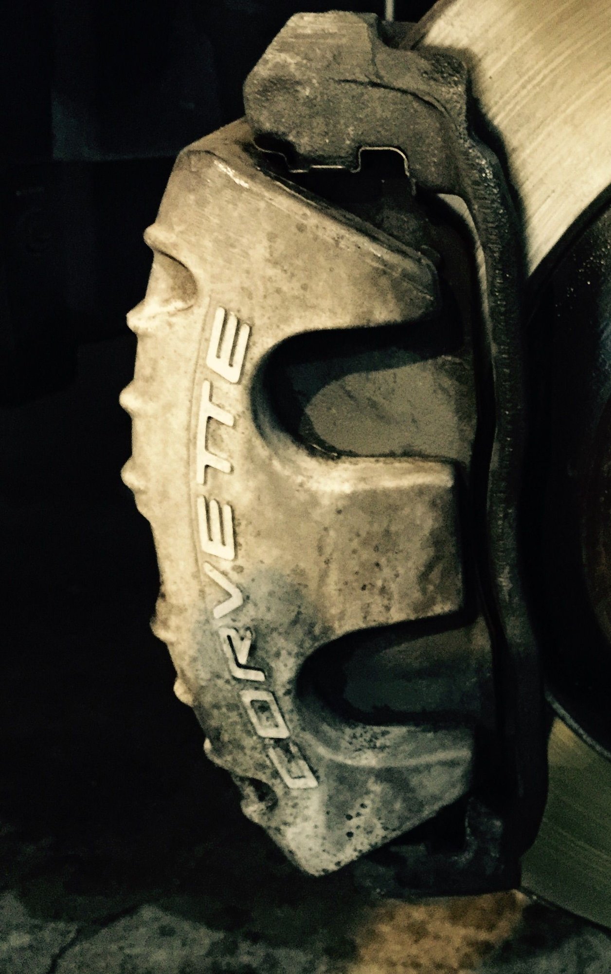

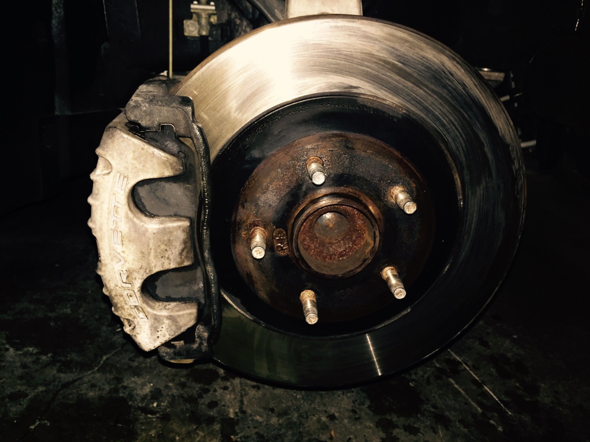

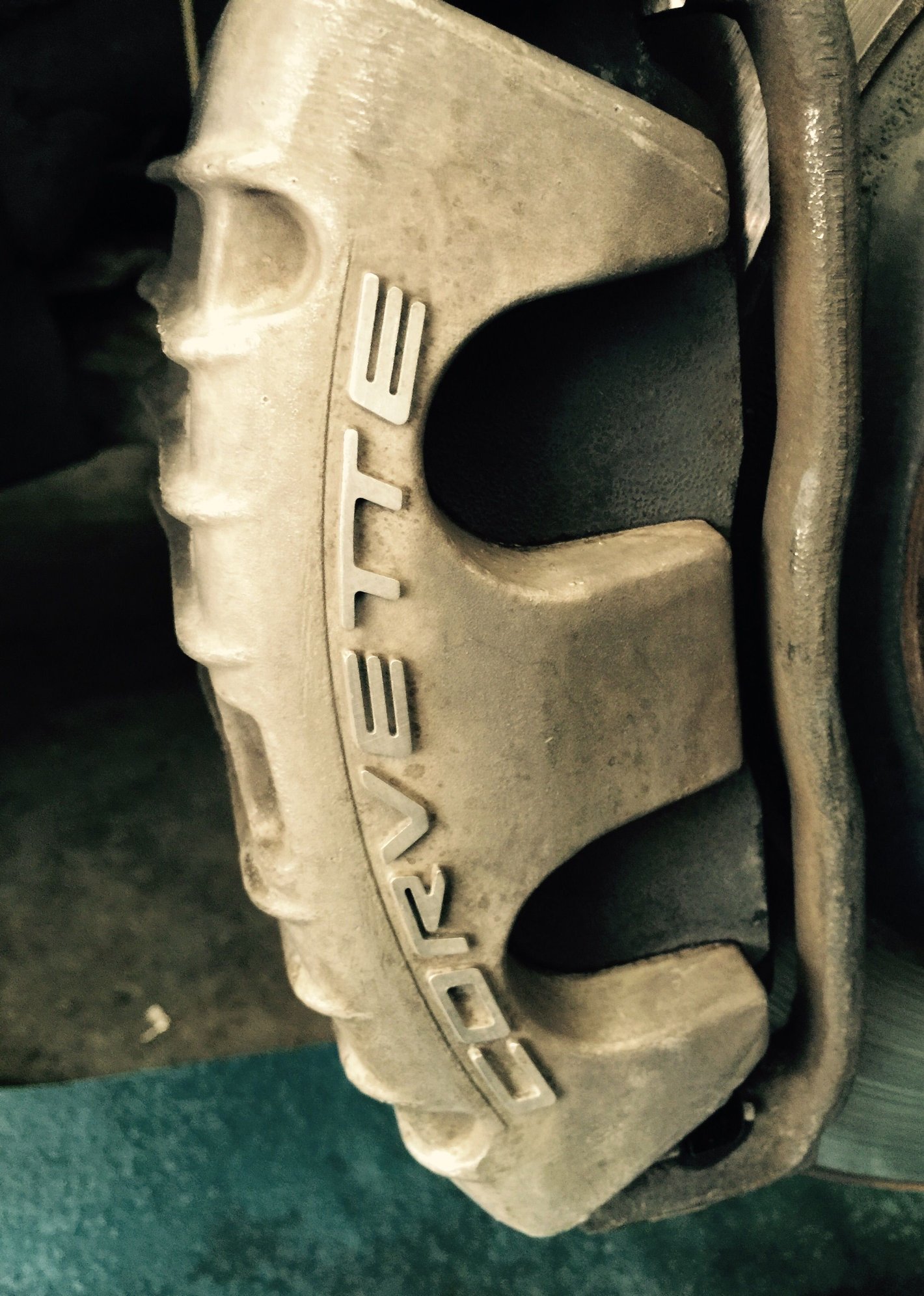

Finally getting time to do some deep cleaning on my 02 coupe, and my calipers are really dirty/grimy/stained. Someday (soon hopefully) I will paint them. But until then, what do you recommend I use? So far Simple Green has cleaned it a little, but they're a long ways from being clean.

I used it today, and Everytime I wash the car.
But looks like yours have been neglected sir.
Get some brake cleaner, and some brushes, then some more 'Simplegreen'.

Can't really tell from the picture, but a leaky caliper can cause your problem. I'd pull the caliper and inspect for leaks. Replace or rebuild the caliper if it's leaking. No amount of cleaning will last if you don't fix the cause.

I've used a can of brake clean and a toothbrush on powder coated calipers with decent results. Not sure how that would work in your case though.

... Yuuuuupp, time to roll up the sleeves and get'r done, and inspect the condition of seals, brake hoses, etc. Don't get lazy when it it comes to this safety issue and the welfare of it's occupants. I agree with the other suggestions to use brake cleaner and brushes !!.......Have a beer and have fun, good luck !!
P.S...... Wire brush or wire wheel those hubs where the wheels make contact, can create a irregular contact surface causing pulsation !!

When I got ready to paint my calipers, I used a liberal amount of brake cleaner, then used some fine grade steel wool, followed by more brake cleaner. That got all the grime off, then I applied the caliper paint. Many years later, the calipers still look like new.

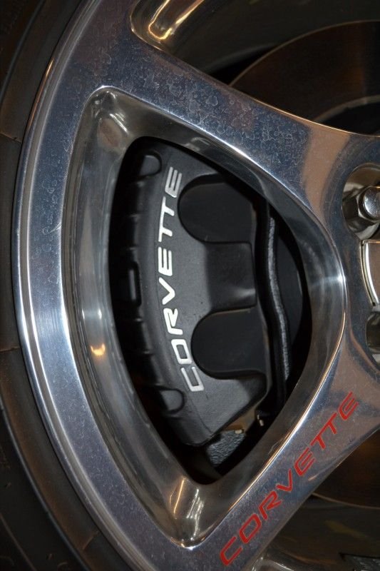

Used brake cleaner, steel wool and what muscle I have, and the caliper is looking better. Here's a before and after:
<br > <br >
I didn't see any leaks, so perhaps there was a previous issue that was repaired but not cleaned up well?
I still want to paint the calipers to make them pop more under my Z06-style wheels. What do you think would look cool on a black car? I see a lot of red, but wonder how a black caliper would look.
Thanks to all for your input.
