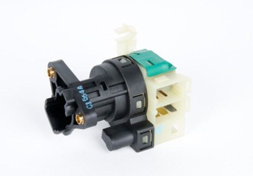

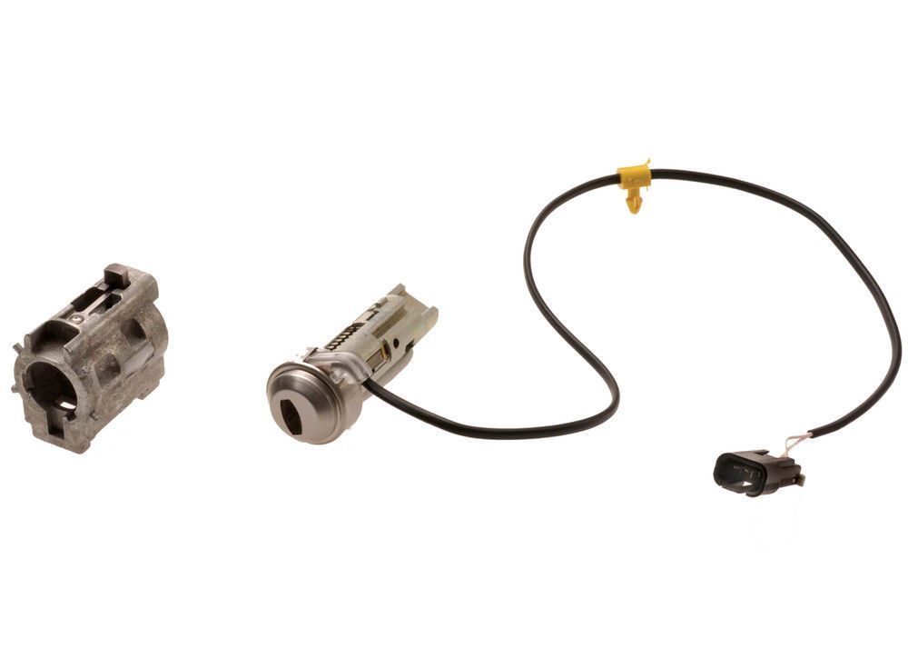

OK so acting squirrely again
Is this what I need?
I can still fiddle with it and soon or later it will work/start
Sometimes it works/starts right away
Old Aug 10, 2016 | 07:55 PM
sloopdawg's Avatar
sloopdawg
Joined: Feb 2016
Posts: 914
Likes: 182
From: Reidsville North Carolina
I know...see post #5
"Your problem is with the key cylinder NOT the ignition switch:"
But since I'm having problems and I going to be in there anyway...
should I not go ahead and change out both? Just to avoid any and all problems later
