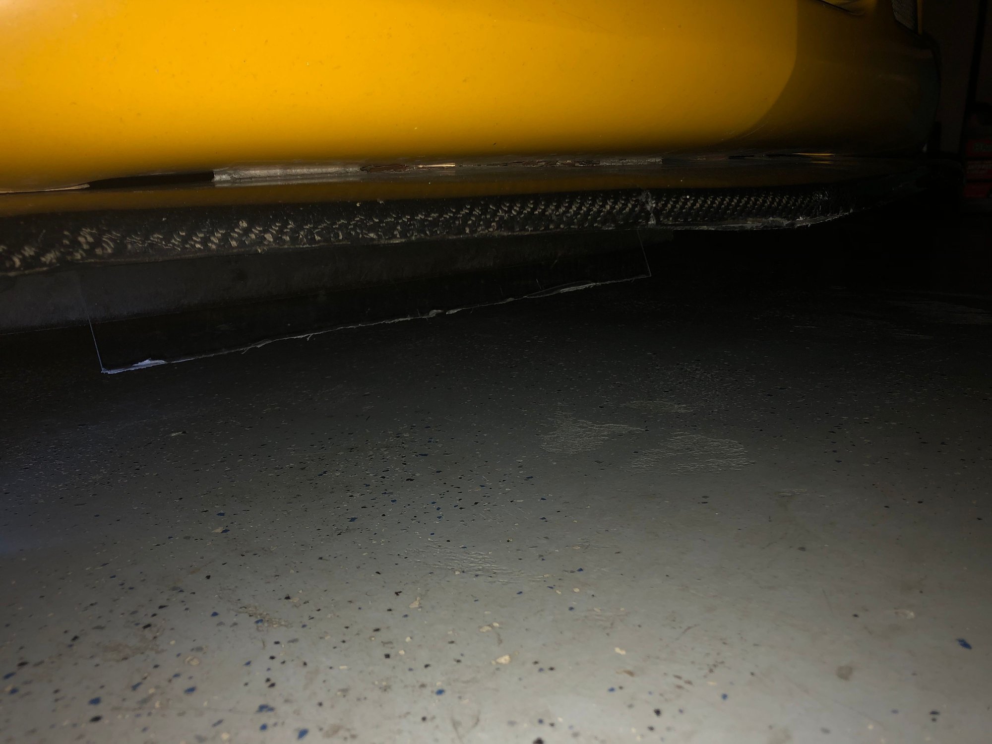

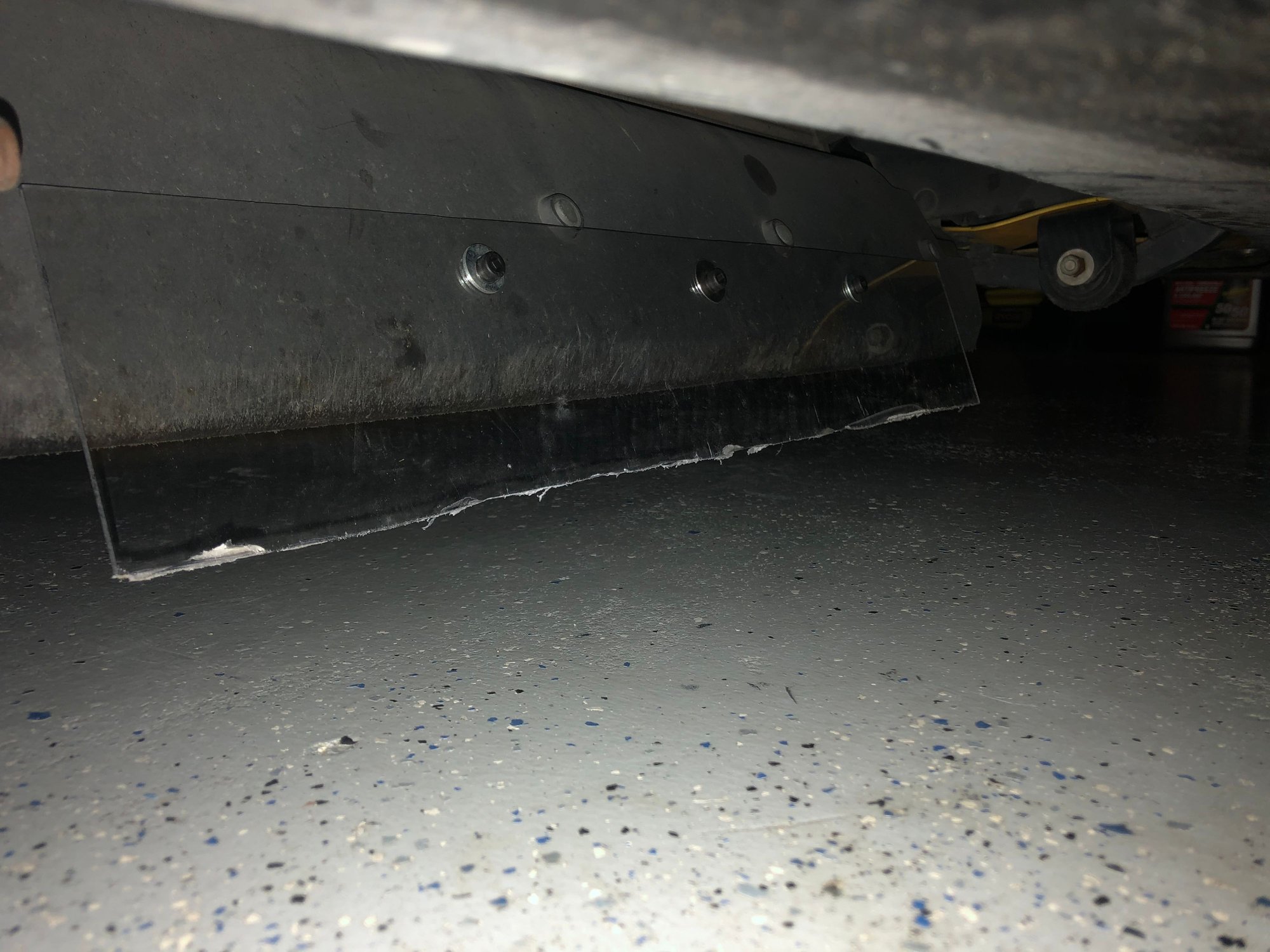

Old Nov 20, 2019 | 01:26 AM
  #38
YLO Z06's Avatar
YLO Z06
Joined: Oct 1999
Posts: 2,501
Likes: 177
From: Houston, Texas FEAR THE BONES
2023 C5 of the Year Finalist - Modified
Update on cooling temps. After installing a DeWitts double row aluminium radiator, I was still seeing ever-increasing engine temps. Flushed the coolant and cleaned the radiator again, which helped, but still had higher temps on the highway. So I decided to try extending the center air dam about a inch to compensate for the splitter in hopes of grabbing some more airflow into the radiator. I bought a 24" piece of Lexan from Home Depot and cut it a few inches in height, then drilled 3 holes and bolted it up to the factory center air dam.
I realized an immediate reduction in highway operating temps after the installation. My coolant temp was stabilized in the 171* to 178* range. Now granted, the outside temperature was in the upper 40s/lower 50s, but historically my car would never stabilize at these low temperatures, so I am pretty convinced that my air dam extension is working. I will test again once the temperature outside increases just to be sure. Anyway, I am quite happy with the results. And yes, the air dam scrapes more frequently, but the Lexan seems pretty tough and the factory air dam is hinged to move backwards when contacted, so I am not too concerned.
Old Nov 20, 2019 | 01:53 AM
  #39
Brackets's Avatar
Brackets
Joined: Oct 2010
Posts: 247
Likes: 44
From: Vancouver Island British Columbia, Canada
That lexan must make a helluva racket when you're scraping. Maybe a piece of semi rigid rubber?
Old Nov 20, 2019 | 11:51 AM
  #40
smitty2919's Avatar
smitty2919
Joined: Jun 2016
Posts: 5,431
Likes: 3,985
From: Cincinnati, OH
^Agreed, use a piece of ~1/4" thick rubber.
