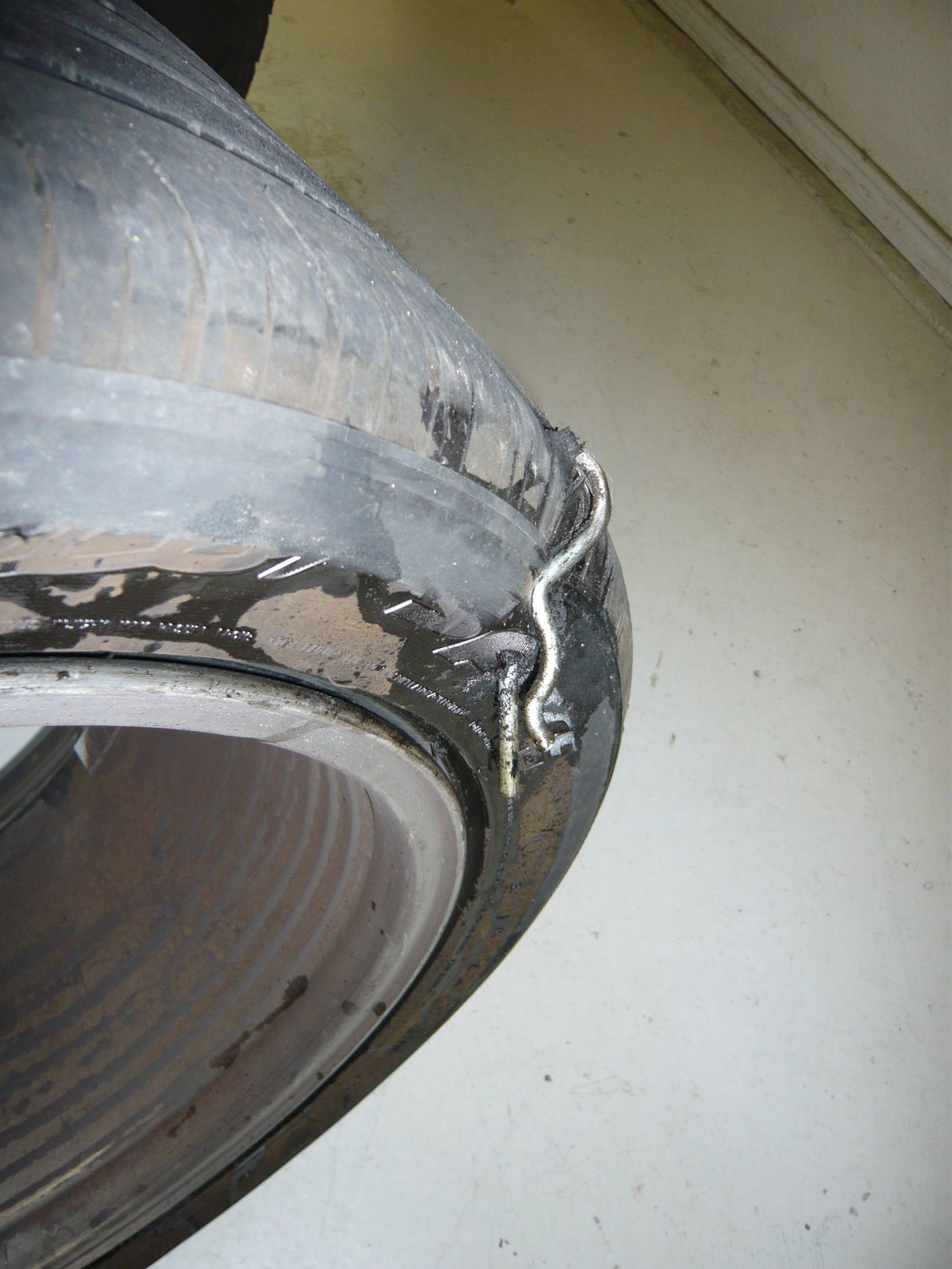

For some reason, they would not fix this one. Tread was low on good tire, so I got two new ones.

Originally Posted by thisMSGgood4me
That's one nasty puncture there, Jim. Unfortunately, you found someone's trailer hitch pin clip.
I starred at that for a good minute trying to figure out what it was, what dumb luck hahaha
Looks like something similar to what happened to me wife. She ran over a bungee cord that was laying in the road. The hook bit into the tire, and blew it out. HOWEVER, it apparently stuck into the tire, for a while, and became a pinwheel, doing a real number on the quarter panel, before she got it stopped.....
