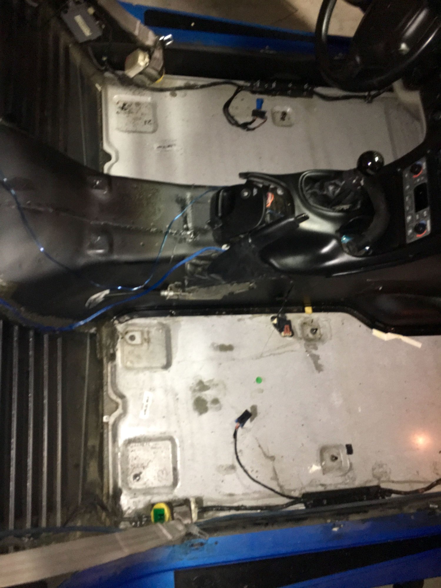

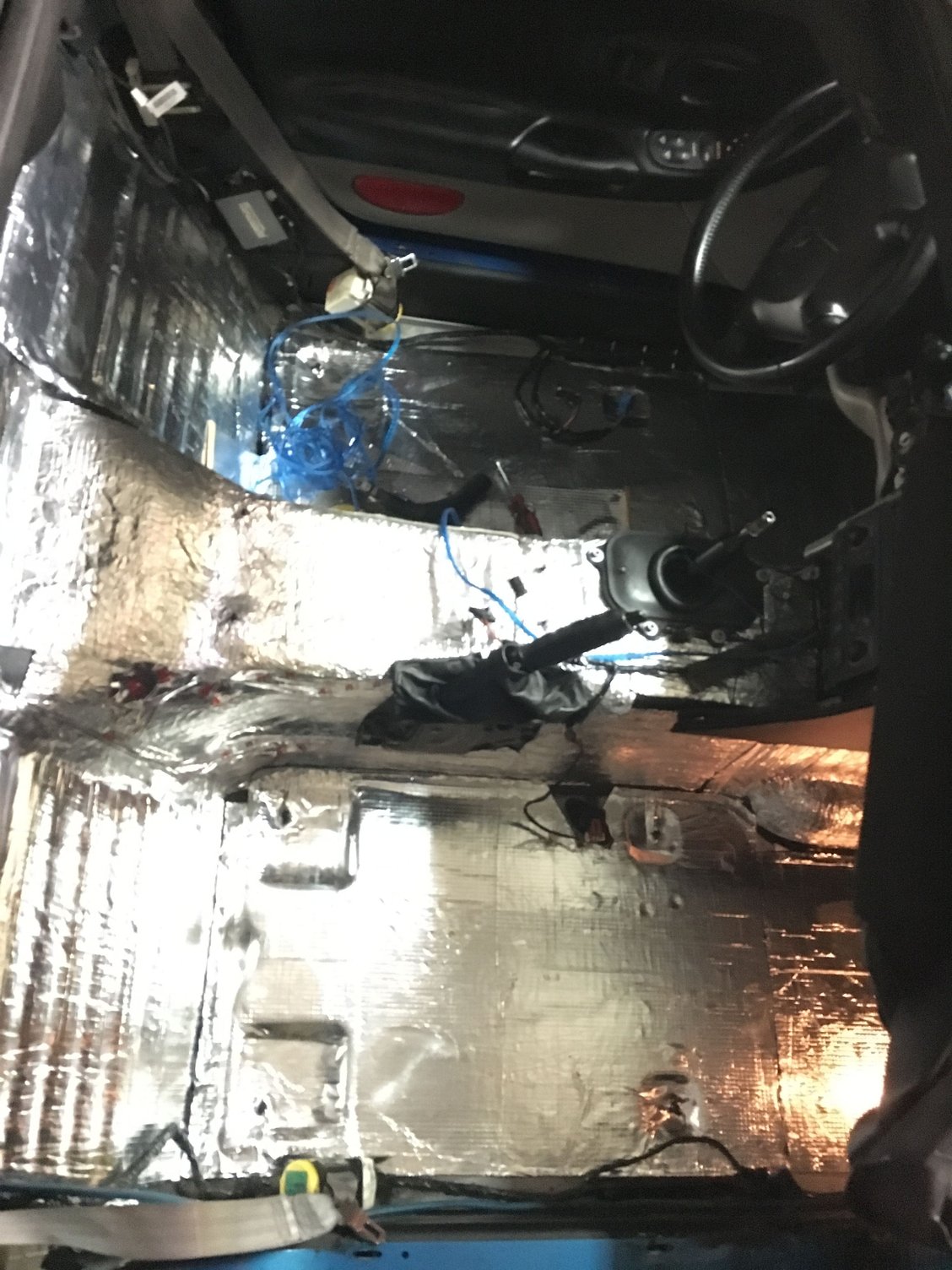

It takes about 20-30 mins to remove both front seats, center console, carpet and kick plate trim on these cars. Rip it out and insulate it.
Before
After
I used one roll of frost King on the tunnel and 80mil sound deadening on the rest of the entire interior. I also purchased a ceramic coated tunnel plate. Cut down on heat considerably.
