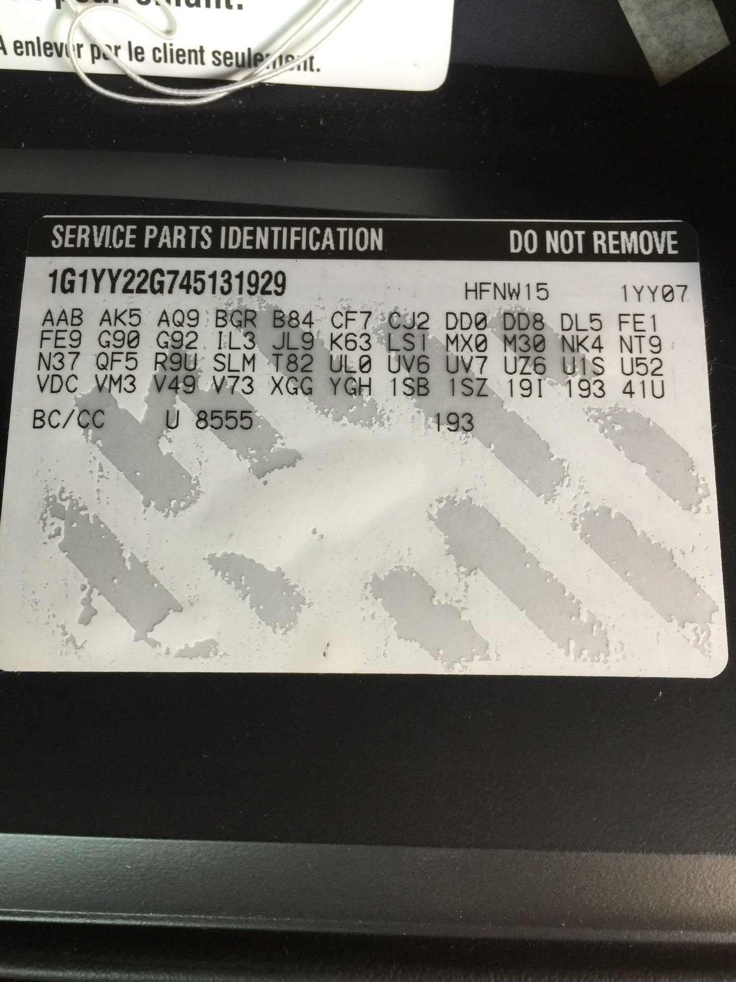

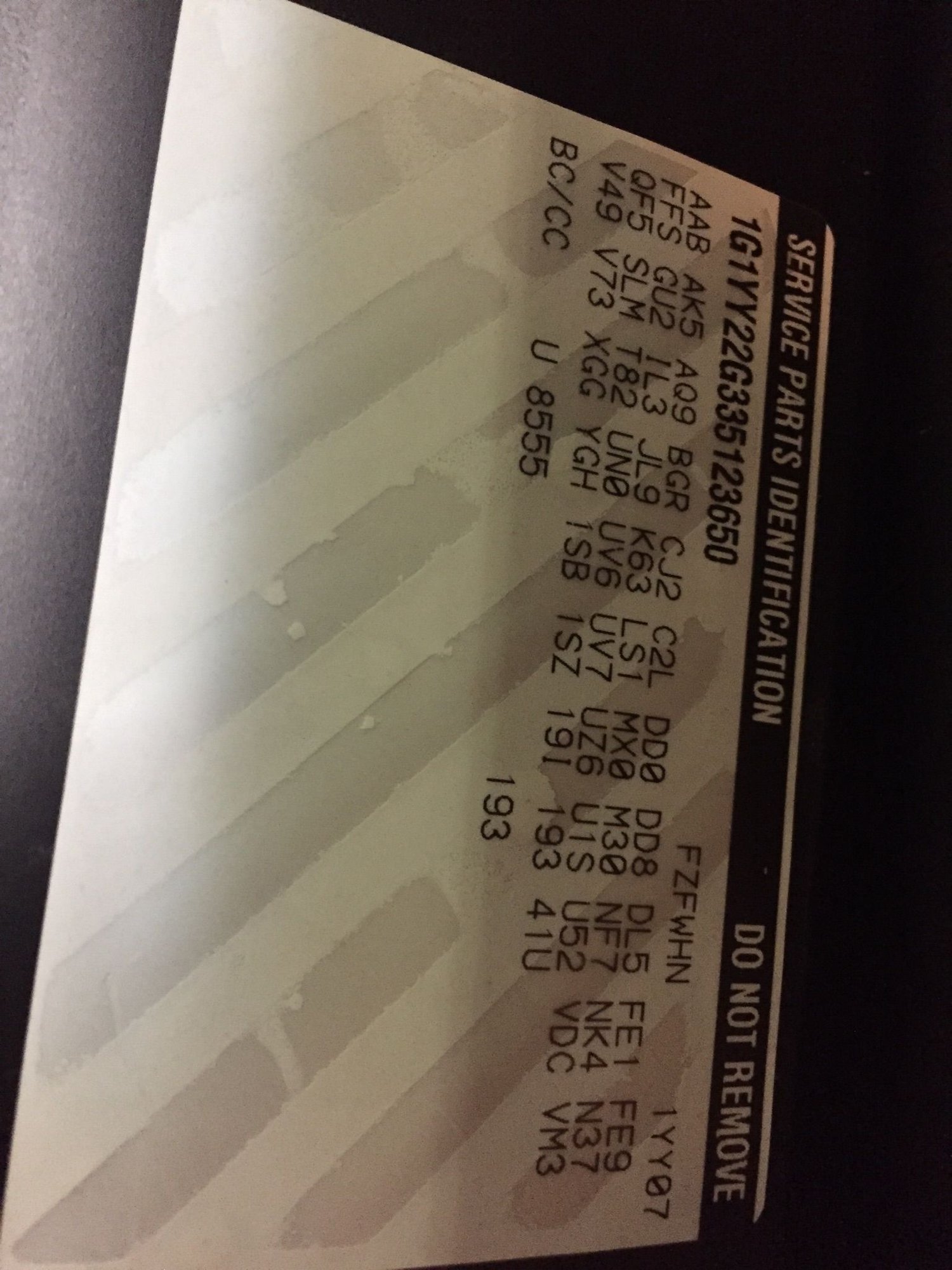

Originally Posted by Rob 02
The sticker looks like this. Attachment 48006677 If we can see the codes we can help you.
This is 04
This 03

The 03 has the 3.15 gear axle but came with a cassette player.
The 04 has the 2.73 axle and will feel more sluggish. it came with a CD player.
The 03 is the winner.

I think you might have that backwards...03 comes with glass targa also which is like $1000. And is Virginia so a could see it with me being from Jersey the 04 is in Texas which have to be shipped to me

Both have the cd changer in the rear (U1S), I'd take the 03, all things equal because of the axle ratio. If you want an indash CD as well as the changer in the rear, you can buy a used one off ebay for a hundred bucks and switch out the head unit. (assuming both still have the original radios).
EDIT: If you can only look at one, that's the one I'd buy, unless you find something wrong. Don't buy one you haven't seen or had inspected. It may be a better car, but it may not and you may regret it for as long as you own the car.
