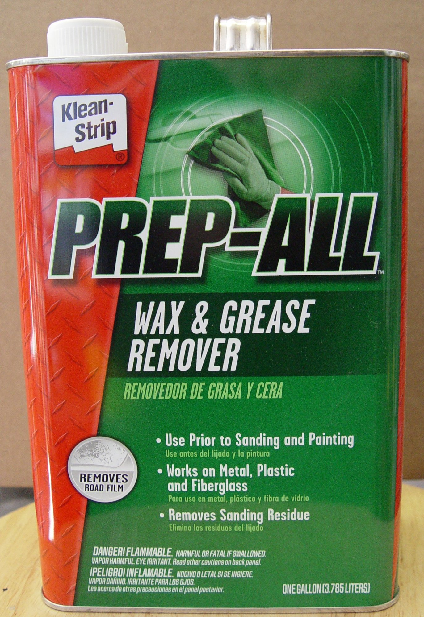

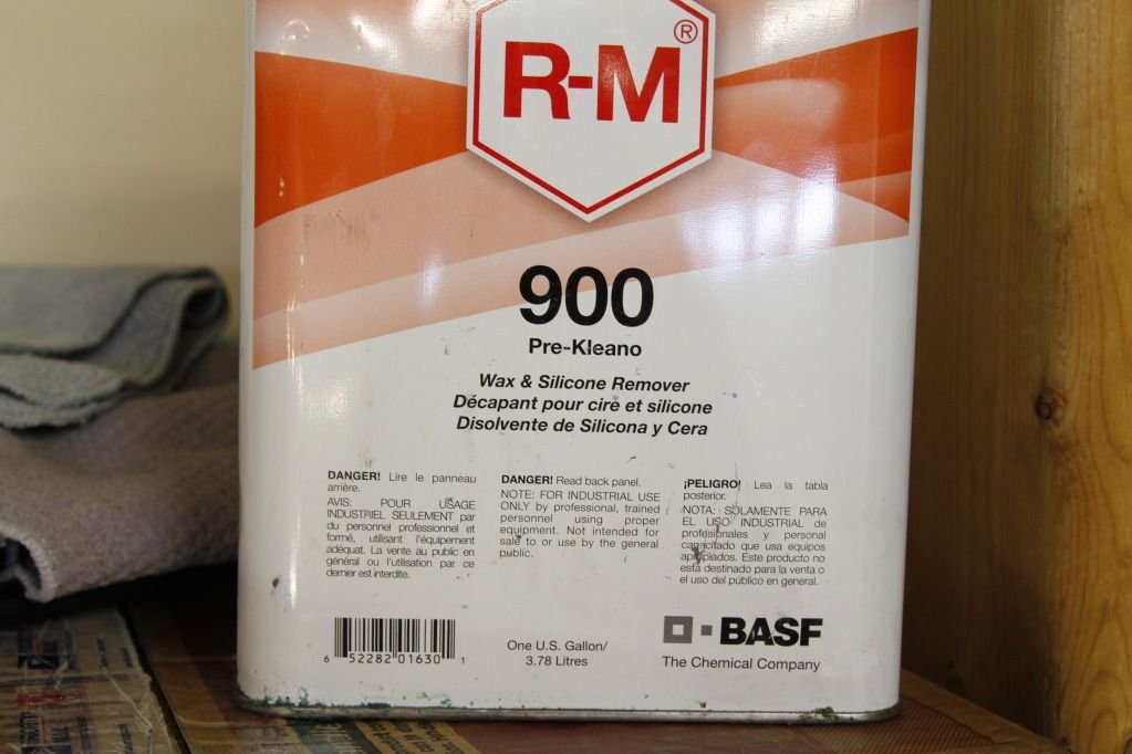

Go to a body shop supply house and ask for "Pre-Kleeno" or a similar brand product.
It's professional wax and grease remover and will take off the tar without damage to the paint. You can even cut it on the rag with water. USE gloves! You will have to re-wax when done. PS: I use it to clean under hood areas too.
