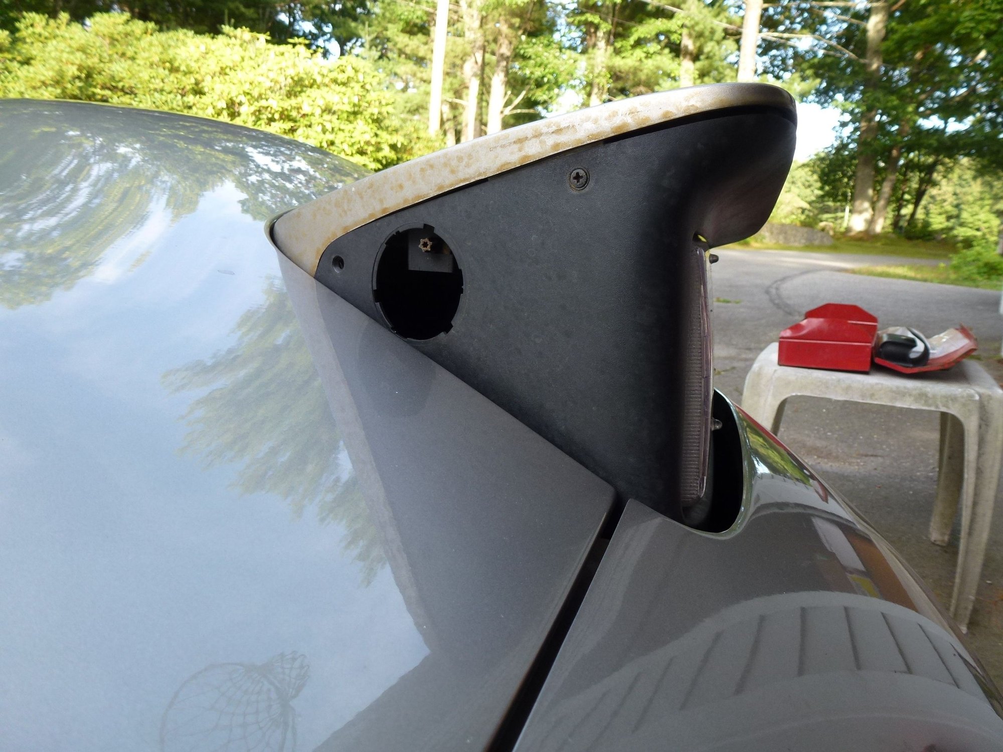

After putting my headlights back together, I noticed this gaping hole in the plastic shroud of both headlights:
This might help to explain why the pivot bolt on the other headlight was corroded and frozen (i.e. water infiltration)
Easily replaced parts:
http://www.ebay.com/sch/i.html?_from...+plug&_sacat=0
