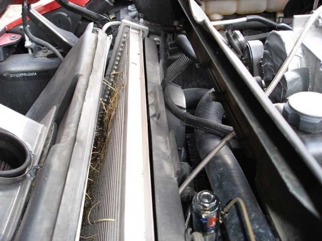

Get under the front and look up between the back of the a/c condensor and the front of the radiator. There's a deep V going up to the top of the radiator, take a look and see what's up in there, I've seen plastic bags, cups, grass, and other debris stuck in there.

Like this:
You can also pull the top plastic shroud above the radiator and see it from the top.

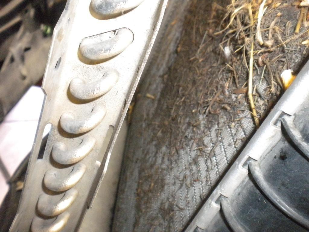

here is some news I find the problem thanks 65GGvert !!
I pull up the radiator top protection and this is what I find !!
the A/C rad was in different parts completly destroy and it block the airflow with dirt and a dead rest of bird inside !!
