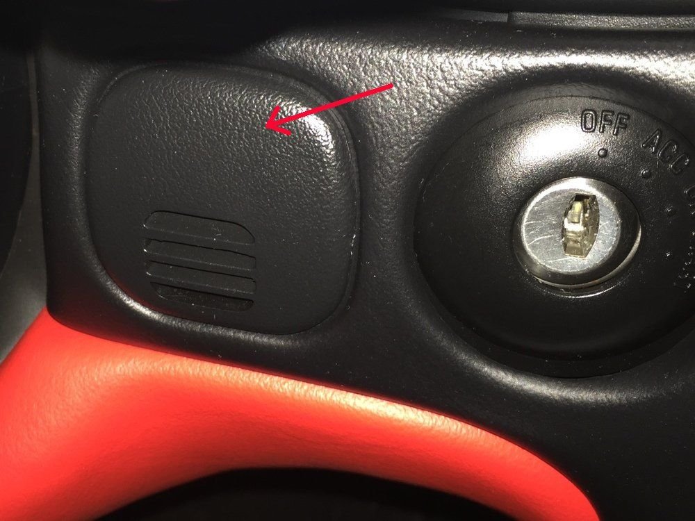

Whistle could also be the small fan that pulls the cabin air in to measure temp for a/c. It's behind the small grill that pops out near the ignition.

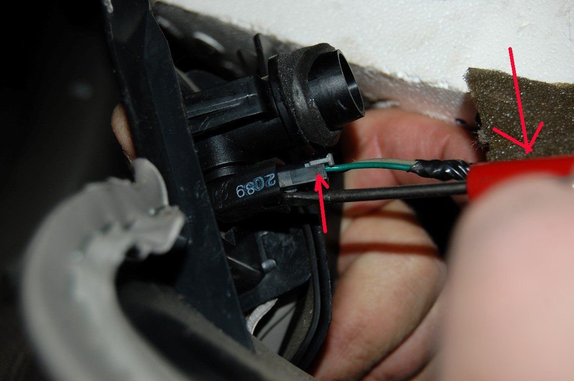

You can unplug the power to the small fan that's mounted right behind the 2" or so grille by the ignition. If the noise stops, it was the fan. It has a small connector with a short piece of wire attached to it.
Disconnect the connector with the green wire to kill power. The fan is the little round one surrounded by foam in his hand.
