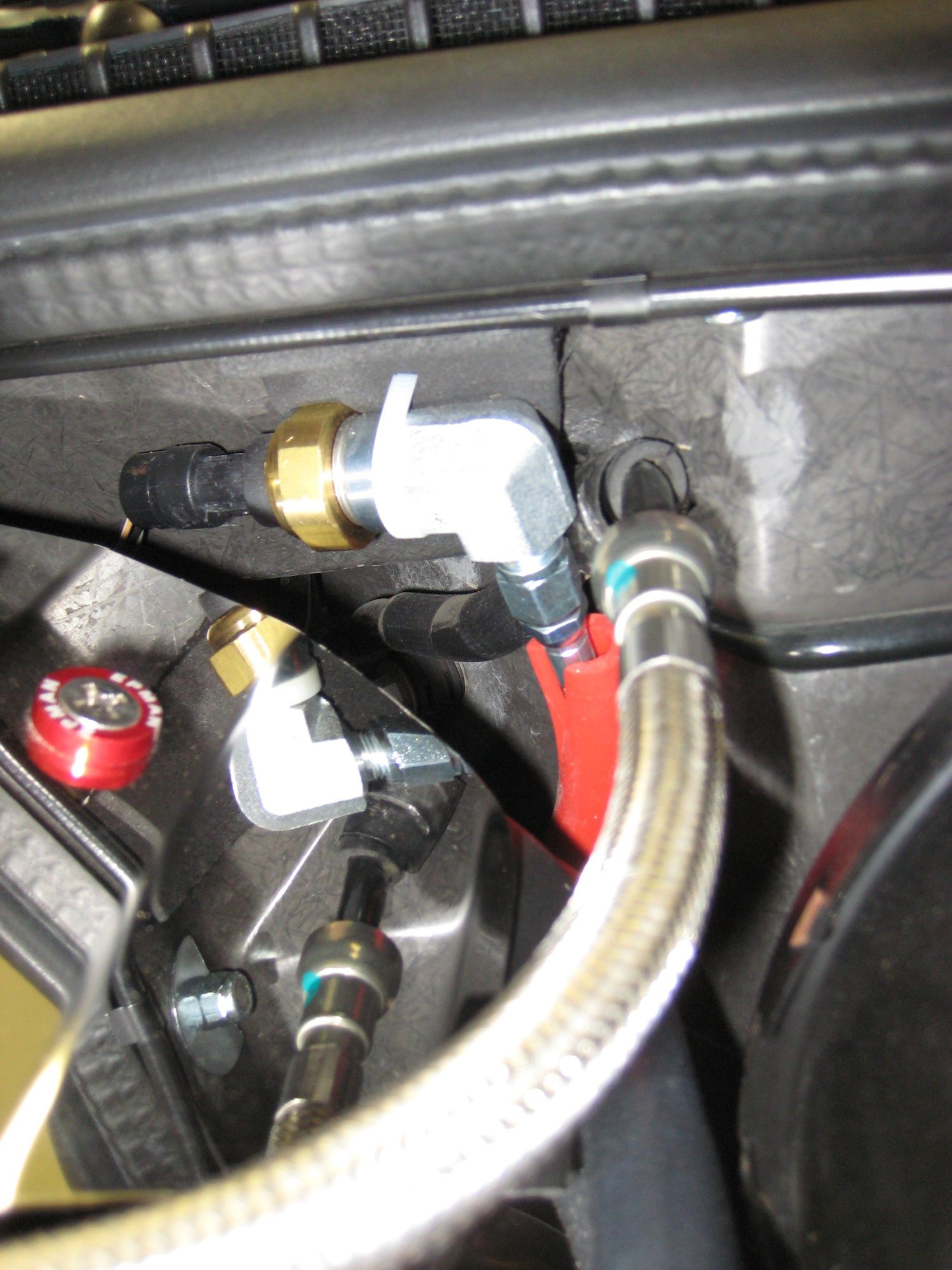

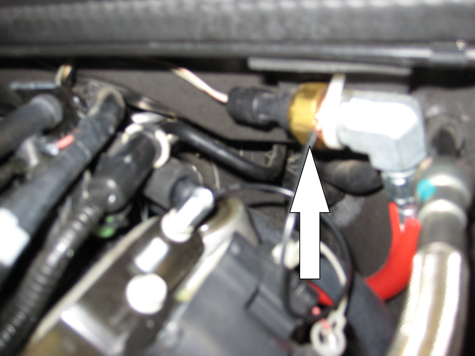

Well I decided to start a new thread on this issue, a while back I mentioned in a couple threads that my remote mounted oil pressure sender would go to zero on the gauge and DIC at a certain point on the x-way. I have now seen that there is a radio tower there as well as a cellular tower both causing the malfunction at their spots (about 400 yards apart). I have since grounded the sender and as of 6 fly bye’s no more pressure drop (was not really dropping just a interference on the gauge).
