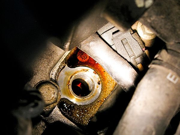

the T-Connector has broke on me while 100 miles away from home and had to swap it out on the road.
T- connector broke and was stuck on the hose. Look for any leaks around the coolant tank and whip with a white paper towel, it will show the ornage color on it.
