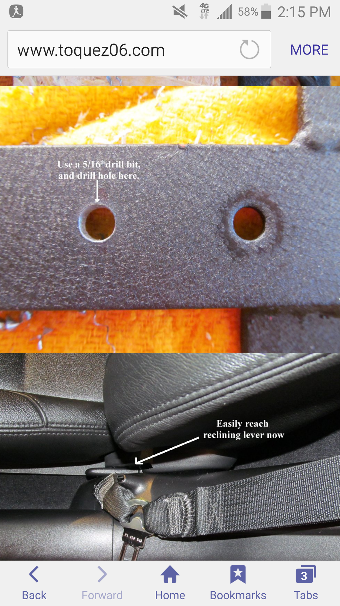

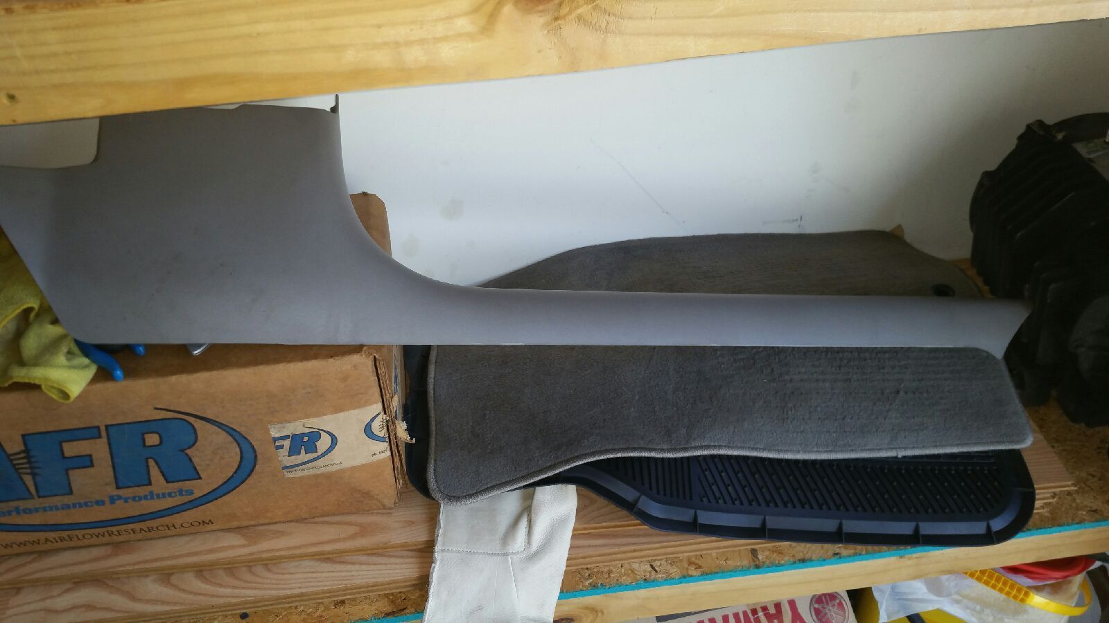

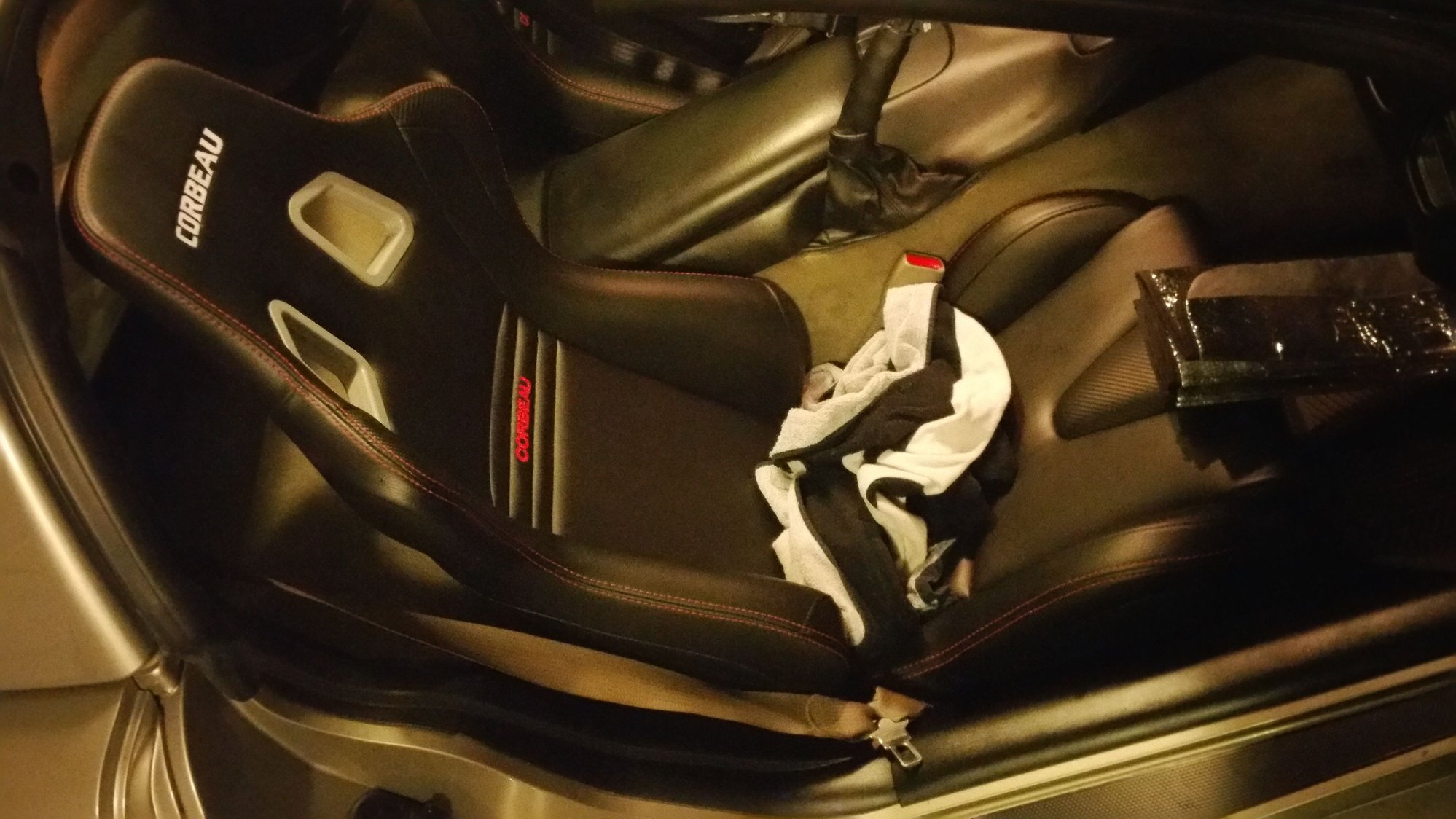

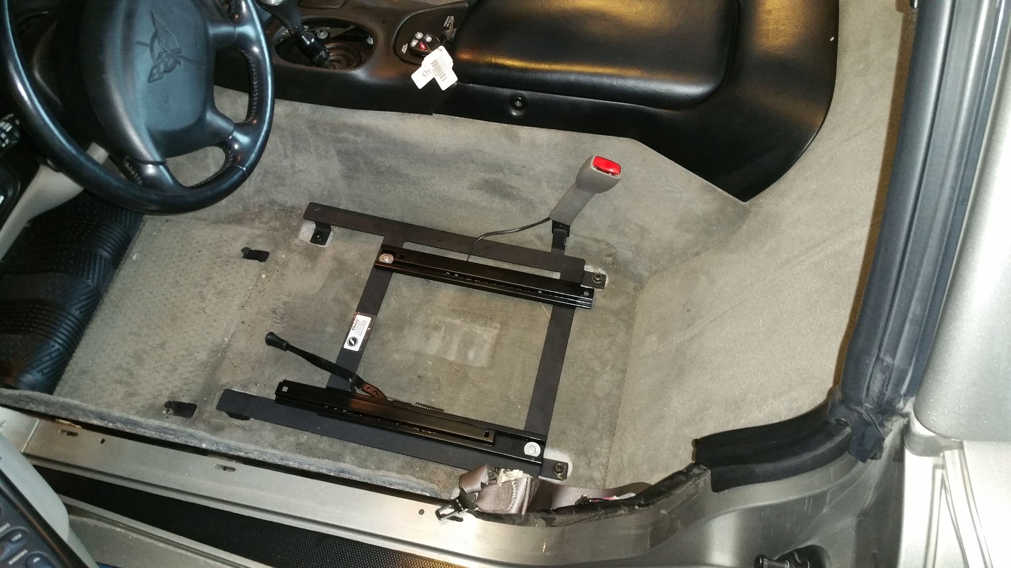

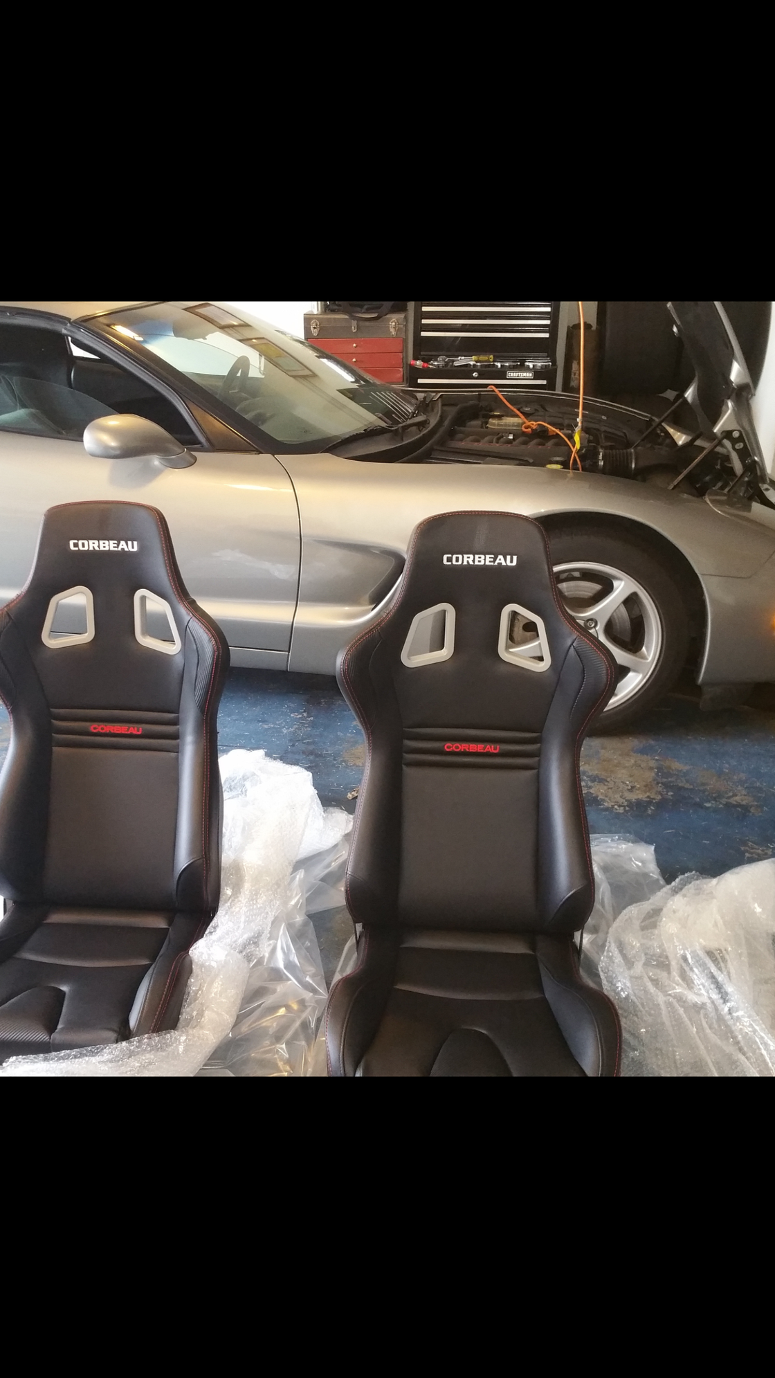

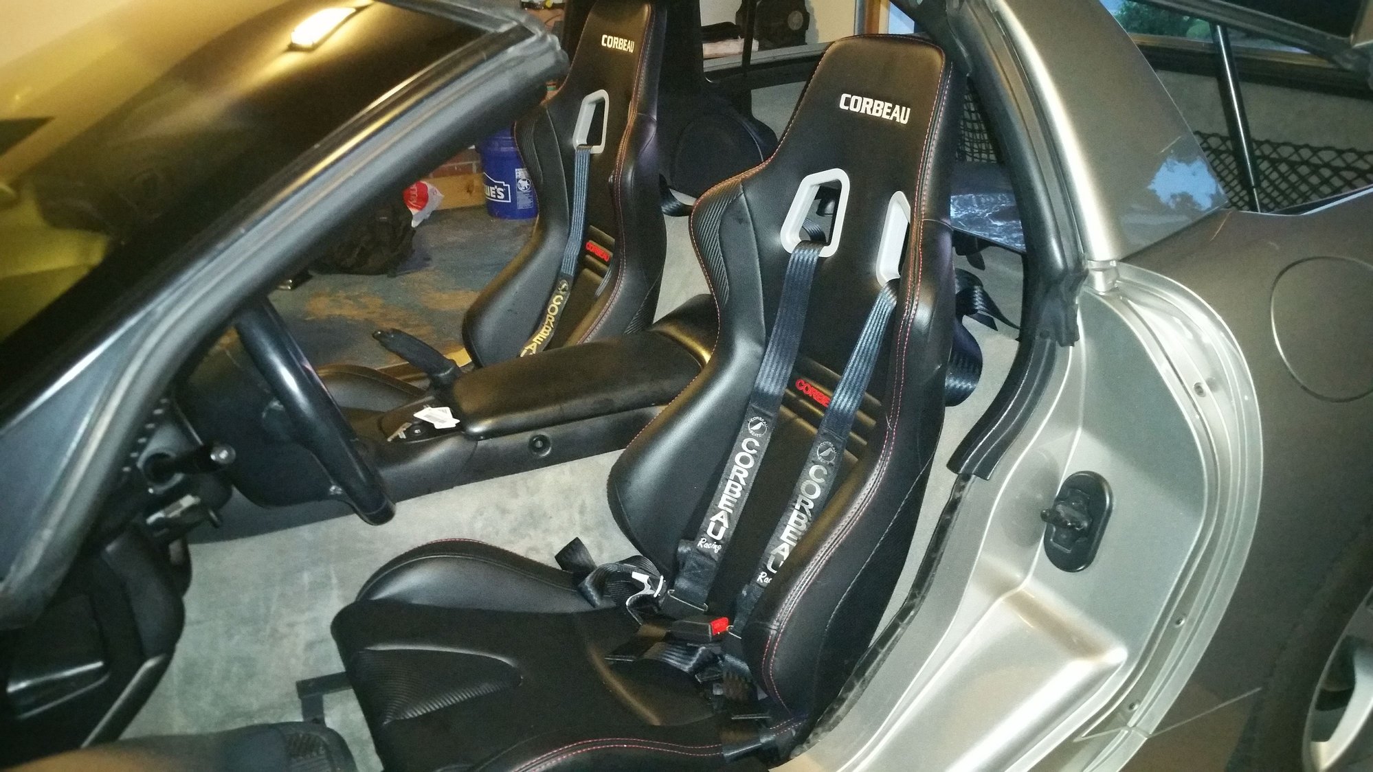

Now with my new six speed installed I was taking corners a lot faster and was spending more time trying to stay in my seat than I was actually driving. After reading an article by SuperChevy titled "30 minute seat conversion" I ended up settling on a seat of Corbeau Evolution X seats. Like with anything else seen on the internet, I ordered the exact same parts, and it certainly did not take 30 min. Maybe because the car the used was a Z and mine isnt? Who knows. Anyways it was a simple fix, I had some minor rubbing and and to drill out some new holes. The PN I used for the bracket was E1502F (driver) and E1053F (Pass) Huge thanks to a write up by toquez06
I took advantage of the seats being out and also decided to dye some of my interior pieces since the grey didnt look too good with the black (in my opinion) I also ordered some 4 pt harnesses as well, but later found out the price of a harness bar, and that 4 points are not permitted by the SCCA I decided to retain my stock belts for now
And last but not least dennis @ doubledmods hooked me up with an install kit and a Kenwood DDX-5902
I cant say enough about these seats, excellent quality and the customer service is outstanding
If you do need to re drill the holes, be sure to use a colbalt drill bit, or you're not going to get anywhere

Cool. Is that RPM near Durham? I had them tune my Z, good place.
Did you have standard or sport seats before? What is weight of new ones?

Yea they're in Garner I believe. Its a neat shop with super knowledgeable staff. I diffidently recommend them.
I had standard seats before and the Corbeaus weigh about 23lbs without the rails

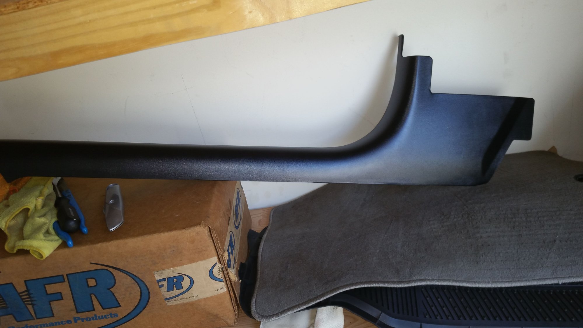

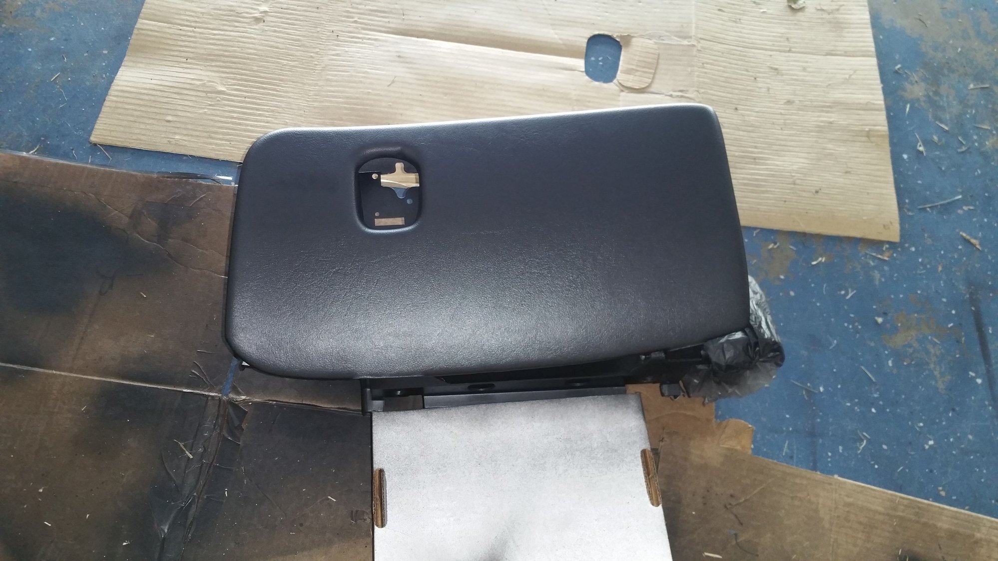

Heres a few more pics of how the interior parts came out. I used Dupli-color adhesion promoter and flat black vinyl & fabric specialty coating. It has a near factory finish and was really easy to work with. I also have some 5D carbon vinyl wrap on the way to use on the double din. The gap between the dash is bothering me (even after the classic electrical tape fix) So i'm hoping the added thickness of the wrap will help fill it in
Before
After
The glove box was the hardest part, re assembly is a little tricky if you dont have the right swivel attachments. The vinyl dye worked well for me, it matches the A pillars perfectly, and isnt tacky to the touch
