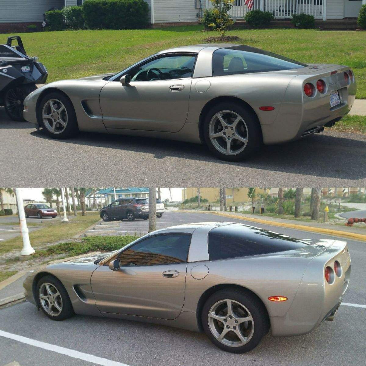

Anyways, I finally made it down to Florida. So I ended up getting some tint.
Also, has anyone ever heard of Vettes Unlimited? I hear they work on all years, but I saw mainly C3s outside. I may go check them out since I don't have a garage down here
