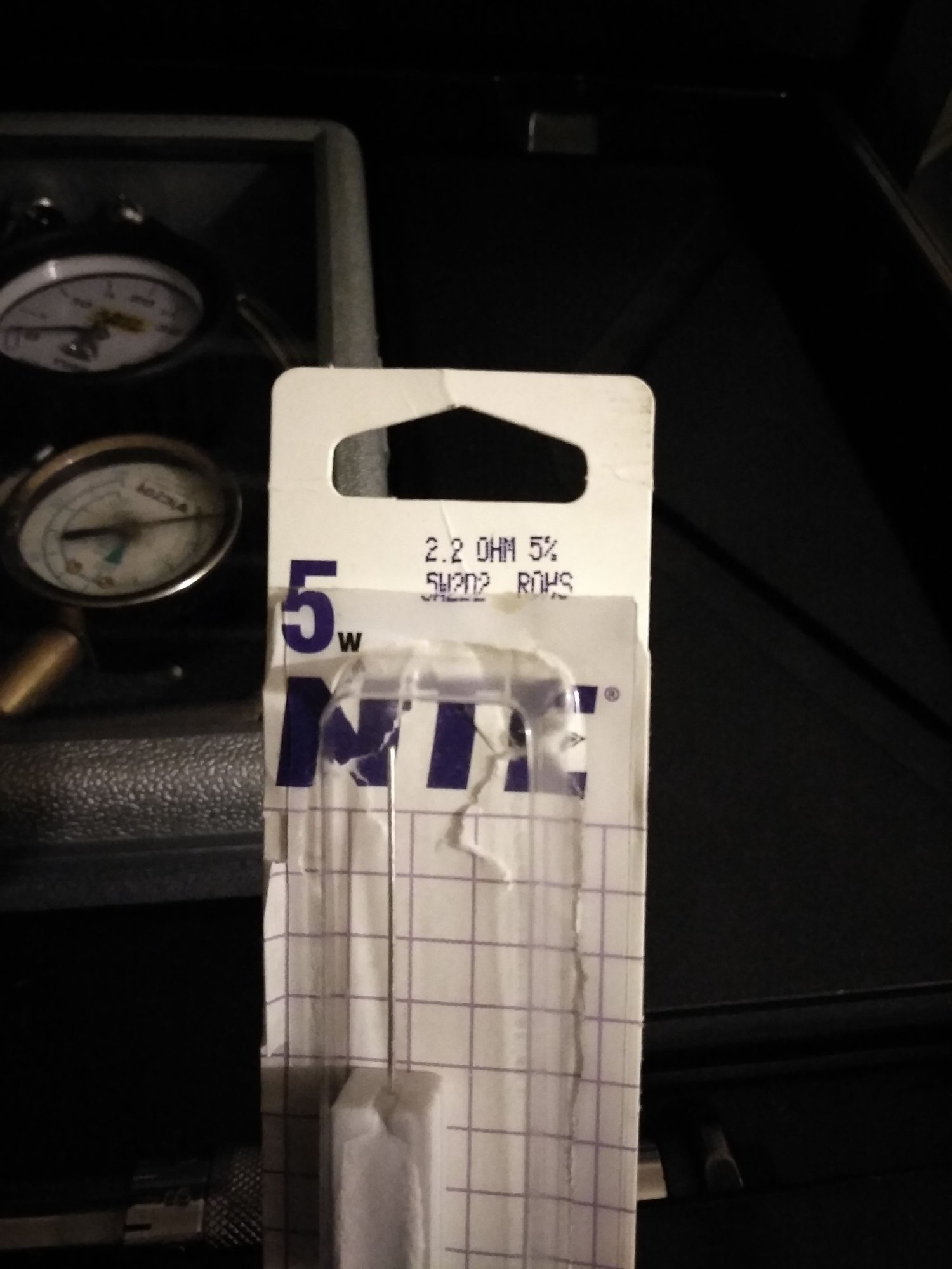

A 5 watt 2.2 ohm resistor is what I use. I just stick the leads into the wire harness where it plugs into the airbag and zip tie it up so it doesn't come loose.
