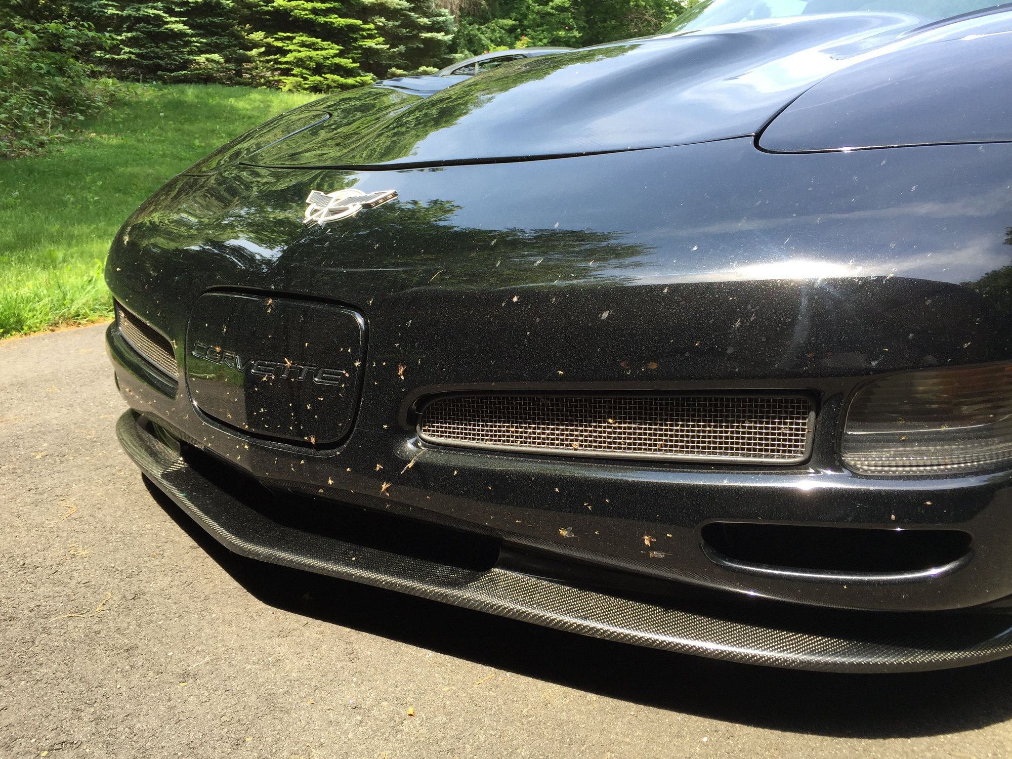

I have the Apsis splitter. Had it for five years and no cooling issues on-track or on the street. It is specifically designed for the C5 and is opened where the radiator feeds in air.

Originally Posted by rickw99vette
Where did you purchase it ? I like it, looks awesome.
Thanks, I got it from Apsisusa.com.

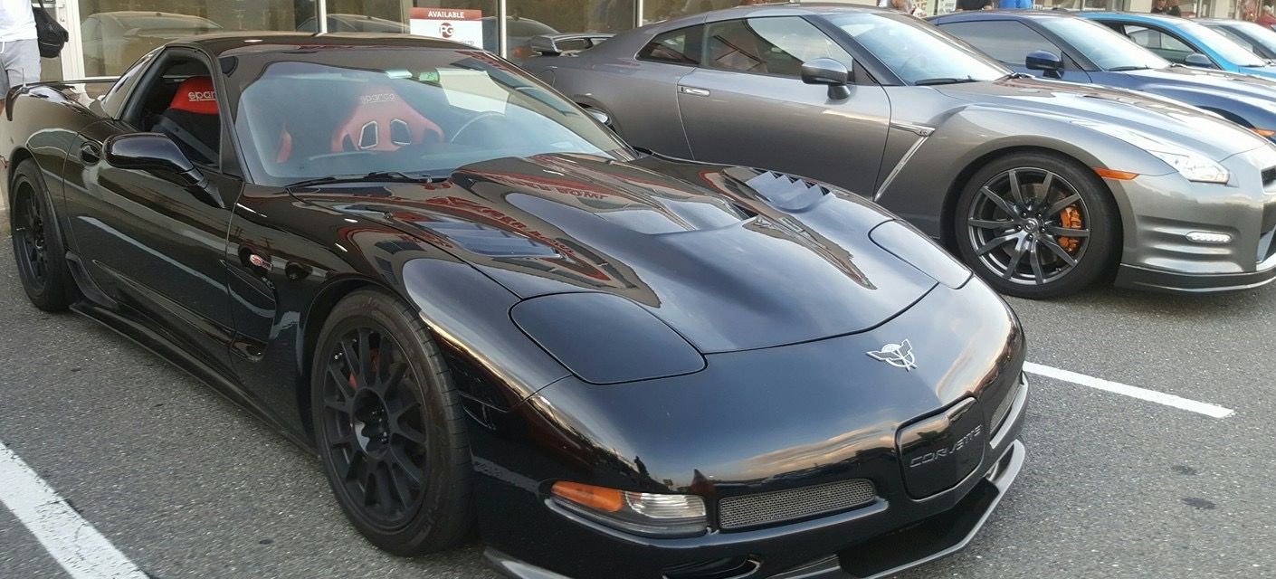

im lowered pretty good and I have zero cooling issues.
Just make sure your lower air dam is in place and you should be fine.
Very important tip, you'll remove the two side rubber air damn pieces, but you have leave the center one that's on the spring. Mean looking C5 too.

I have the Vortex lip and it's similar to the Apsis lip in that there's a center channel to allow air to flow directly to the radiator as originally intended. As a matter of fact I saw a slight decrease in temps because it's almost a straight shot to the rubber damn which is simply forcing air into the radiator.

I also have the Vortex; lost the side dams and trimmed the center dam 3/4" with no cooling issues whatsoever. It's the slimmest splitter that has a center vent, AFAIK.

c5r
