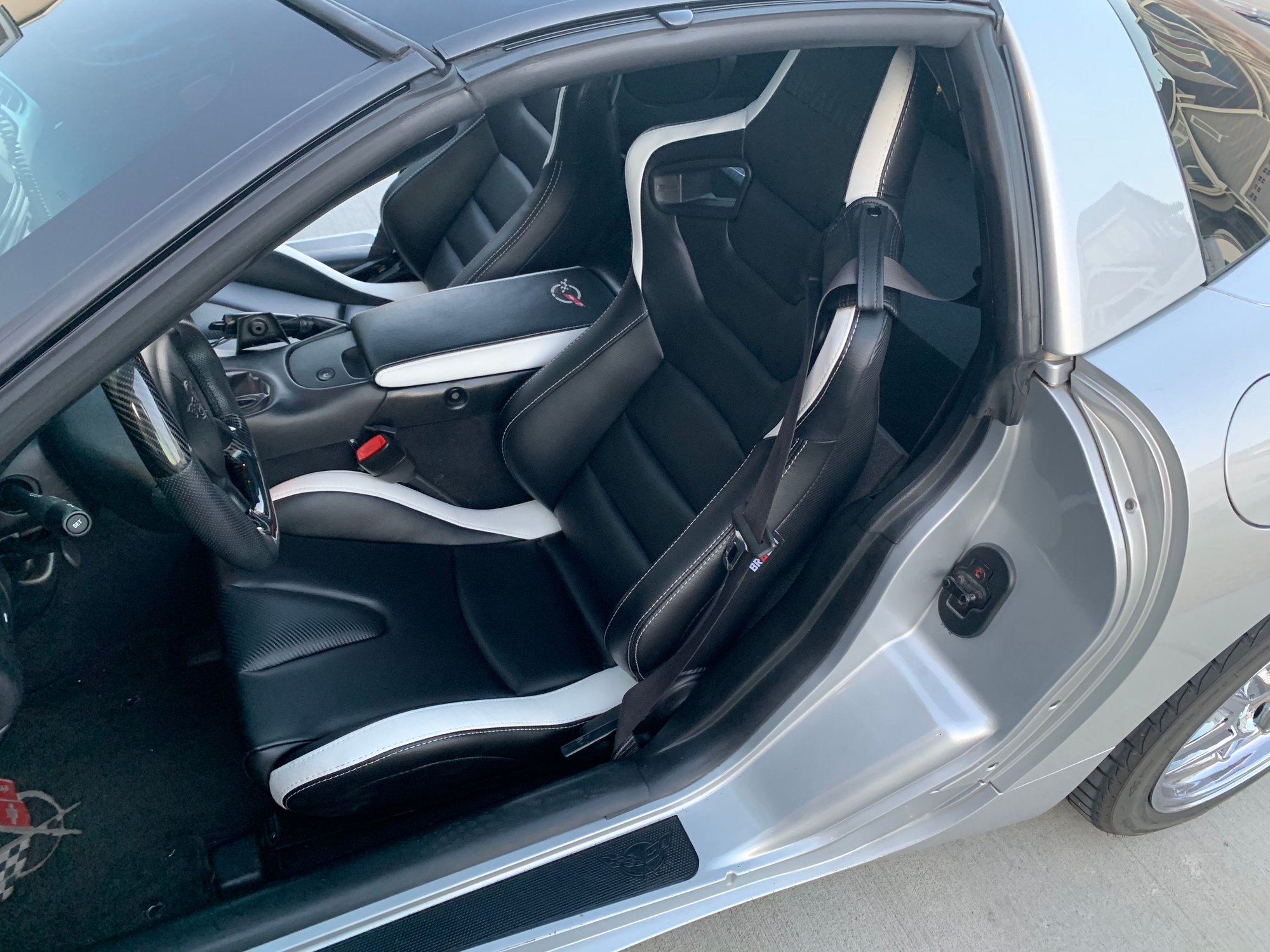

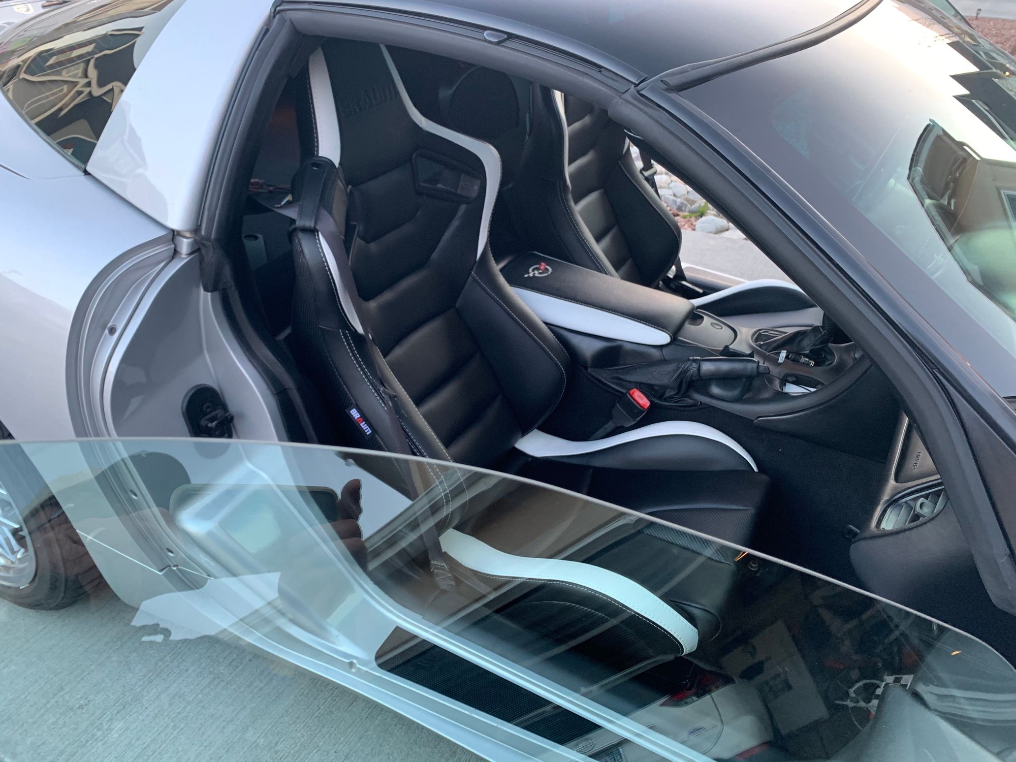

I used the 2010. My seats are the Braum elite recliners, I purchased some Braum seatbelt guides the are Velcro locked expand the pictures I previously posted the belts came from a stock 2010 c6 and we removed the bottom plastic cover from the lower belt mount.i attached the receiver to the eBay seat platform’s I used the stock c6 bolts that held it to the original seat.
ok. I misunderstood the earlier post.. i thought you had fixed back.. am sure the Elite and Advan seats are pretty much the same dims. so not a reason why the 2010 belts won t work i think... as for the guides. i like that.. they are on the Braum site and attach to any Braum seat ? ok i see how they attach.. go through the hole in the seat.. perfect.
do you have any pics of the belts where they bolt at the bottom please.

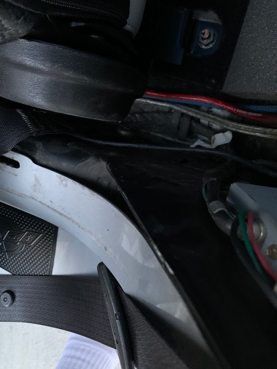

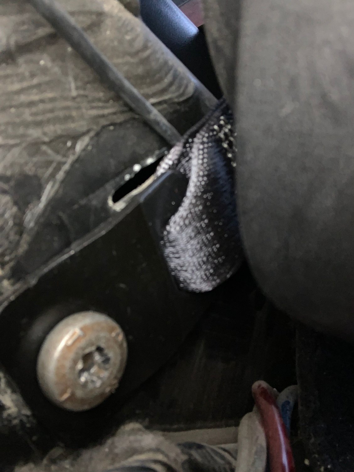

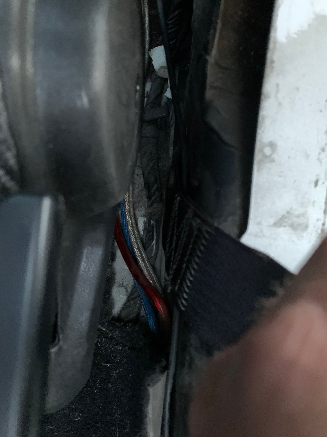

Using original C5 holes
Not an easy task to get the phone to take a good picture
I’ll take some, as I want switch sides, earlier in the thread someone stated to switch belt sides to make them roll out easier/smoother. Driver side belt use on passenger side and passenger side belt on the driver side.
