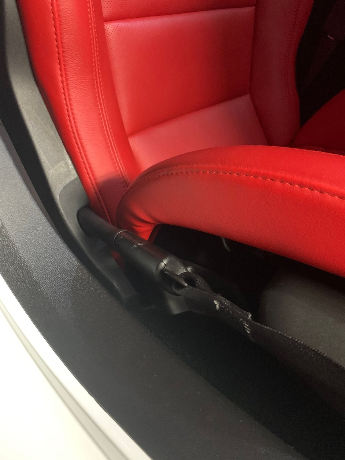

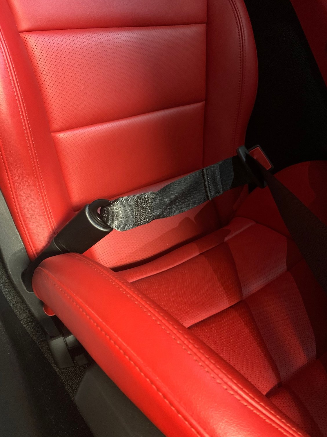

This is a great thread and really explains a lot as I'm in the process of installing a set of C7 GT seats into my C5 convertible. As a result, I have a few questions....
1.) Do you also need to also install C6 pretensioners to the C6 belts and connect them to the aftermarket seats, or in my case, C7 GT seats? Below is a pic from my C7Z with Comp Seats that show the driver side pretensioner on the outside part of the seat for the lap belt connection as I think the C7 seats are similar to the C6 seats. Do the C6 seat belts come with these pretensioners or do you have to buy them separately? Are they easy to connect to a C7 or aftermarket seat?
2.) Since I am installing new seat belts into a C5 convertible, should I opt for C6 convertible seat belts vs. C6 coupe seat belts. Are they the same length or are the coupe seat belts longer? Any specific year as I've been able to find some from a 2013 online.
3.) Do I also need to add C6 seat belt receivers near the tunnel or can I reuse either my C5 receivers or C7 receivers that are on the donor seats?

You will need to use the C6 seat belt receiver. The C6 buckle is a different size and shape VS the C5 buckle even though they look similar. The C7 receiver is also a bit different, the C5 buckle fits in but does not lock solid.
They will not lock together.
Gary
