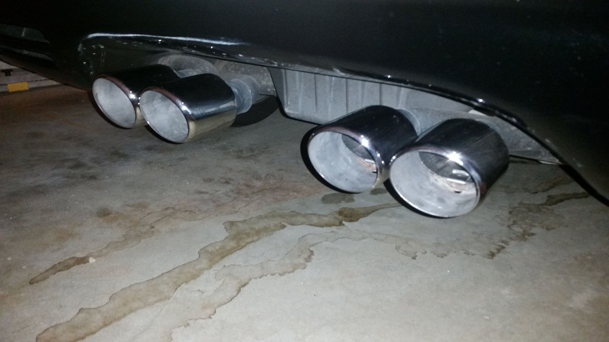

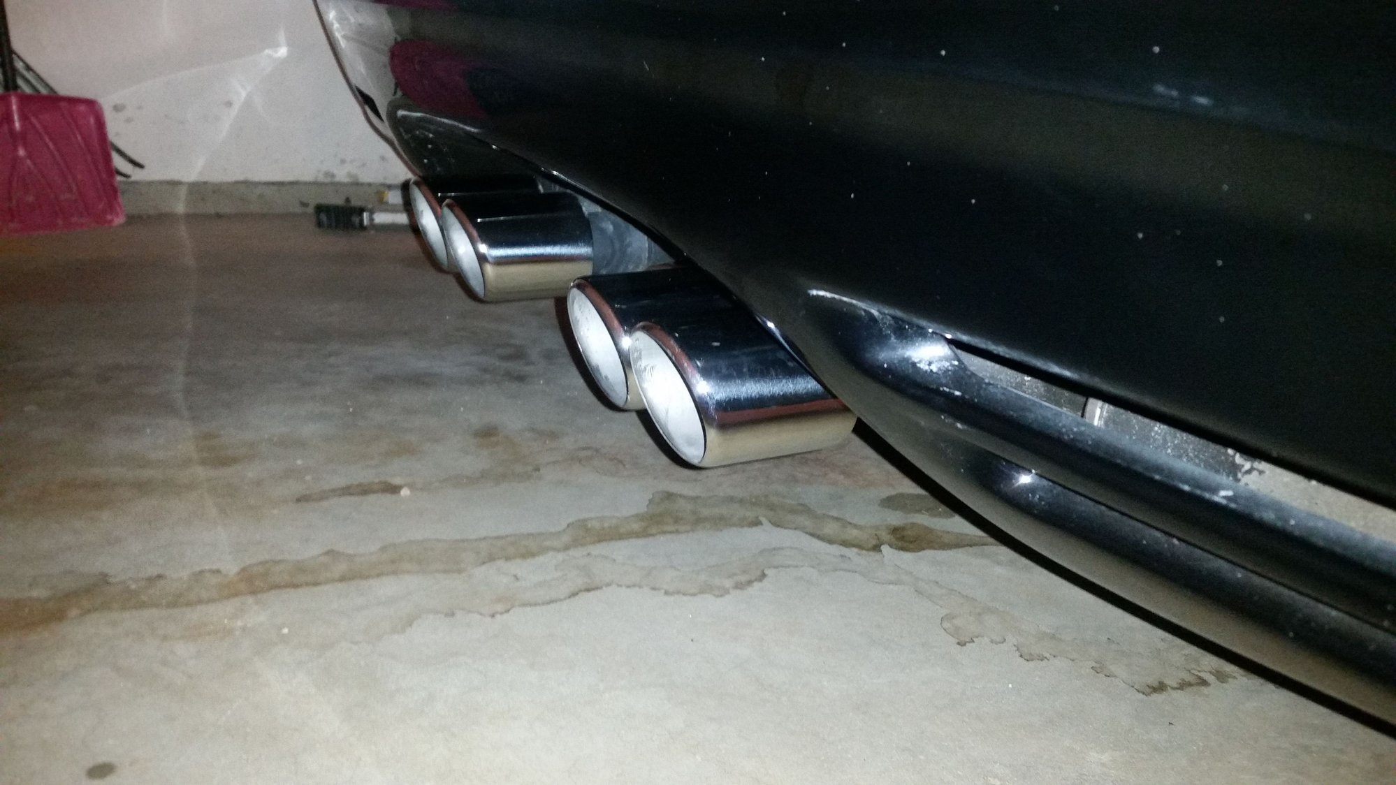

I put a set on my '99. They're just the "slip on" tips (Corsa) like posted above. I bought them from a member here. They have the clips as mentioned, and a set screw.
Corsa tips installed
100% better
FYI, they may be for sale soon. I'm in the process of trying to buy an axle back exhaust. When I do, I won't need these anymore.

FWIW, the tips in the link above are not OEM as the seller posted. They are the same tips I have (with the alignment clips and set screws to hold them against the OEM oval tips). Strictly for cosmetics, I think they do just fine. I hated the small, black oval tips and opted for these as a temp fix. I was worried at first about how'd they look, but once I installed them, I was happy. Granted, it's not show car quality, but I only needed to make ME happy.
