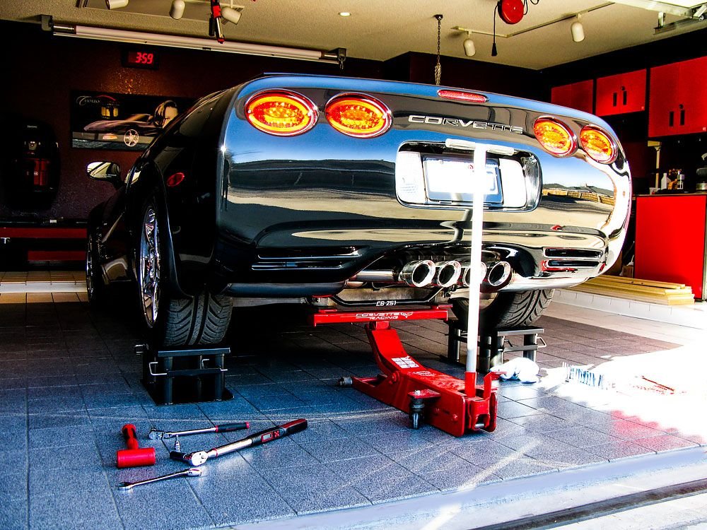

Question the weight of the jack, jack stands etc. does not crack the tile?
Originally Posted by Choreo
I used commercial-grade 8"x8" industrial tile for a non-skid surface. As long as you don't drop a heavy tool on it an crack one (has not happened yet in 15 years), no problems and very easy to keep clean. I did the whole garage myself in a long weekend at about $2,000 as I recall.

One additional question for you.
What are the stands under your tires? Brand, etc. They look like they will work good for me until I get a lift.
Thanks
Normally you would just need to etch the concrete by mopping with Muratic Acid and rinsing, but in my case it was a major pain because I used the floor epoxy paint a couple years earlier. Getting the epoxy off was one of the hardest jobs I ever tackled!
No. Think about it... less than 1,000-lbs per corner. there are several square inches of contact area with the floor - even if the weight were concentrated over 4 square inches, it would be like me standing on a bottle cap with one leg! In reality is is far less per square inch, but I do put down heavy rubber mats when I use the Kwik Lift to be on the safe side.
I have jacked my C5 up probably 100 times with various jacking methods - never damaged a tile.
Thanks
MyLiftStand. They go up twice as high as what you see in the photo. They are sold in pairs and I bought 2 sets...

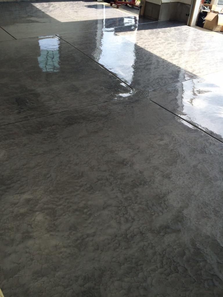

The Day the epoxy was finished
Looks Great! I really like professionally installed and textured epoxy floors.
Originally Posted by 91LSMAN
It needed, I believe 24 hours. They gave it more time than that though, just in case.
I don't know the exact cost-everyone's will be different. This guy included taking the old floor, cleaning the concrete, etc. etc.
The key to epoxy is preparation. Most residential garage floors need to be roughed up first using a diamond tip to allow the epoxy to have something to grab onto.

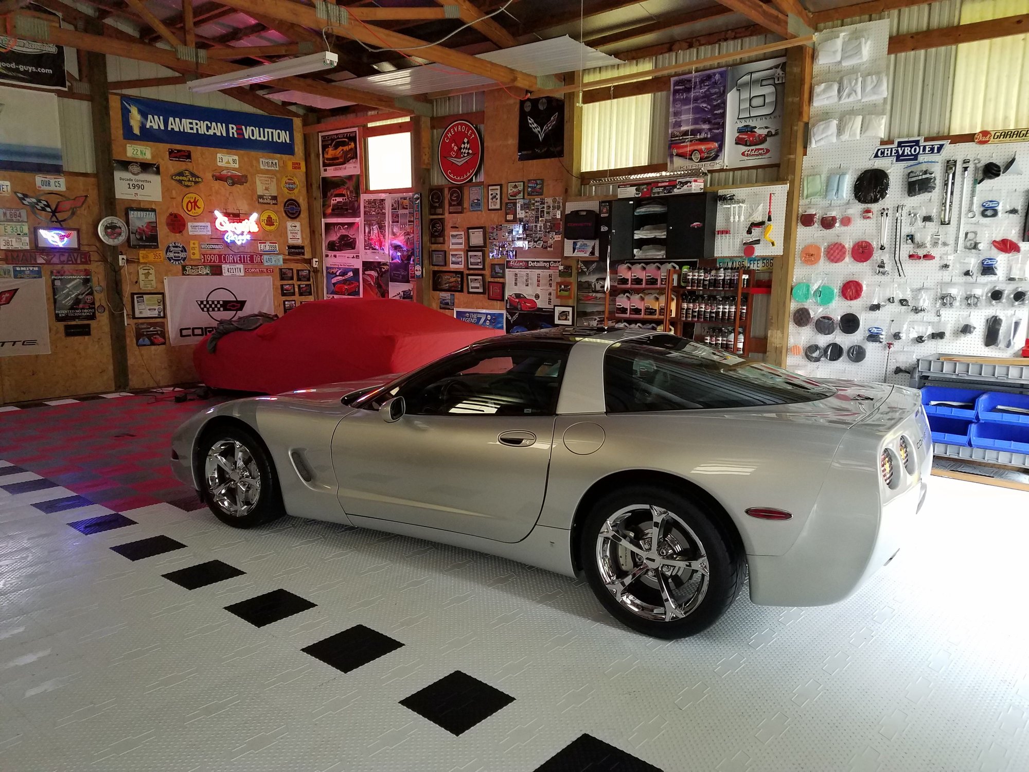

Any chance you still have the contact info email or phone number for the guy that sold those tiles to you? They are perfect!
If so you can PM me with the info.
Thanks,
Originally Posted by Keev1414
Mine is edge garage gear. Snap together with ez. Got lucky found a guy selling tiles on craigslist for a 1.00 a tile. Went with black, red ,gray and white. Hides any cracks in he floor. Did all myself. But a partner would be super helpful!!!

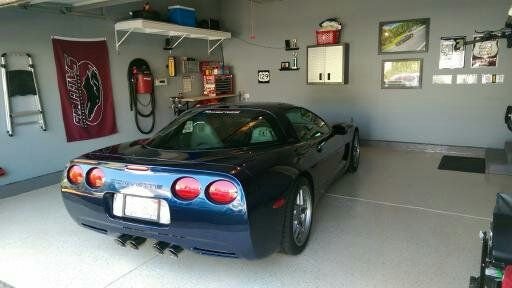

I used Sherwin Williams epoxy system. It took two boxes and cost about $150 when it was all said and done. There are much nicer epoxies out there, but I was on a tight budget and it worked for me. I have no complaints and would do it again. The only thing I wish I did was fill in the cracks so it looks like 1 pieces of concrete. It's been 3 years and nothing has peeled up, but some of it is discolored from automotive fluids from the work I have done on different cars.

Looks nice. Great job on the budget.
As to the expansion joints... You need those. That is where the concrete is designed to break once your house settles... And it will settle. If you were to fill them, the cracking would still occur there, you would just be left with concrete chips coming out and no epoxy underneath...

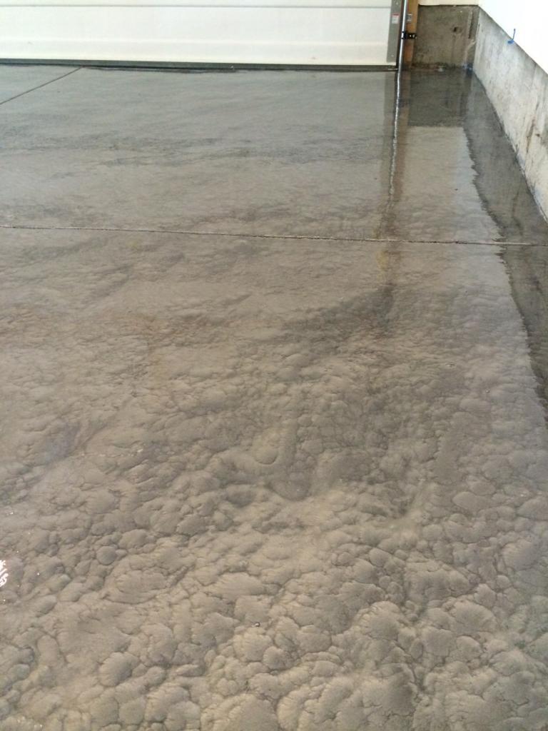

I used Pure Metallic Epoxy on my garage floor. 2+ years later (plenty of road salt too) and it still looks fantastic.
