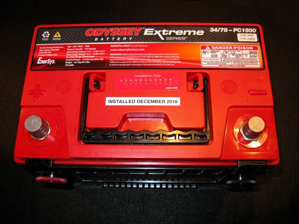

You definitely want an AGM battery.
You'll get a million responses on here about the best battery. I'd say go with either a Sears Diehard Gold AGM (about $170 or so) or if you really want to go all out for the absolute best, get an Odyssey for $250 or so.
Seems like a lot of Corvette owners here have had a lot of issues with the Optima batteries.

I like the Odyssey personally ($$$)...
