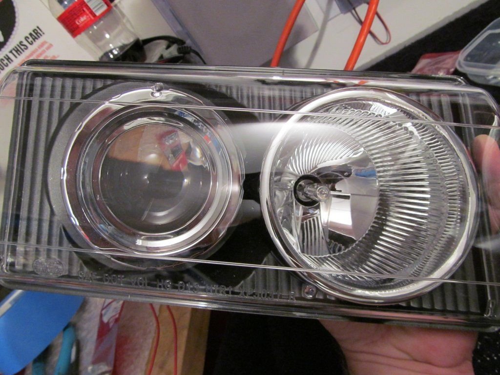

I'm almost certain you purchased the wrong ones. I looked into this when I did mine. There are two types of ACA repros on eBay, the most common and cheaper one cannot be taken apart without breaking it. I tried baking and everything. The actual ACA repros that can occasionally be found on eBay and is seen in Torque's write up as well as Radioflyer's use can be opened easily. I did not need to heat them, just remove the screws.
The correct lights say ACA in the bottom corner of the clear plastic on the front. If yours do not say this, return them. It is not possible to do a retrofit on those, I tried. The non-ACA repros come in several colors, chrome/black/halo/no halo.
Here is a picture of the correct ones, you can see the ACA on the bottom left next to SAE DOT:
