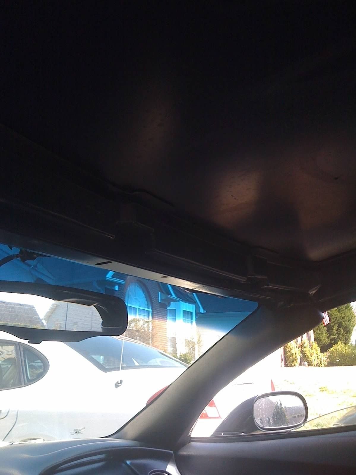

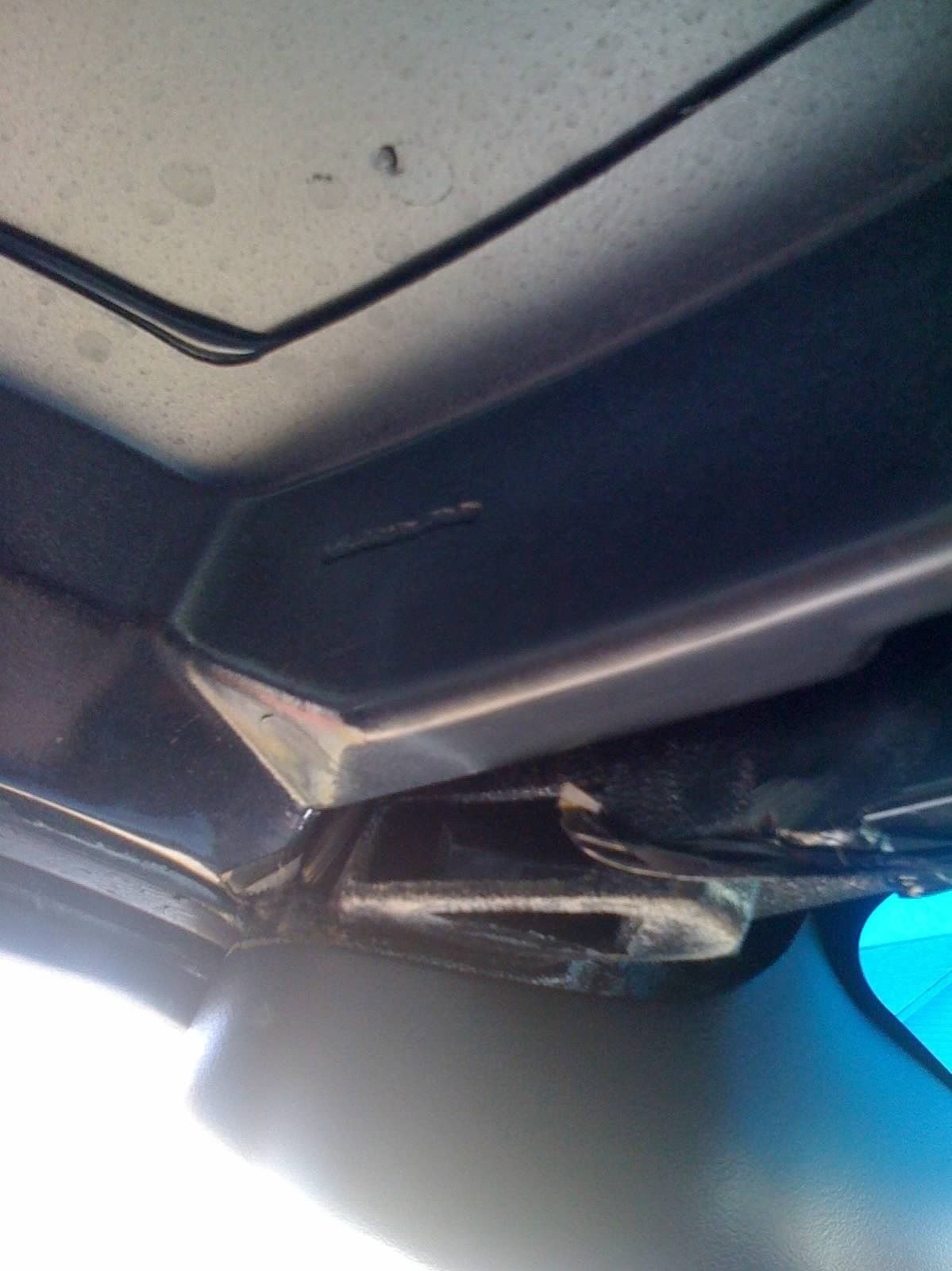

Fixed Roof Coupes (and by default, z06s) have a headliner not being made anymore. The only place is a junkyard.
Common thread theme is FRC water leakage causing (in the worst cases) headliner damage. I took pictures and posted of a z06 with no liner due to water damage many years back.

Found the pics of a z06 with no headliner.
