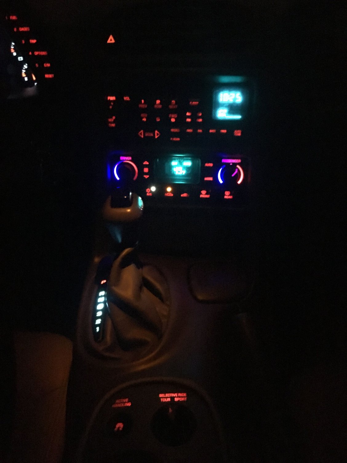

Originally Posted by Rob 02
Lets see them!
Red LEDs to match my AE. I like it ... a lot!
That looks like a lot of work getting the LED's in there and finding the right polarity.
It was a lot of work, especially the DIC/HUD, Radio, and HVAC. But totally worth it.
