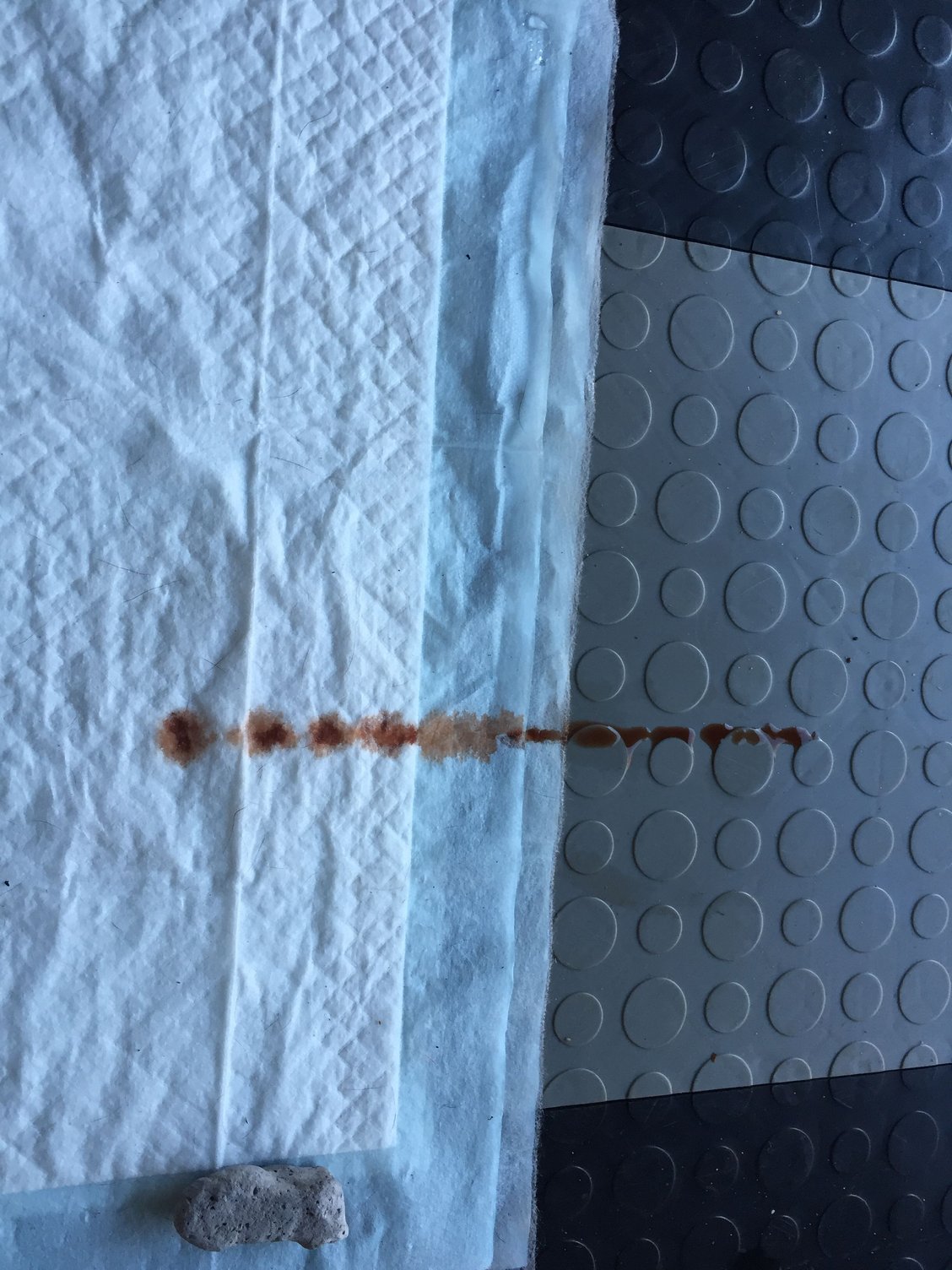

I have a 1998 and just got new transmission gasket filter and new fluids the reason why was I had a leak when I started car and when going in revers out of garage there would be line of transmission fluid but know the same thing is happening can someone help me on what it could be

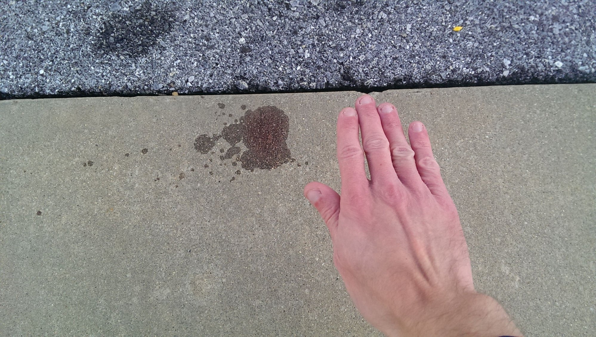

A shop inspected my trans. fluid level and condition in the fall at my request (since the last time it was checked that I'm aware of is 2010--when a Chevy dealer replaced trans. fluid per the CarFax). For the next 5-6 start-ups before I garaged the car for the winter, a few drops (maybe a half tablespoon?) of trans fluid would drip on the concrete, but after the initial drip each time, it would "hold". I've started it up in the garage 5-6 times this winter without moving it and didn't notice any dripping. Talked with my Corvette shop and they said lots of C5s develop seal issues causing trans. fluid leaks. It may be that...? I'm taking mine to be repaired soon.

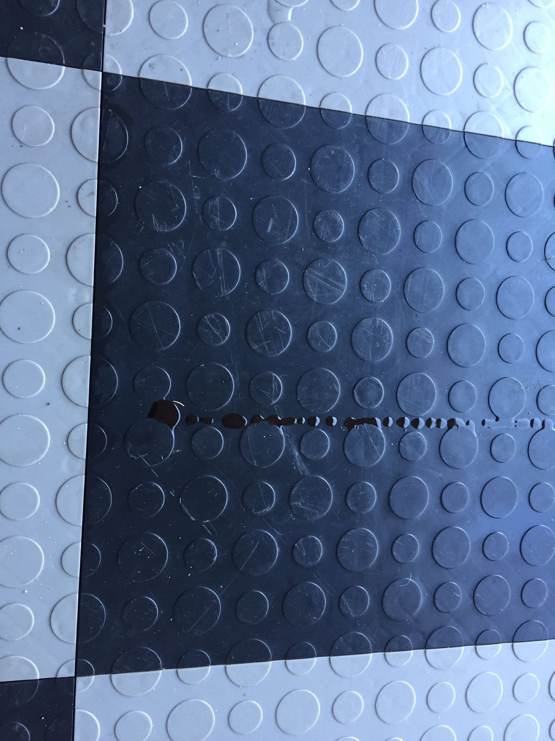

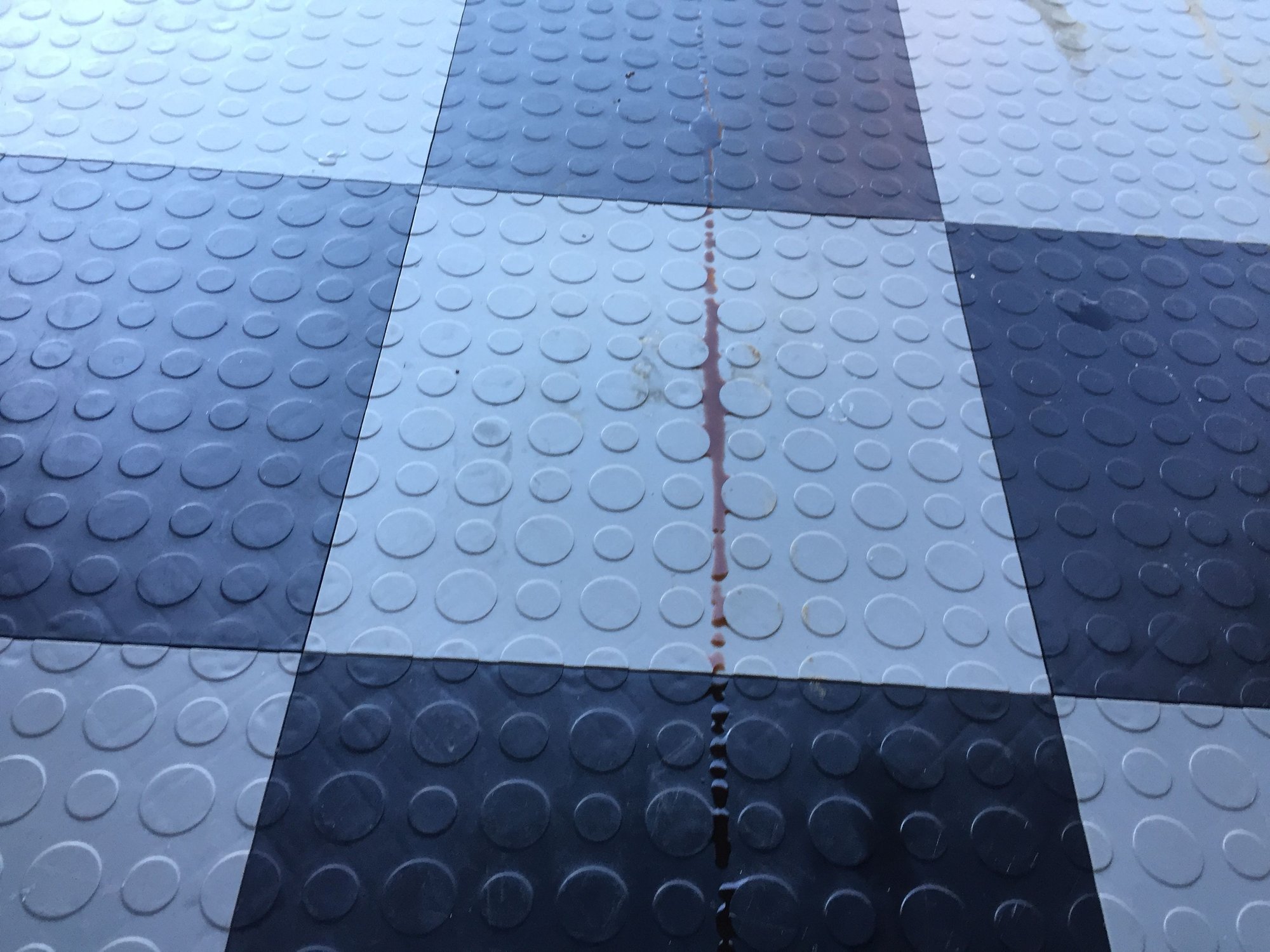

Default Leak pictures
Yesterday leak nothing today wtf

Looks kinda like what I had, but like said before, just watch it to the best as possible. Maybe even get under it yourself and clean it up and look around.

yours was in a straight line two did you have days were it didn't leak then next day it did

Mine had a puddle and had a few lines, but weren't that long, and also I couldn't account for it everyday due to it being the race car in the family lol
